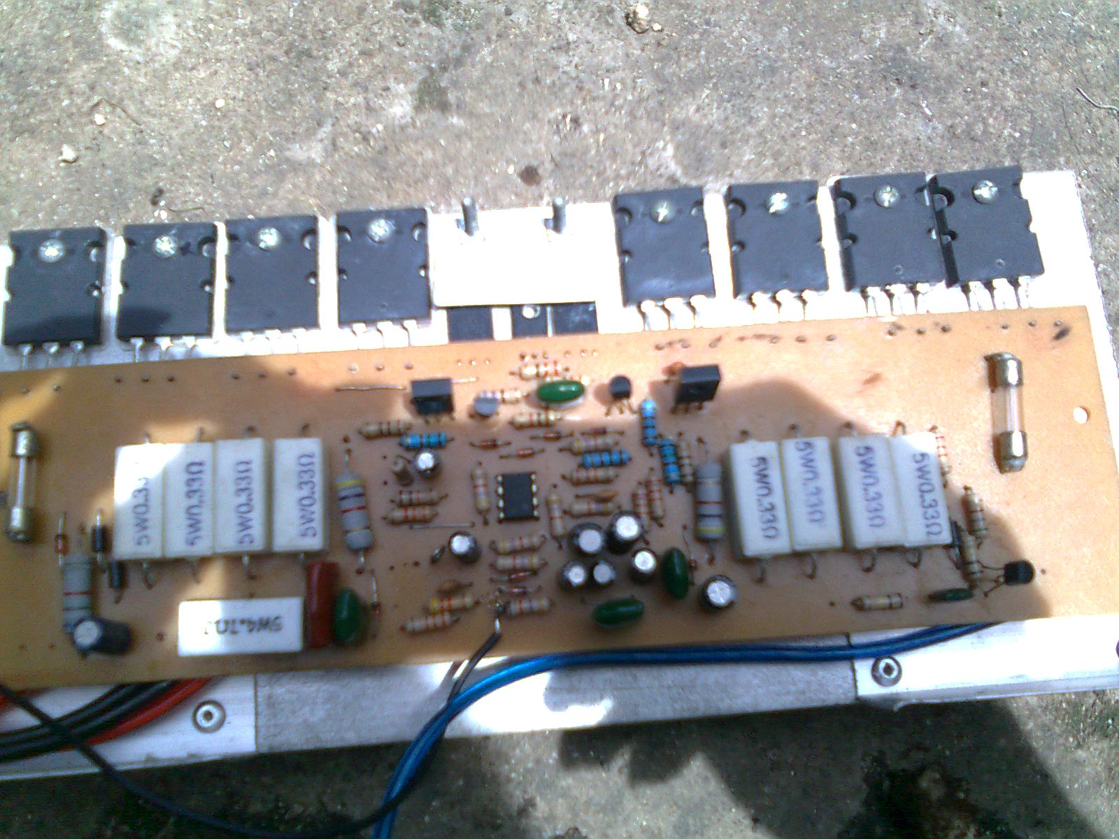

sir...
today i replaced op amp NE5532 with new one and zeners too...
i've checked 2n5401 2n5551 mje340 mje350 c4793 and a1837 they were all fine...
dc is still present at the output...
still power turn themselves hot in less than a minute...
Dc output
@ Ees,
Hi friend, you may need to test your module with a lower voltage and current, not the 25A. Getting hot output trannies usually indicates high bias current. Something should be wrong in the circuit.
Have you matched those outputs? Though not always a big deal, but it always helps maintain a well balanced transistor function.

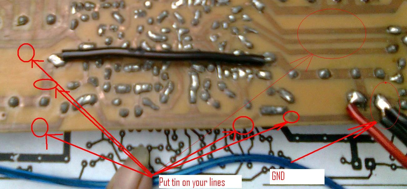

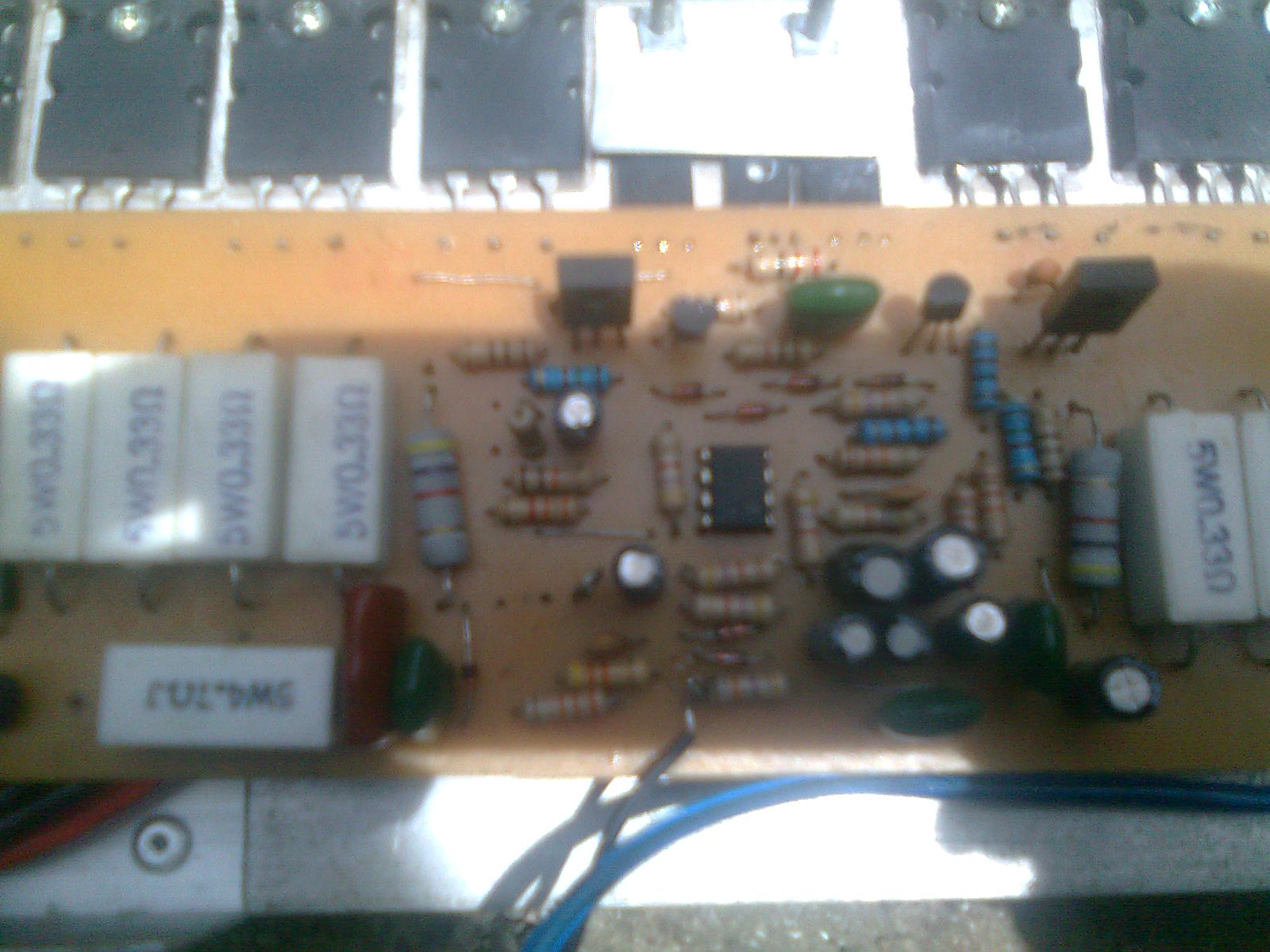

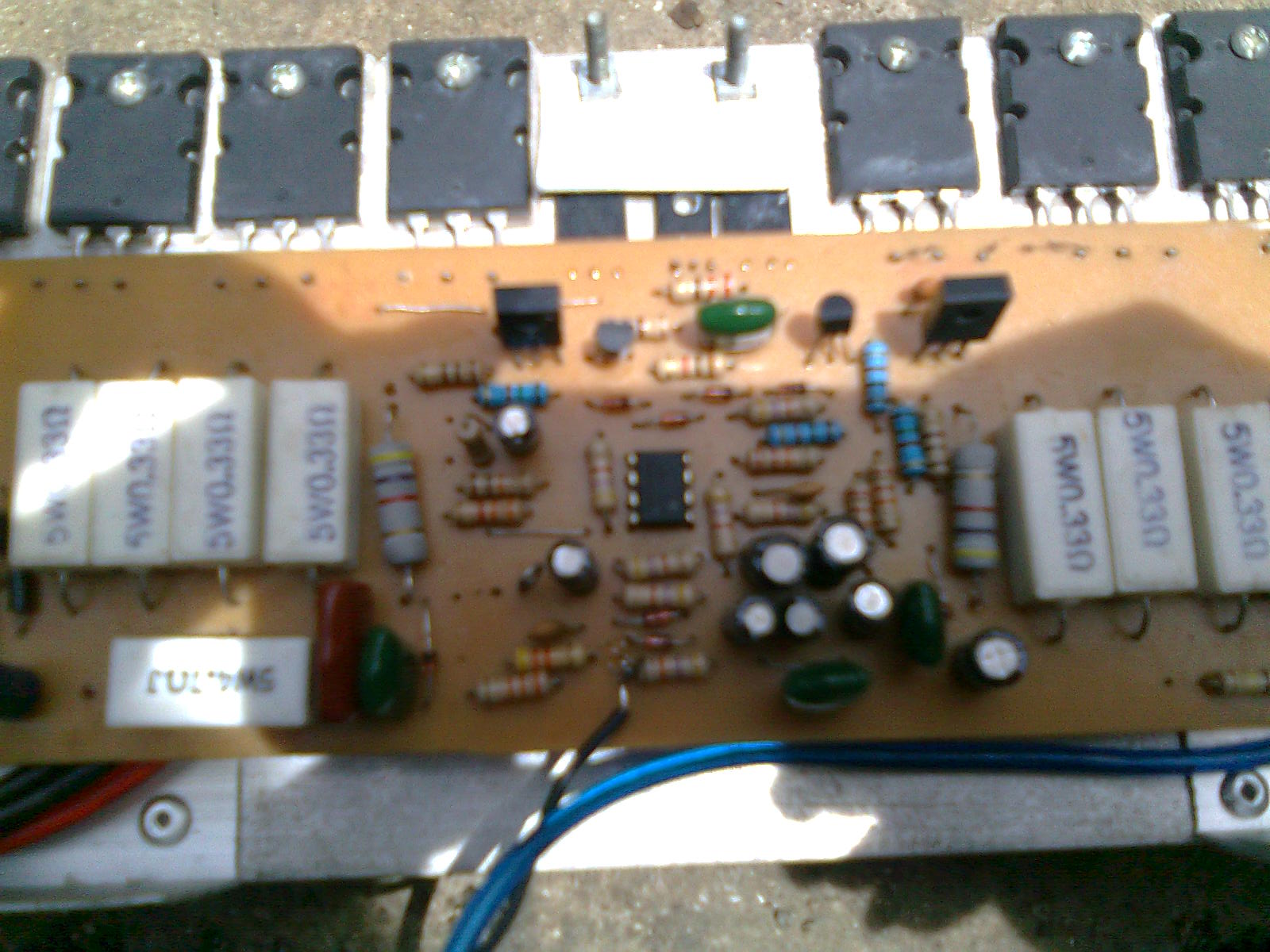

Can you zoom this area, I can't see clear, but I think you have mistake on your PCB.i took pics this morning
i used my fon to capture images
i guess its not that clear...
Regards
Regards
im very very sorry for unclear pics...
i hope this would help...

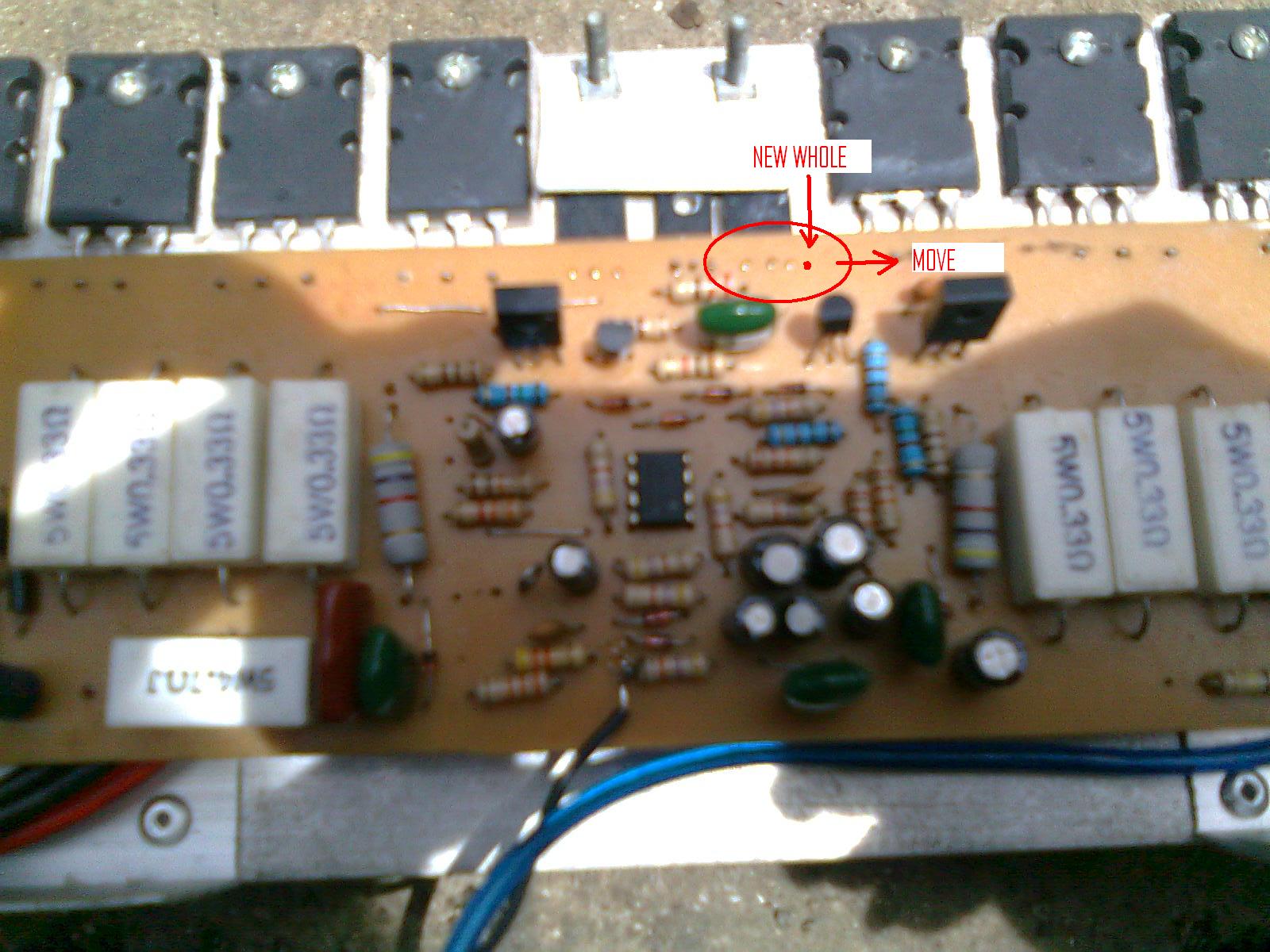

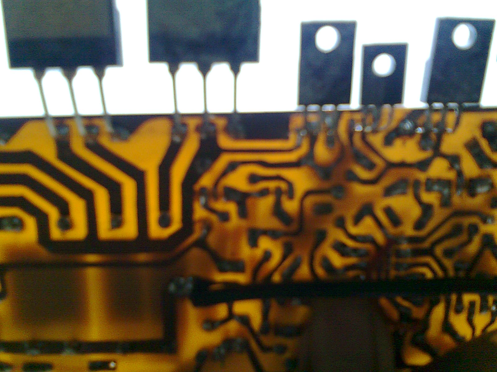

On your PCB emiter 2SA1837 is connect to colector 2SA1943... Your 2SA1837 is on wrong position, you must move it 2,5mm, and then emiter 2SA1837 will be connect to base 2SA1943,im very very sorry for unclear pics...
