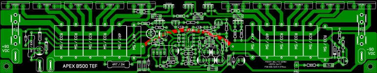

Mr. Mile,

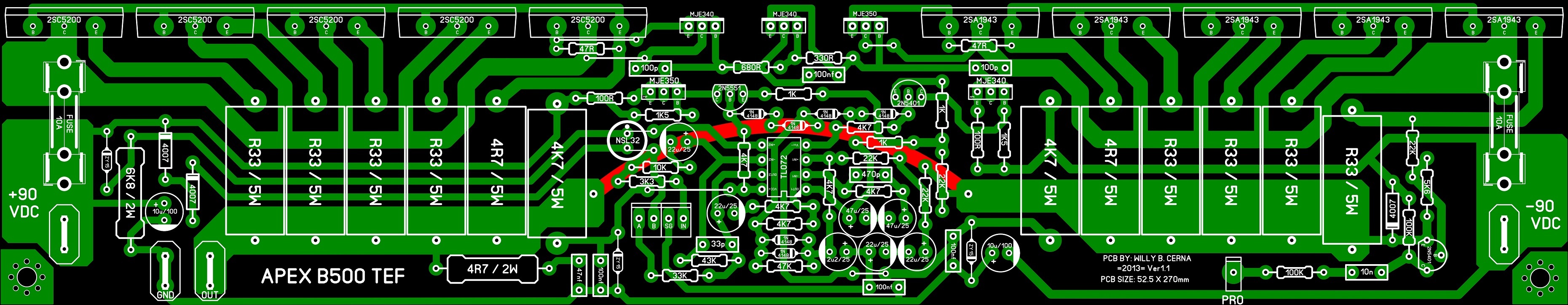

I'm planning to upgrade my B500 to TEF, is this correct?

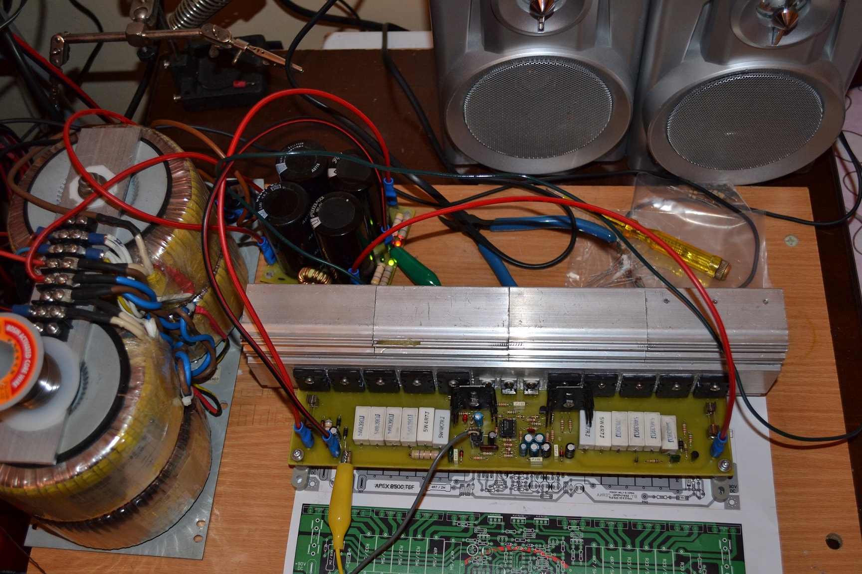

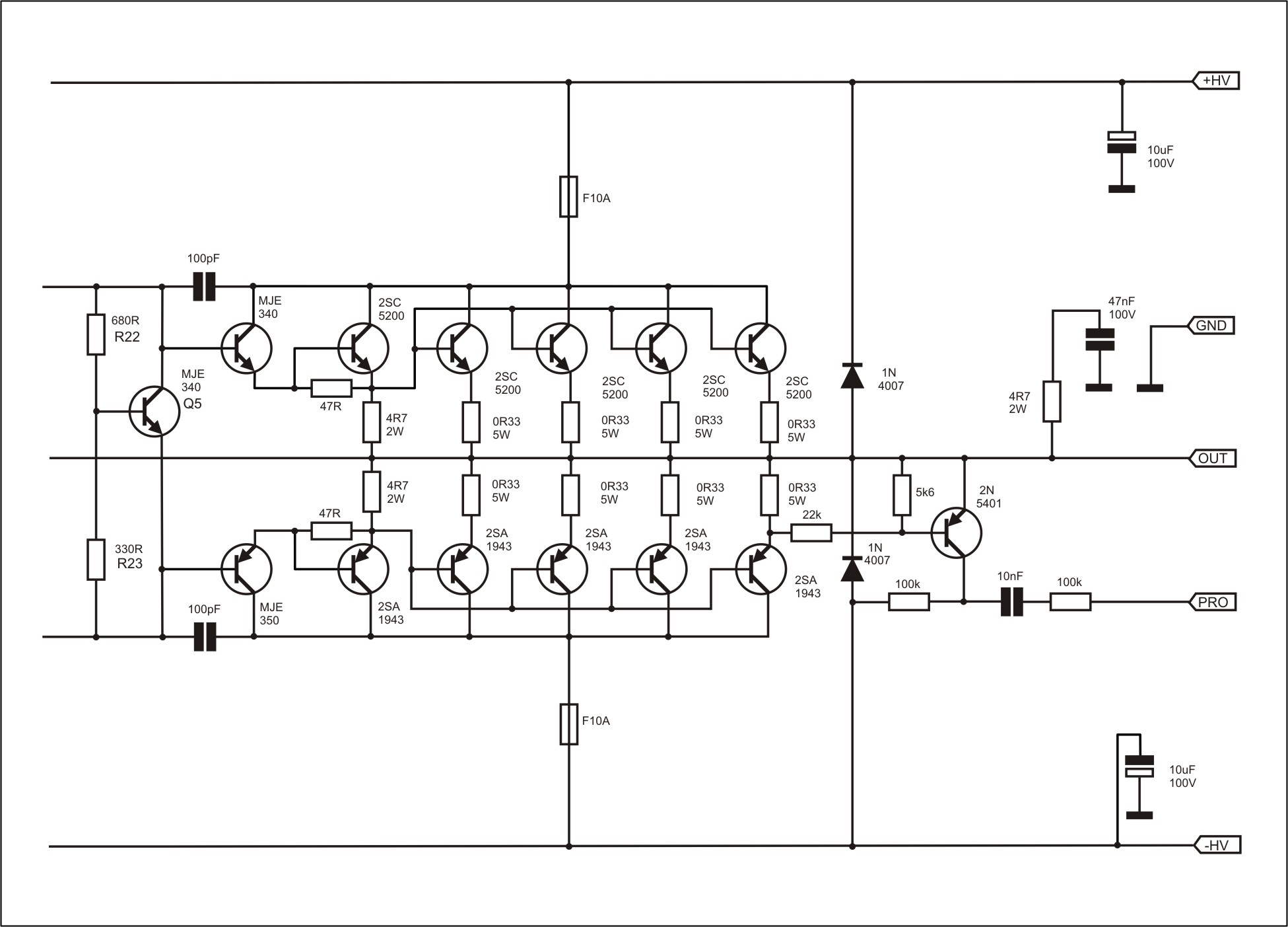

B500 4 pair Darlington output stage

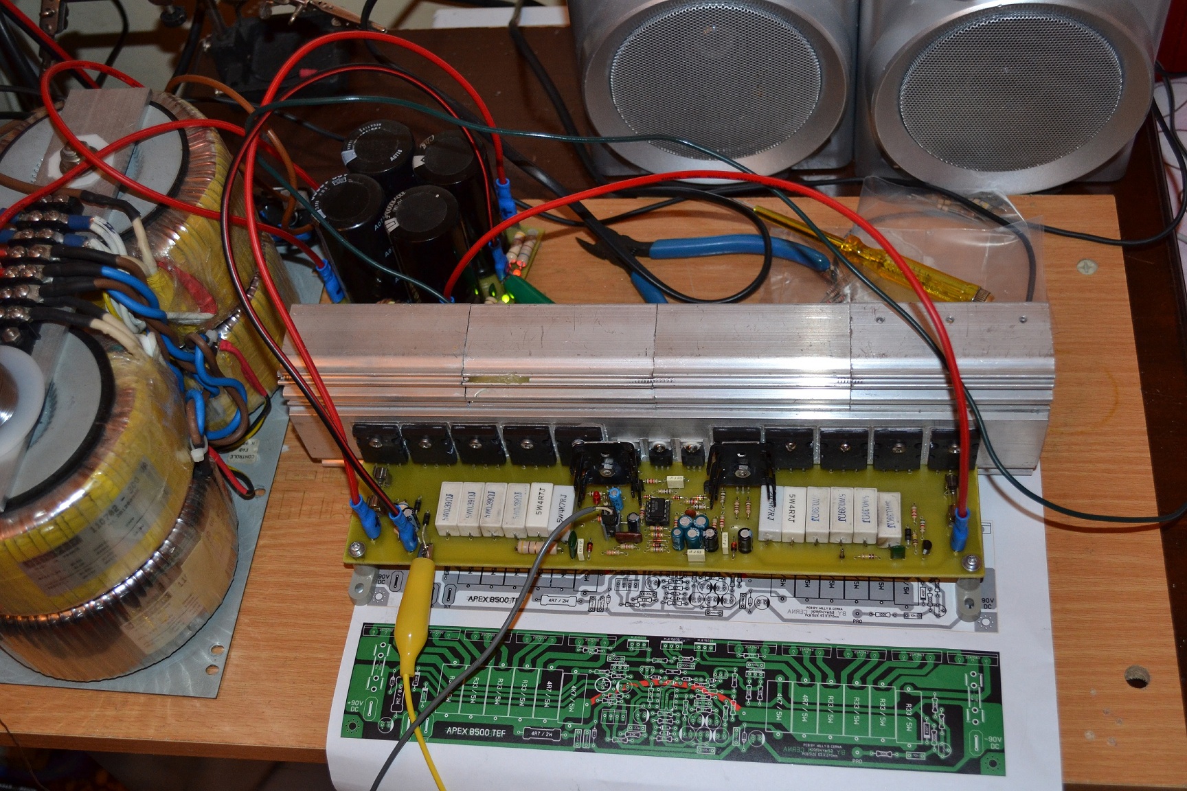

It's working....:D very nice....
Thanks again Mr. Mile....
BTW what would be the max power could achieved with 4 pair of darlington output stage with +/-78VDC rail voltage?

congratulations
congratulations. excellent work. It's really impressive professional finish B-500 amp.
A query such heat sinks are computadpras.
PS: Please could you upload the pcb in Sprin Layout.

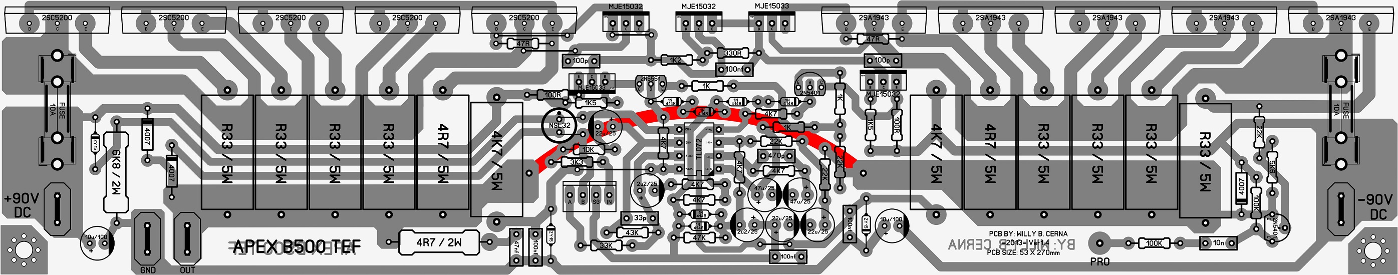

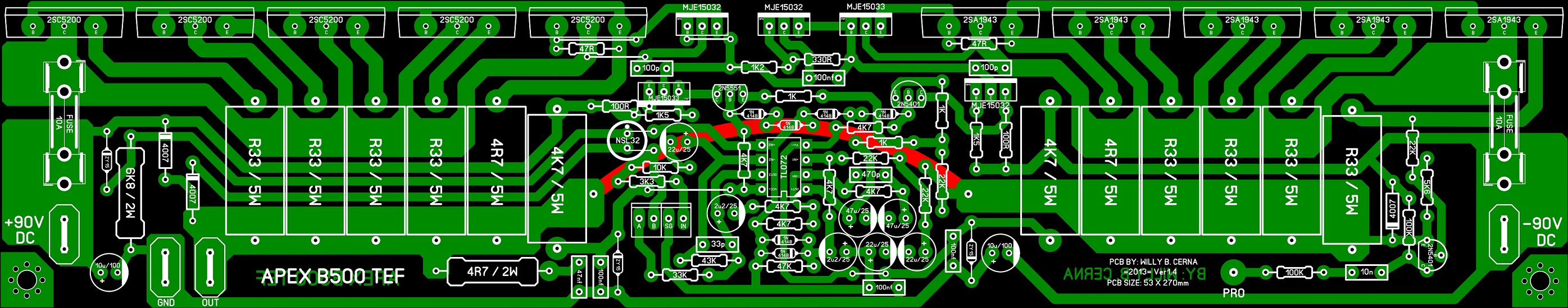

Thanks, here's the files.
  • APEX B500 4 Pair Darlington Ver.1.4 Gray.pdf
  • APEX B500 4 Pair Darlington Ver.1.4 PCB Mirror.pdf
  • APEX B500 4 Pair Darlington Ver.1.4 PCB.pdf
yes , working very nice

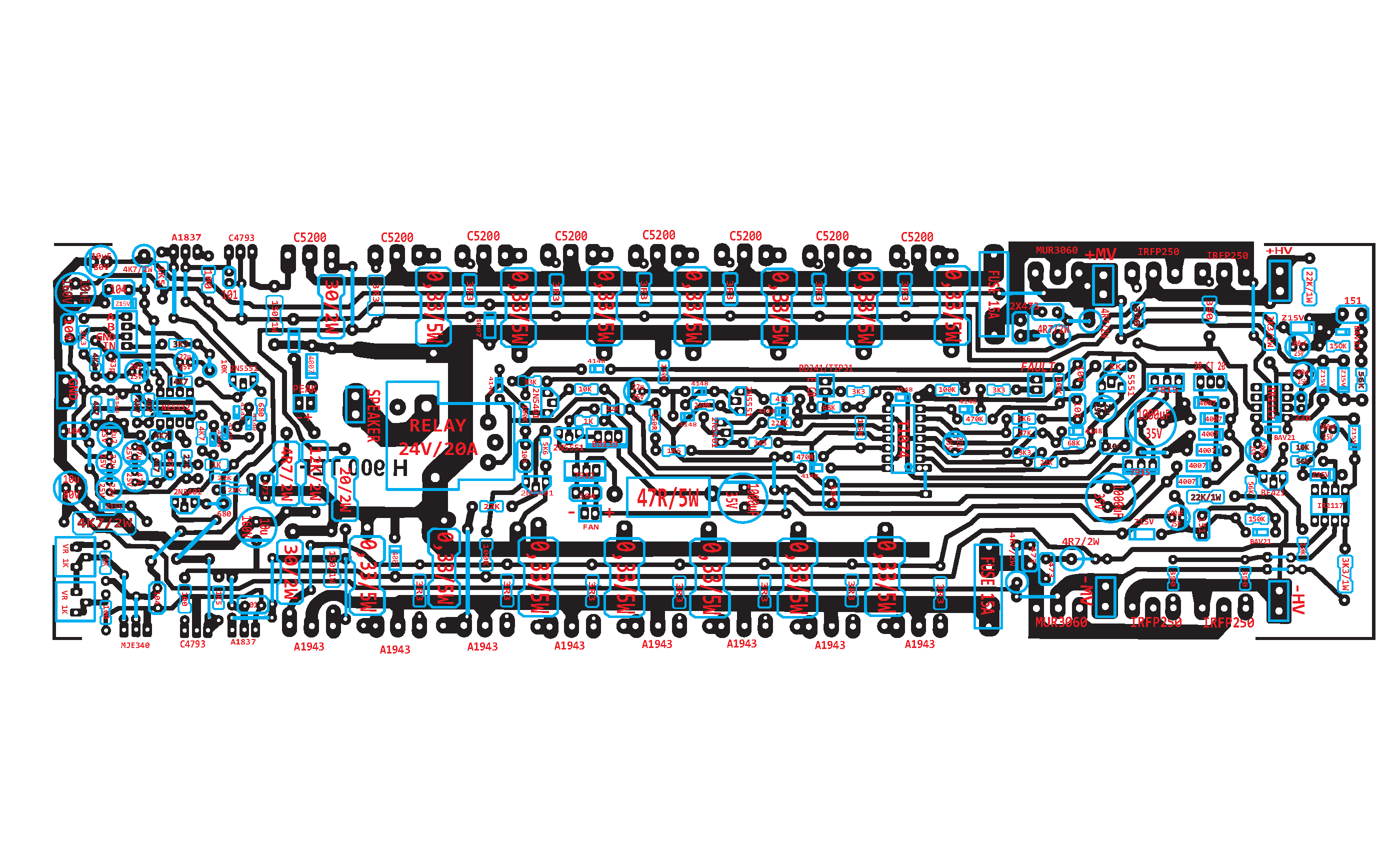

Hello LIEM POO...Greetings ..:) I have repositioned the tranies of this PCB to adopt to my Heat sink... Kindly check for any errors.
Hello Sir APEX... hope you can also give suggestion for the parts if something need to be improved. If all is well ... I can start making the PCB for this.
Many thanks to ALL
Best Regards
