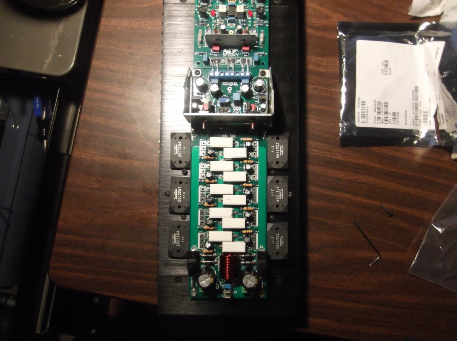

500 Watts RMS in 4 Ohm amplifier
If you could Provide a PCB of your Amp It world be a good start for me,Because your amplifier seems nice.
And What about the Apex B500,It doesn't supplies 500 Watts Rms?
B500 might do 500w , but the risk of driver failure / output SOA failure is high.
That posted "big transistor" MT-200 amp would totally outclass the B500 ,
both in safety/quality ..... and the ability to do a "true" 500W.
Hah , B500 is "chip" amp !! :eek:
PS - first post of my thread has all the toner artwork listed by post (zip files).
