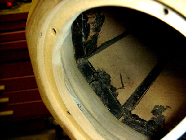

I go along with mwmkravchenko's idea, I have done a DIY using a similar technique with very satisfying results. Two layers of 3/4 MDF with a Tar Slurry in-between (roof patch tar from Home Depot), the inside staves were only affixed with the tar, so their are not rigidly coupled to the outer enclosure, then another layer of Tar on the inside. That only takes care of part of the problem though; IMO the Midrange is the area where this is most important for clean micro-dynamics. A egg shape is the best, but a tapered design IMO works just as well.
kingdaddy said:I go along with mwmkravchenko's idea, I have done a DIY using a similar technique with very satisfying results. Two layers of 3/4 MDF with a Tar Slurry in-between (roof patch tar from Home Depot), the inside staves were only affixed with the tar, so their are not rigidly coupled to the outer enclosure, then another layer of Tar on the inside. That only takes care of part of the problem though; IMO the Midrange is the area where this is most important for clean micro-dynamics. A egg shape is the best, but a tapered design IMO works just as well.
I have a couple of questions:
1. Why did you choose tar?
2. What is best about an egg shape?
I'm intrigued about your comments on midrange and micro-dynamics. What strategy do you suggest to get the best midrange. Would you consider totally absorbing the rear wave within the enclosure to be the best approach?
It seems to me that if midrange accuracy is the goal, then the backwave should be absorbed within the box, so the box should be rigid and a lot of stuffing used, so that the rear wave is all absorbed and the minimum is transmitted through the walls and cone.
regards,
Paul
Because it has an irreguler shape when cured and it's very dense, it also penetrates into the wood (oil based) changing the overall resonance of the MDF.
An Ovoid is the perfect geometric shape for standing waves, no parallel surfaces. However a sphere can do as well as long as there isn't significant pressure form the driver. If you put a ball of poly-fill in a net and suspend it in the middle of a sphere it will do a close version to a Egg shape interior. The Egg shape exterior is also a near perfect acoustical shape for diffraction, so overall IMO the egg shape is the best for midrange.
In-addition Yes, I do believe that totally reducing the back-wave pressure will increase Micro-Dynamics, I like tapered polygons, spherical, cylindrical, and nautilus shaped enclosures for all but the very low’s. Anything but a BOX!
