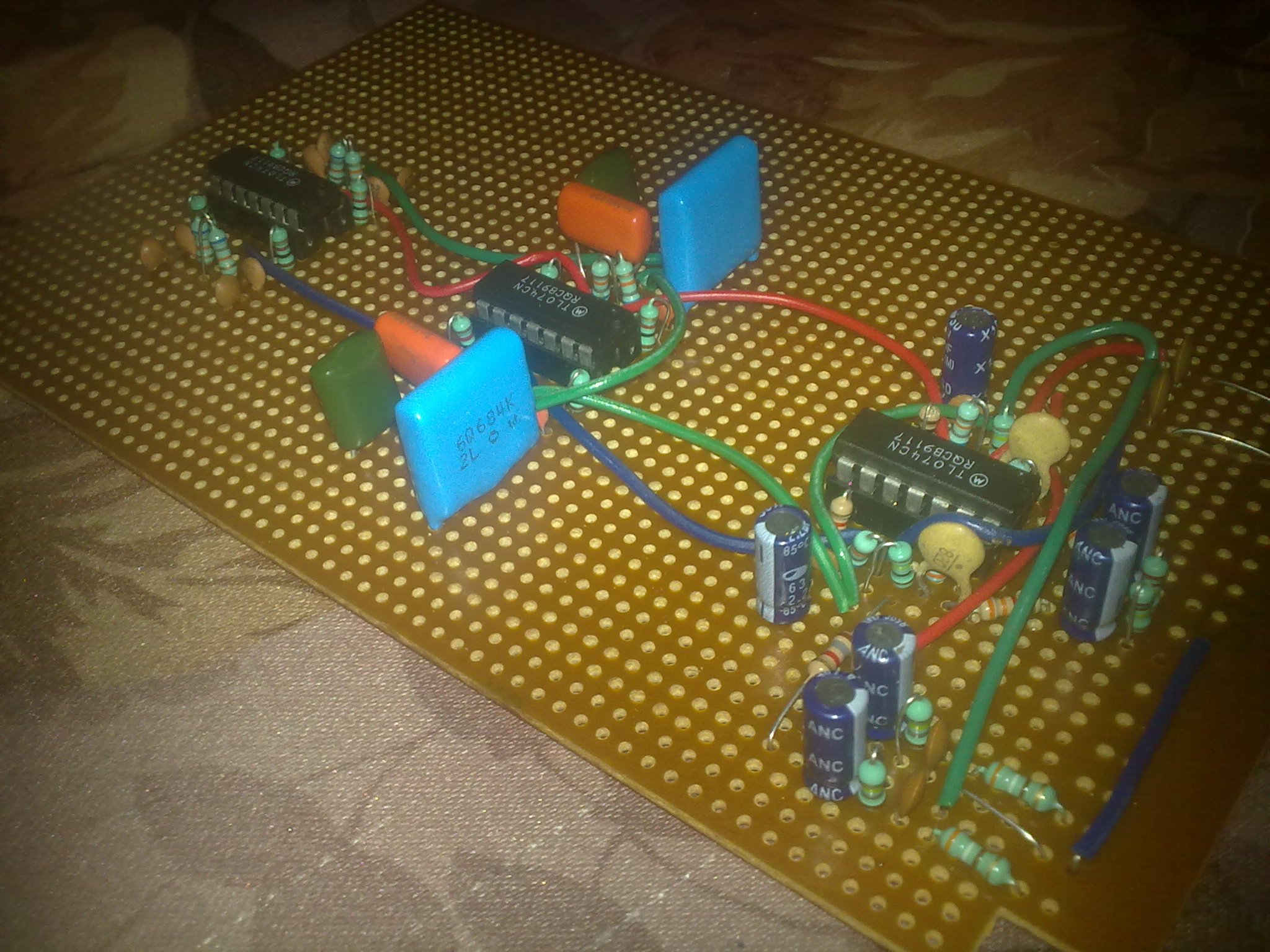

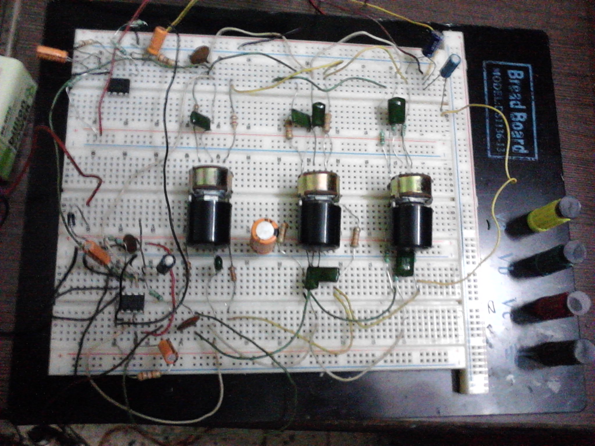

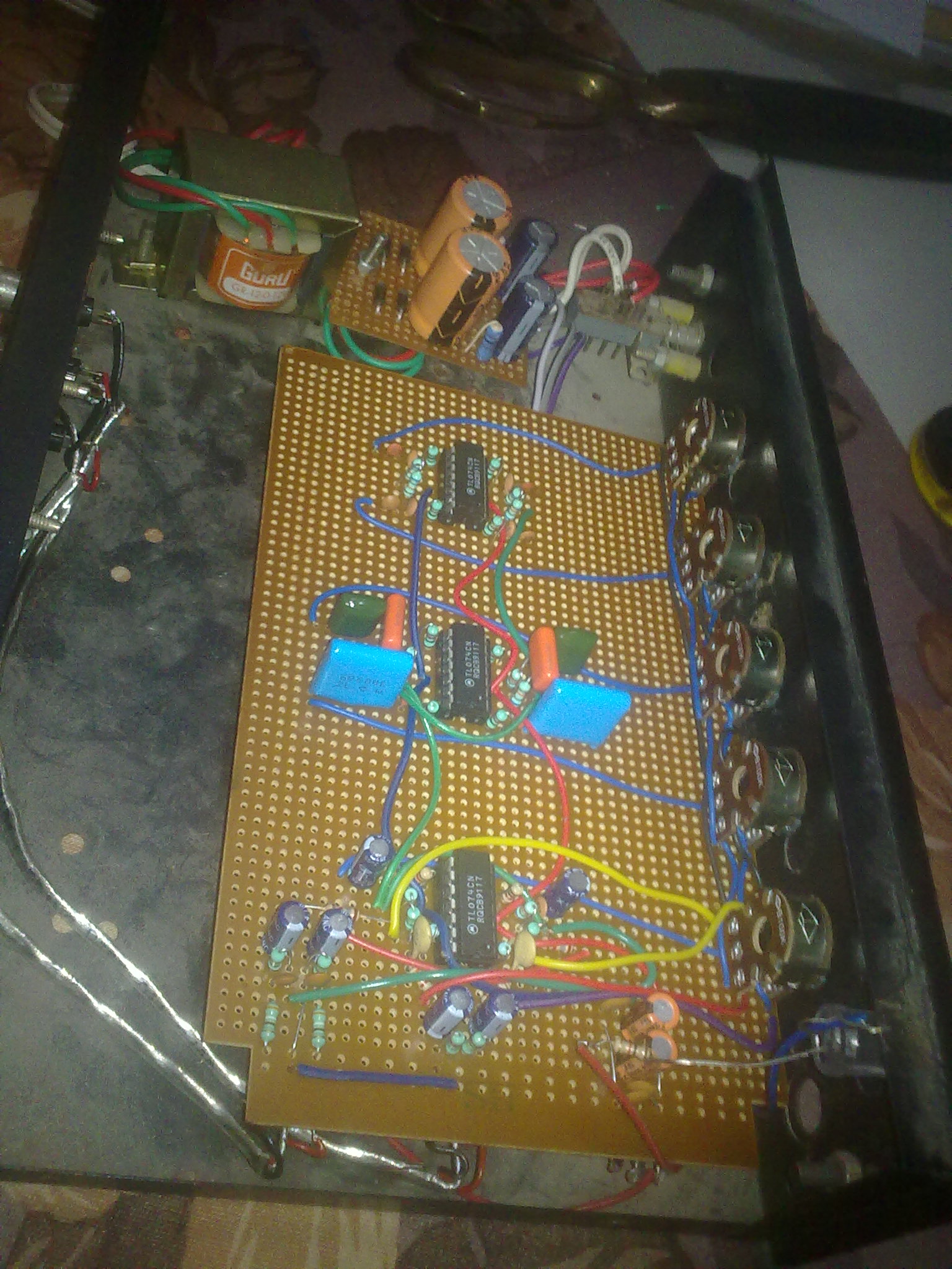

5 band equalizer, need help!!

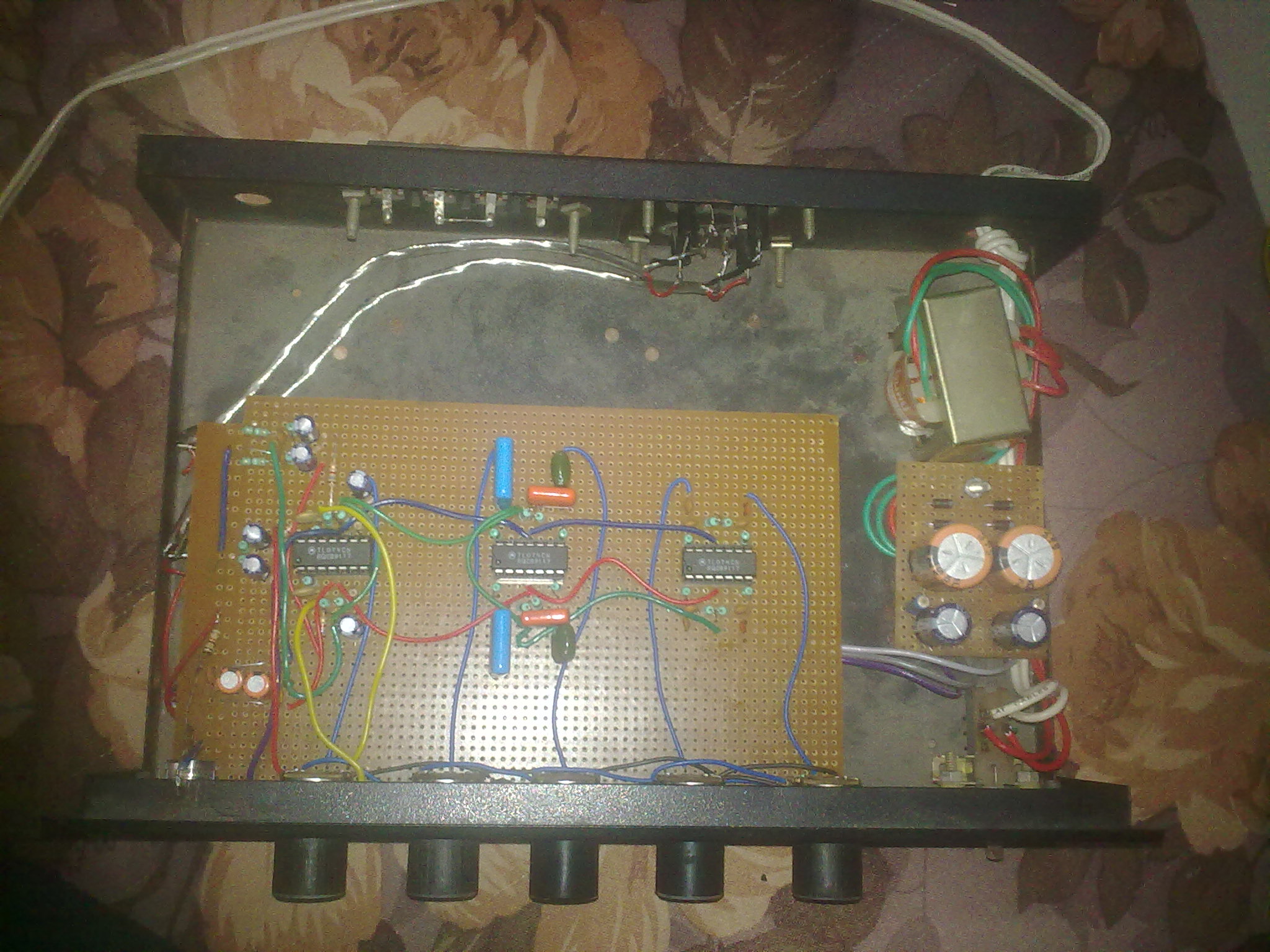

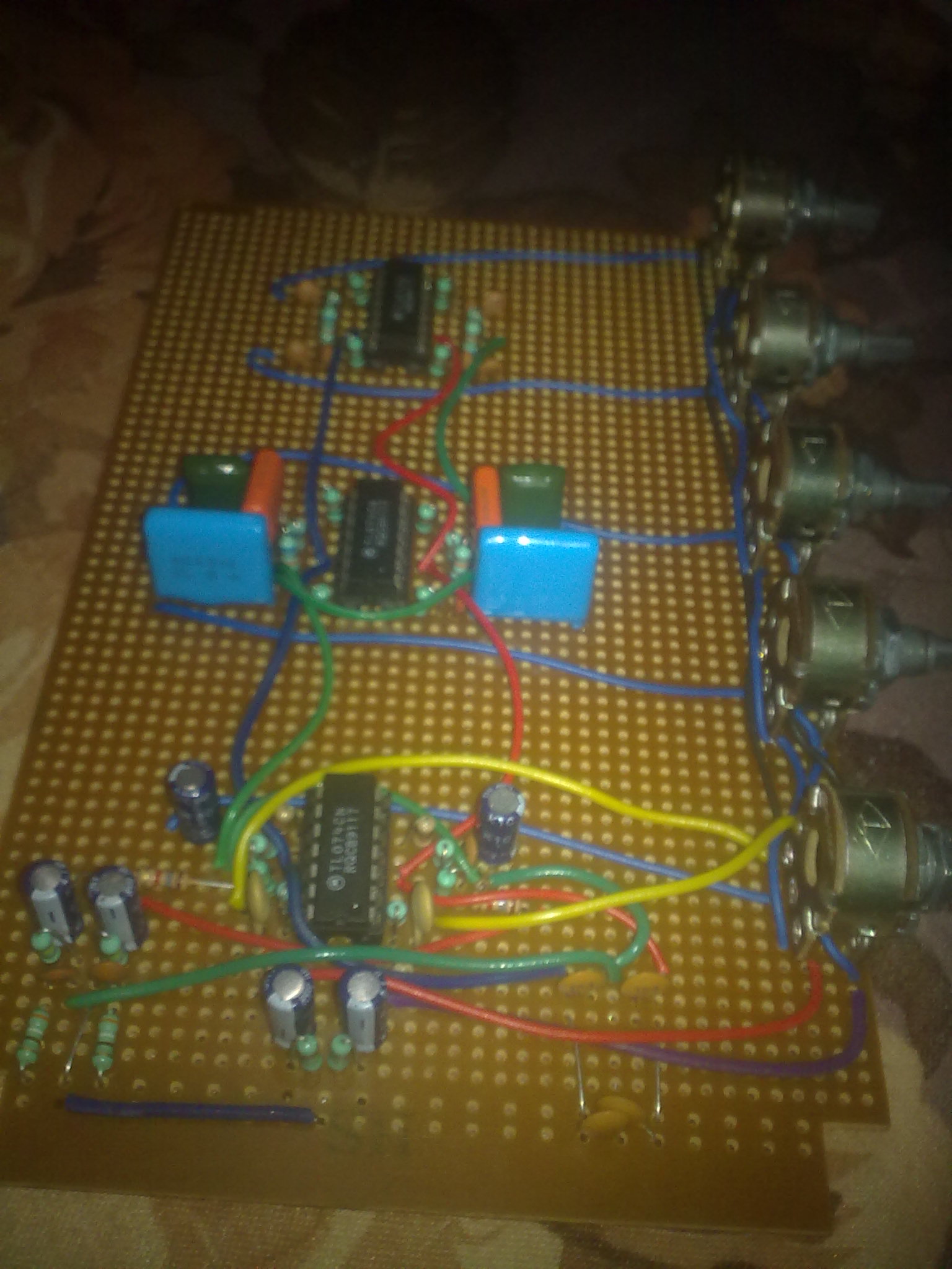

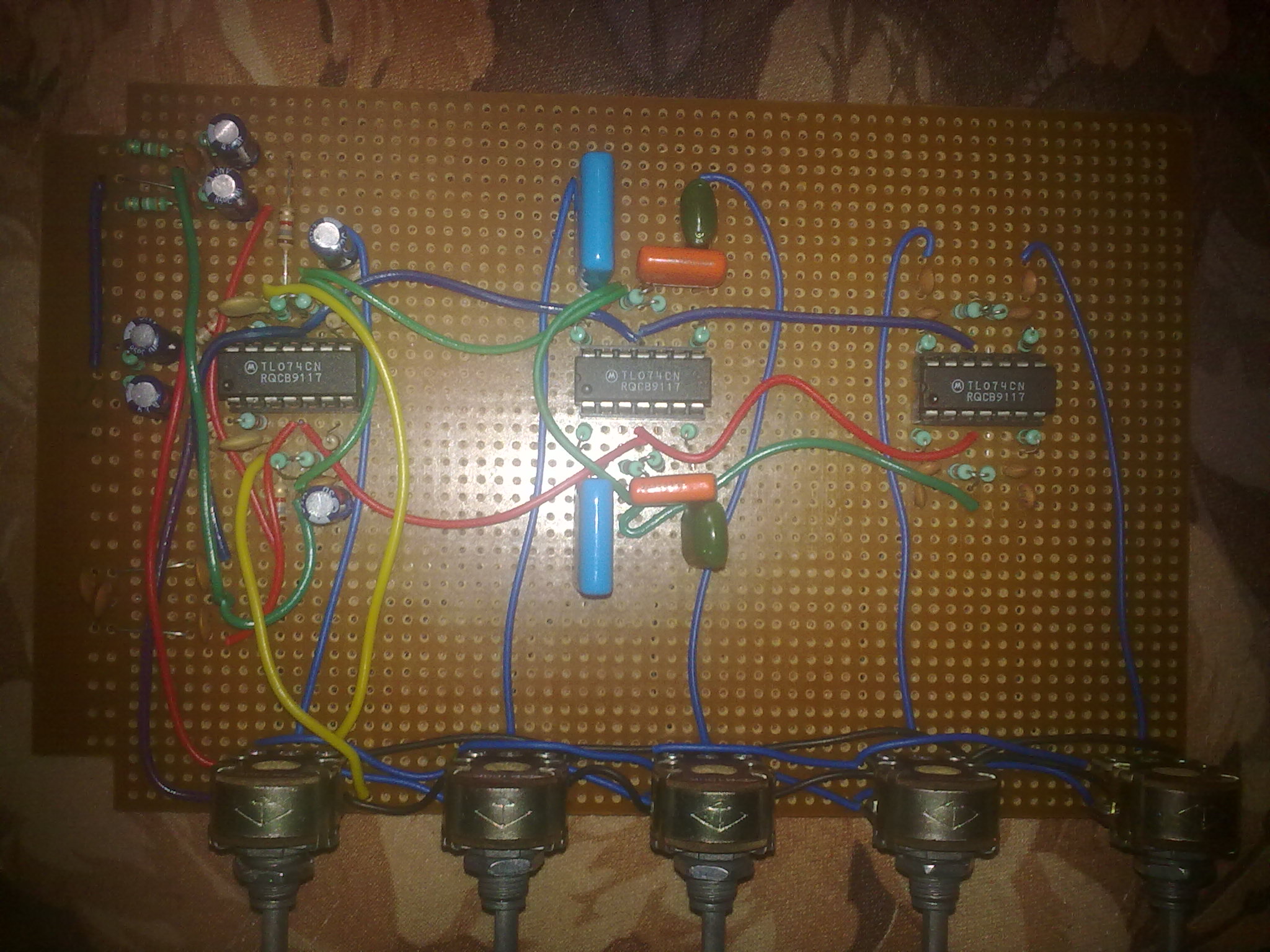

I modded a 10 band eq circuit by omitting 5 bands to make a 5 band equalizer.
But, it didn't worked. Hum on both channels, no audio, checked the circuit and the connections several times, no errors, no mistakes, no shorts.
Kindly help, or i would start over again with a new circuit if anyone could share.
Aniket

Some pics

Hi Aniket,
Sorry to hear that your board is not working as expected.
How did you make the power supply ? It's a dual power supply as I guessed it from your post.
Could you post your modded Power supply Section circuitry of this Eq ?

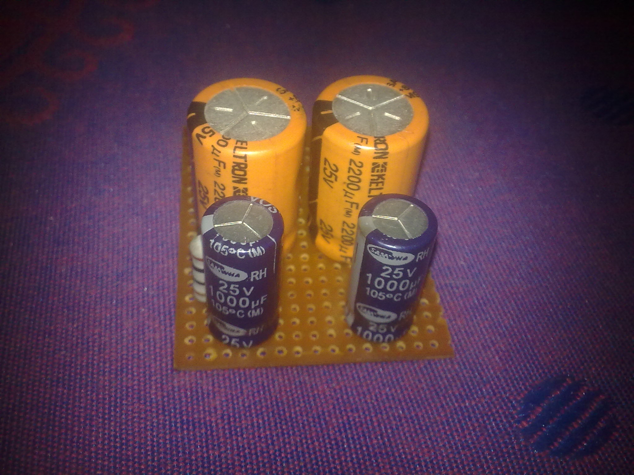

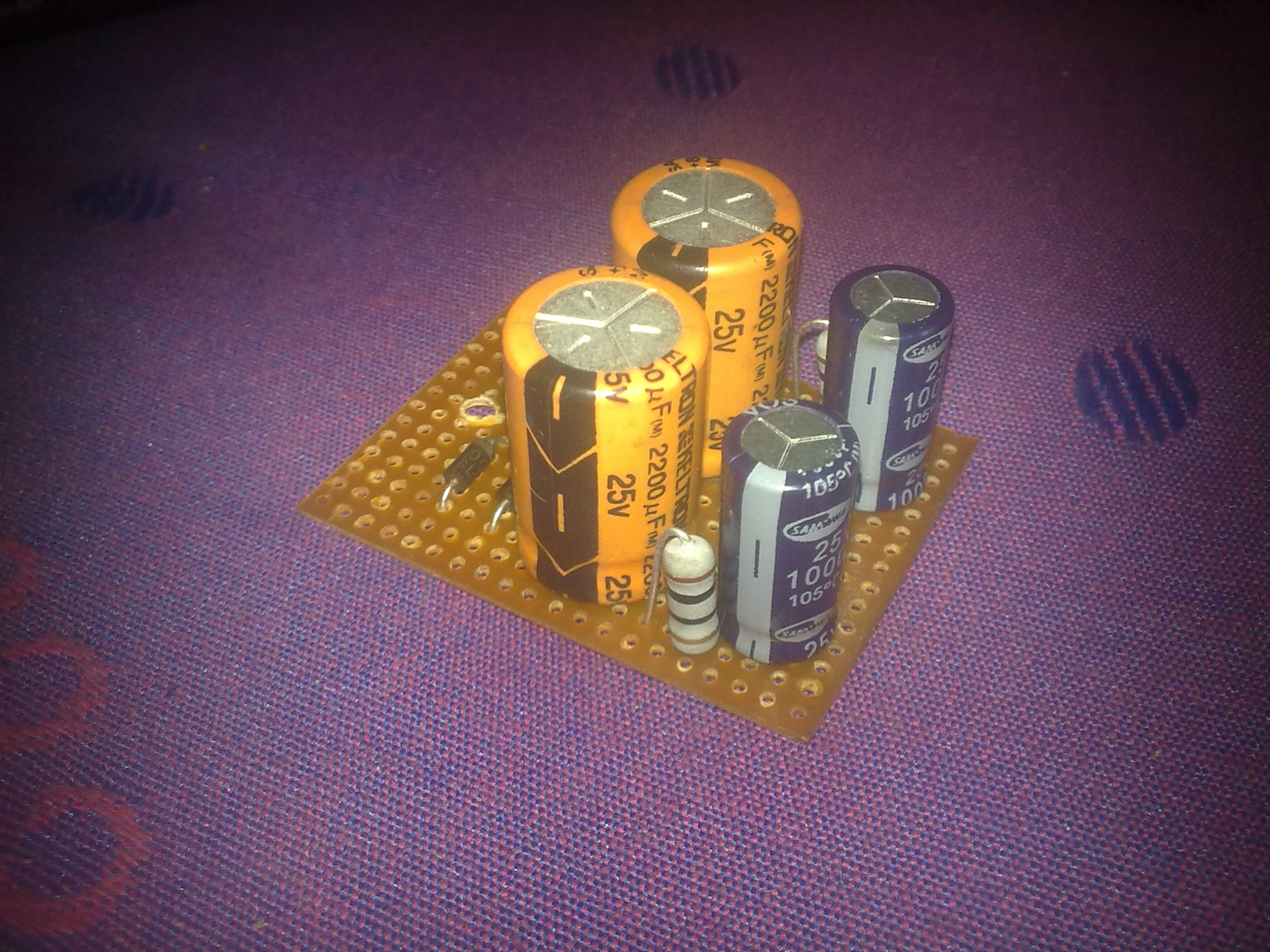

Hi csom,
I made the psu myself, yes its a dual power supply
Its simple with a 12-0-12 V sec. transf. and bridge made using 1N4007 diodes, 10R 1W resistors and 2200uF filter caps.
Have you made this 5 band eq. using transistors as shown in the link you mentioned. //http://users.otenet.gr/~%20athsam/EQ_3.htm
Aniket

If you are getting the desired voltages at the collectors of the transistors and the pins of the line driver opamp TLO72, then it might be a ground issue as per the symptoms you stated earlier.
Also make sure your signal is being fed correctly to the circuit and it has a proper ground connection.
If any input or output capacitor is open, then the circuit might not respond.
Also make sure the dual pots are properly soldered. Sadly I found 3 bad pots with a manufacturing defect. But that's a very rare case.
I would prefer LM317 and LM337 for the dual power supply section.
I have only built the 3 band Eq section from that site and I'm really very happy with it.
But next I'll try the 6 band one as I really love opamps over transistors, a purely personal preference.

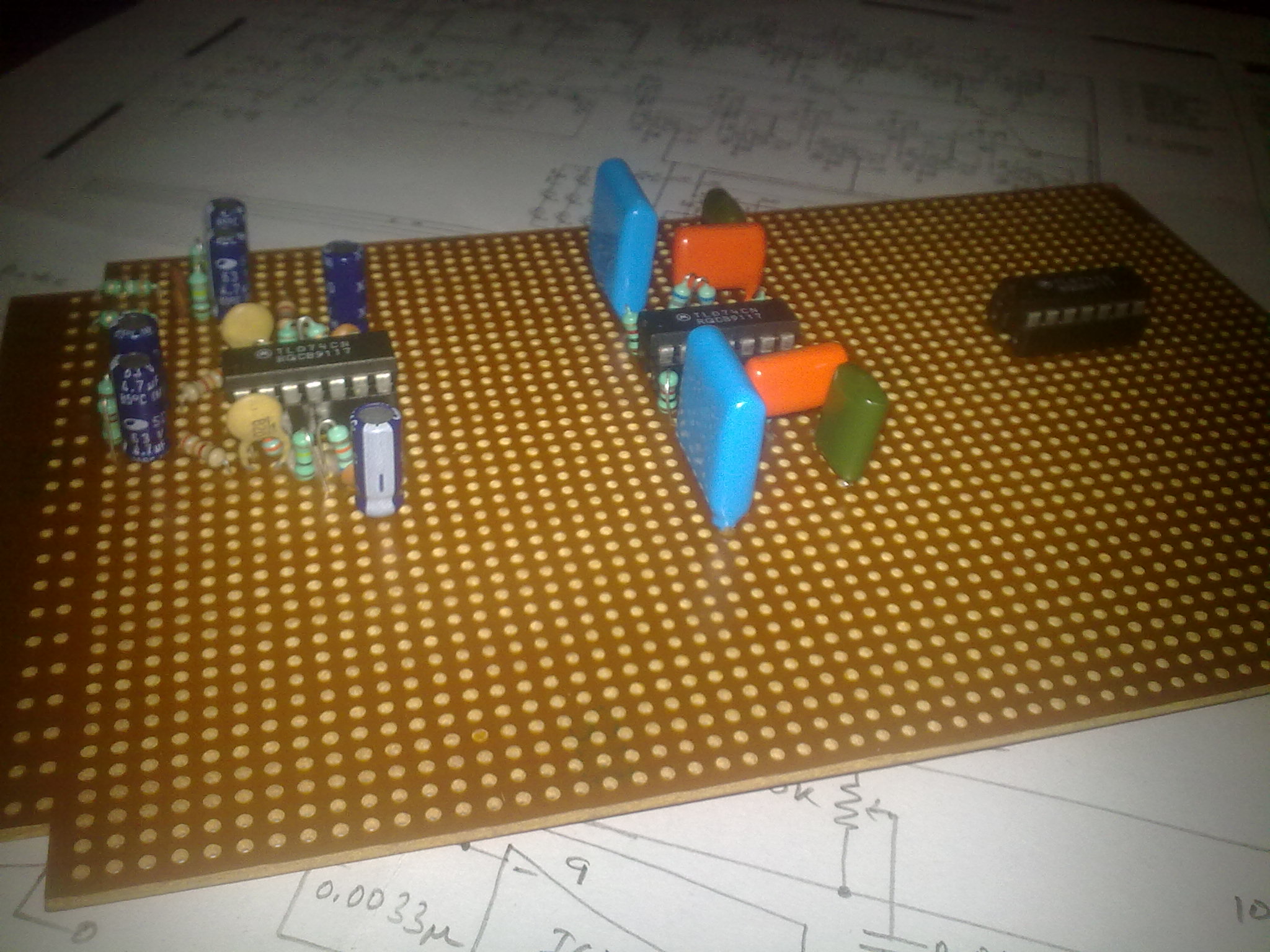

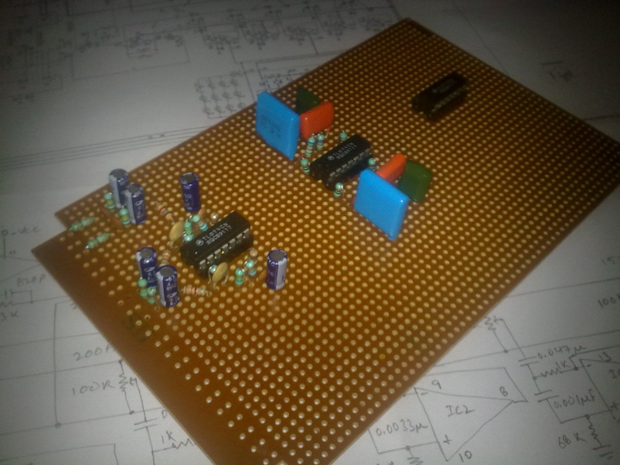

made all the connections correctly, used shielded wires for both input and output signals, hum present on both channels, no audio with input connected to PC and output to amp.
I checked all the connections circuit several times, found no mistake according to the schematic.
Replaced TL072 with NE5532 and NJM4558 but same result, also i must tell that i used BC547 instead of 2SC1740, but both are almost identical GP transistors and all caps are fine.
'might be a ground issue' please elaborate Dear Som, i coudnt understand.
At last i removed the board from the chasis and placed my same old 5 band eq board i made 4 yrs. ago using 2 transistors per channel, still working nice.
Aniket

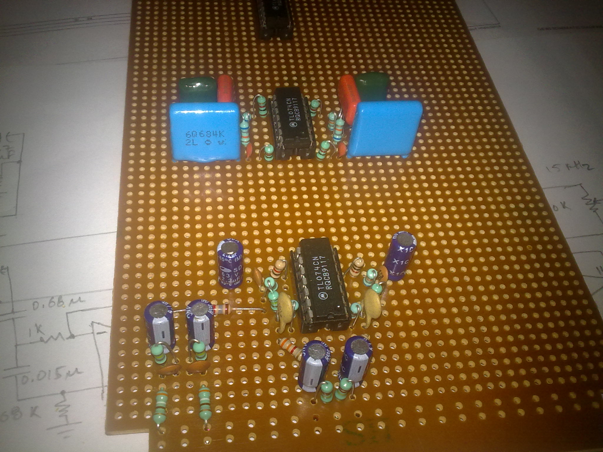

i have gone through your whole thread Som,
there's no ground issue on my board, and voltages are fine across all transistor pins.
and i have made it on a general purpose PCB, as i said earlier no mistakes according to the schematic, and I checked transistor pins while soldering.
I have some TL072, TL074 and NE5532 opamps,
anyone could advice me a nice and working 5 band eq circuit.
Aniket:)
First of all, solder a wire on the metal sheet of all the potentiometers and connect it to the ground point on the filter capacitor.
Next, u have very long wires. So better make all things as small as possible. Those green and other wires r also too long.
As Oswaldo suggested, check the transistors with a fresh mind.

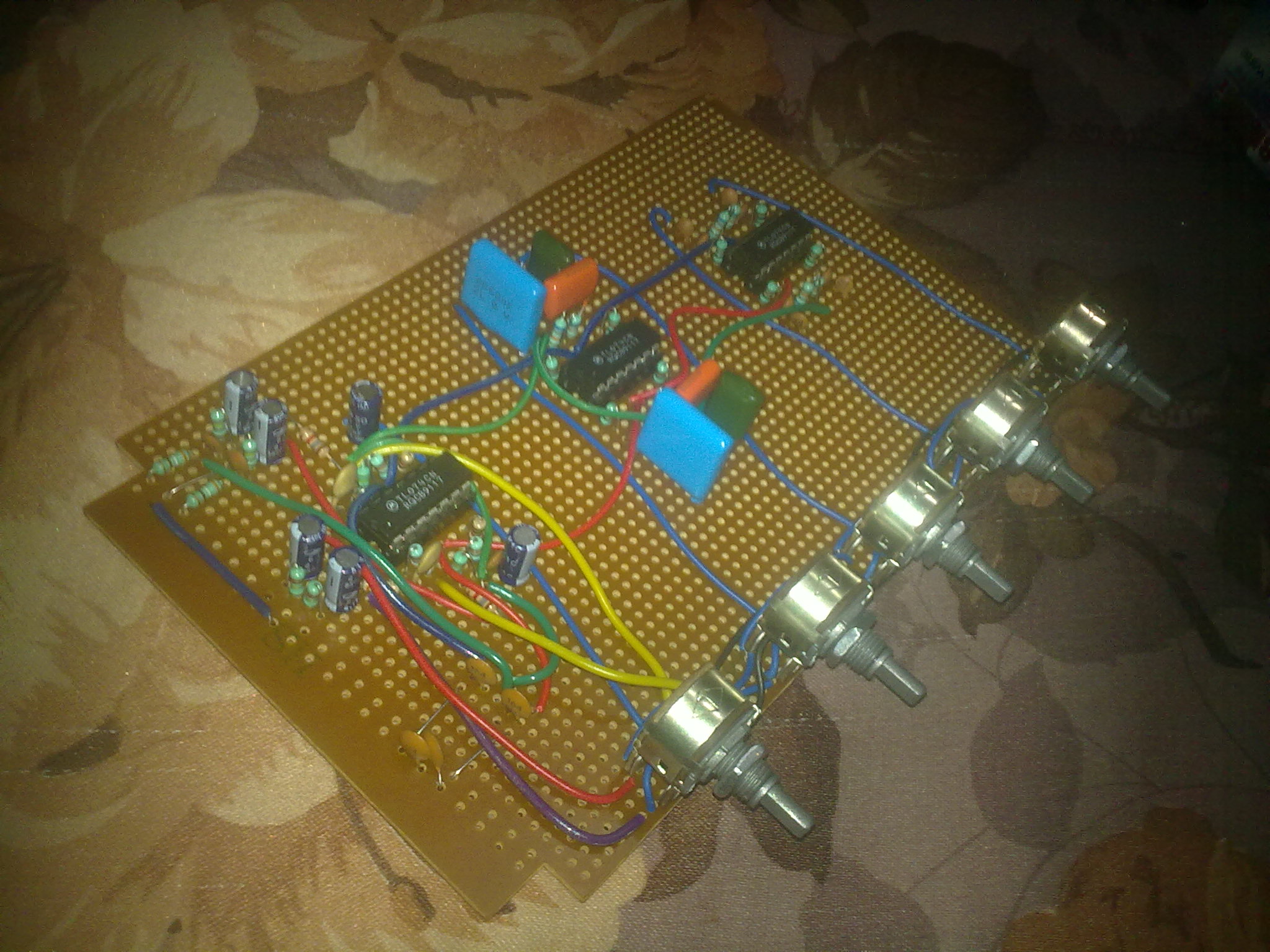

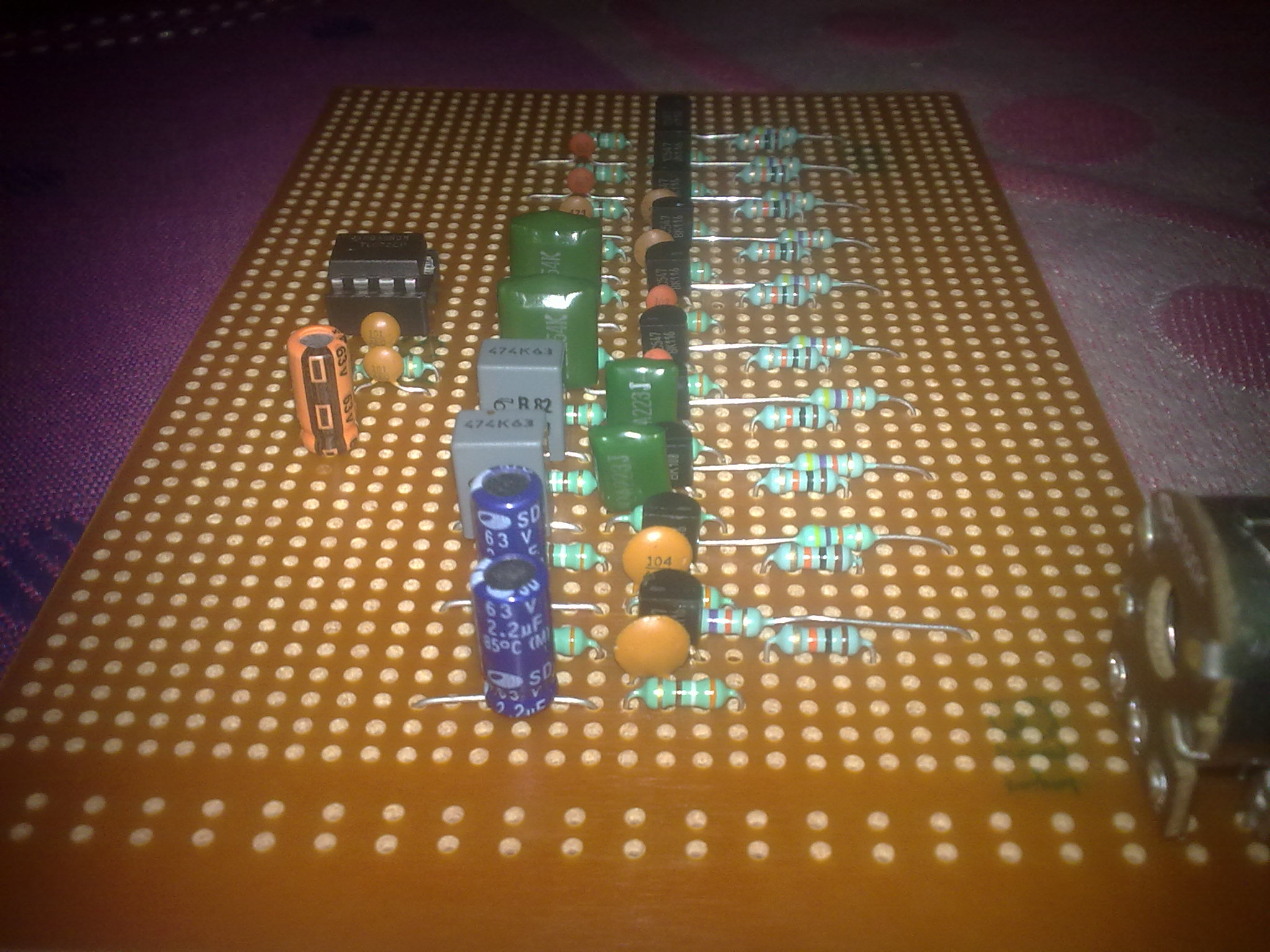

I dropped that project and kept that board aside for a while, would check that later.

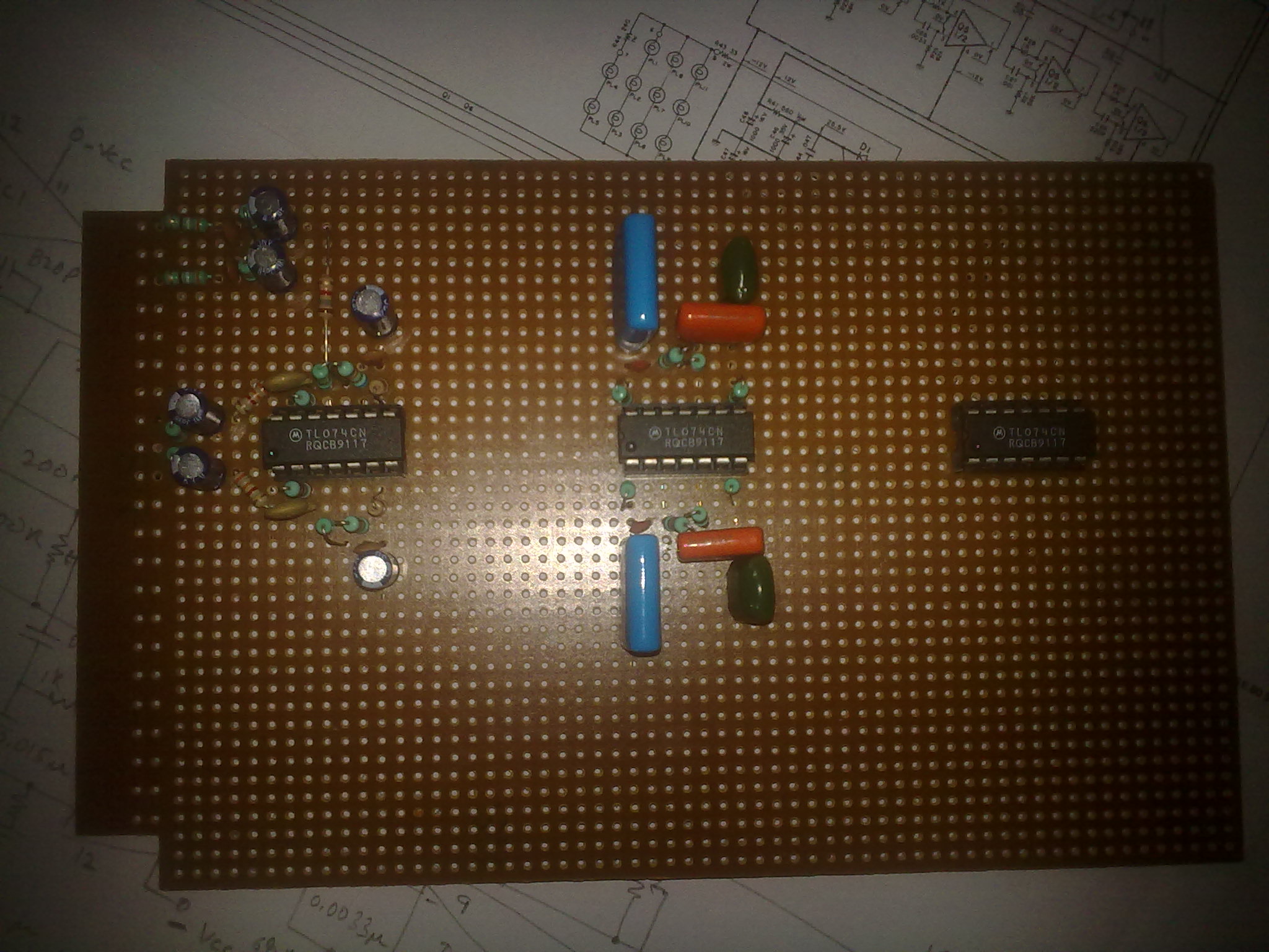

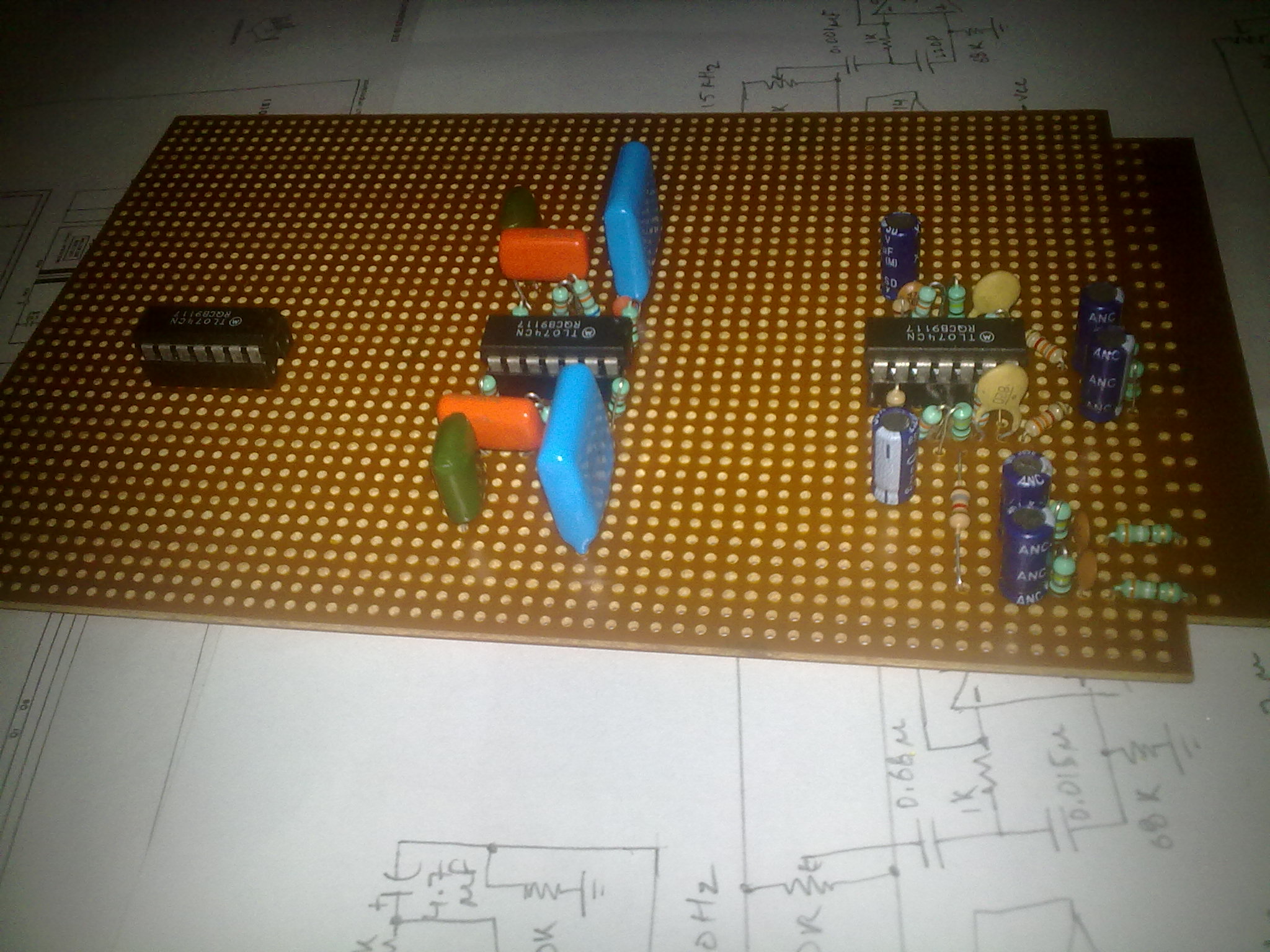

As i need the eq. urgently, i am constructing another circuit, as attached using TL074 opamps. I found the schematic on HiFiEngine, would update soon.
Hi, Gajanan, thanks a lot for the advice, as the chasis is grounded, no need to ground the potentiometers, hum is not present due to any grounding mistake,
maybe the schematic is wrong and need to rectify that.
As of now, I'm uploading both the schematics, advice is most welcome.

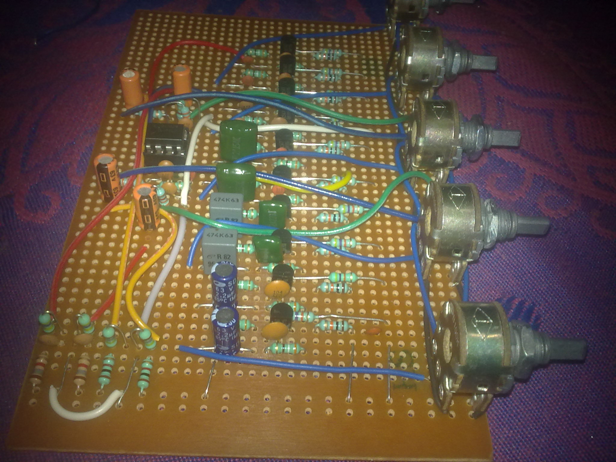

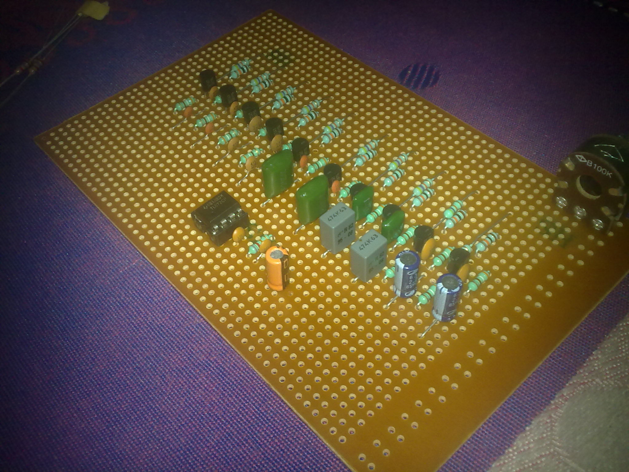

New eq. working great, nice control on each frequency band, no hum, hiss, dead quiet, crystal clear sound. Here are a few pics. I would also mention that I changed value of C10 to 0.01uF instead of 0.001uF as in the schematic for 13kHz frequency band, with 0.001uF there was no cut or boost, but working brilliant with 0.01uF.
Aniket
