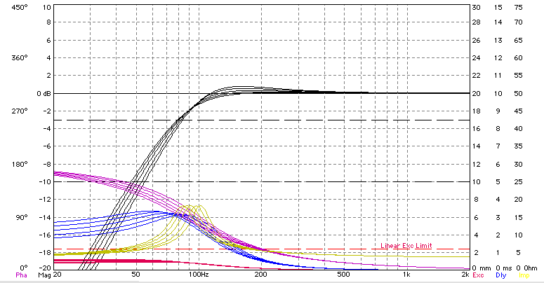

Hi Dave,
do you planning to place more details in your plans (like frequencity/impedance charts) or at least f3/6/8?:)

Attached is a sim of undamped sealed enclosures of 4, 5, 7, 10, 15 litres. Stuffing material will make the boxes seem larger, decreasing the bump and extending the f3 downward. Room placement -- usually on the wall, will extend the bottom significantly. As per Toole, they should all be cut off at 80 Hz, so extension is sufficient.
If one wants to reduce Q any of these could be aperiodically vented.
