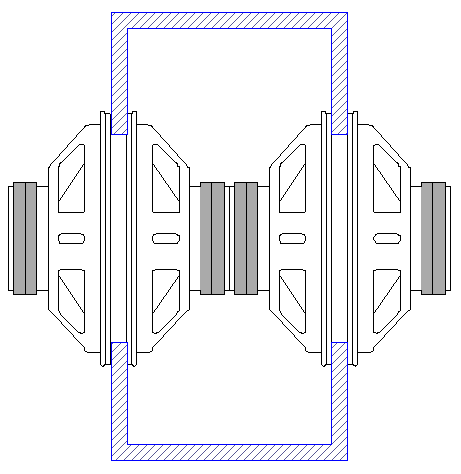

I have found info on the use of two drivers in isobaric coupling, but what happens (in terms of sensitivity and box design math) if I use 4 drivers? Two should be facing out into the listening room, and the other two should be hidden inside the box, with isobaric coupling to the outter two.
The drivers are Peerless SLS-8 drivers, nominal 8ohm with about 87dB sensitivity each.
My plan is to put connect two drivers in parallel (giving 4 ohm), and then connecting two of these sets in series, giving 8 ohm again.
If I have understood it correctly, two drivers in parallel (mounted isobaric) end up with the same sensitivity as a single driver. (if this correct?)
If so, I am splitting the power (with two "4-ohm pairs" in series), but getting double the cone surface. Where does this lead me?
Can anybody tell me the overall sensitivity of this system?

It will be the same as a single driver.

he didnt say it was a waste of time, only cone area and money. Cone area is wasted because you used two drivers and get only the cone area of one, and time is wasted because you spend twice as much on drivers.
But, you get double the themal power handling and half the enclosure size, plus canceling of some distortion and a slight increase in linear Xmax.

Thanks for the replies. I was not planning to make it as a dedicated sub, but as the low-end of a 3-way. (Don't worry, I got someone to help me with the X-over).
Thus, I would use 8 speakers in total, 4 for each side.
If I understand it correctly, using 4 drivers (2 isobaric sets) in each enclosure, it would give me the sensitivity of one driver, but with better power handling?
Am I correct, that this setup would have lower displacement (cone movement) for a given SPL than a single driver (since there are two cone surfaces to move the same air as one would have to do)?

As the gentleman said, a waste of money because you pay for two drivers and only get one, and a waste of cone area for the same reason. IT may be a valid way to make some drivers you already have work for some application where you need a smaller box, but IMO if you are starting from scratch your money is better spent looking for a driver that will work in that application in the first place.
You could also call it a waste of power because you need twice the power to get the same SPL. Isobarik is not a free lunch. Depending on how it is done, it doesn't always save as much space as you think bacause if it is not clamshell (which looks ugly) you have a tunnel to build.

Hi all,
What would happen if I placed all 4 drivers facing out of the enclosure (useful driver surface)? I would mount 2 drivers in parallel, and two of these sets in series, getting back to 8 ohm.
I'm fairly new to this, so please comment on my math:
2 drivers in parallel should give +3dB for "doubled surface", and +3dB for half impedance (double power), resulting in a 6 dB gain.
If I take two of these sets in series, I would loose 3dB to reduced power, but gain 3 dB due to doubled (again) surface. If I am correct, this should give 6dB gain over the single driver, while having a better power handling. Is this correct, or am I wrong (if so, where)?

As far as I know, you have that correct. You should gain 3db for doubling cone area once (2 drivers), another 3db for doubling again (4 drivers), and none from impedance since that didn't change. Which gives you a 6db net gain. Depending on frequency and driver layout, though, you can have lobing issues with that many drivers. I'm not sure what exactly happens to the power handling. Anyone know if it double or quadruples over a single driver?

Yes, 3dB max SPL gain and 2x power handling over an isobaric pair. As already mentioned, with small boxes the space taken up by the 'hidden' driver and/or it's connecting tunnel becomes significant and you often hardly end up with a smaller box and you have wasted all that money on an extra driver. IMO isobaric only comes into real use if you refuse to use any active EQ and your box is bigger than 75 litres. I go with the LT every time.
I have played with WinISD, and come up with compromised at about 20 liter for isobaric (plus some extra for the spacing between the drivers), and 80 liter for 4 drivers. these two should give the same response/roll-off, but at 4 times the enslosure size!!!
The ideal flat roll-off happens at 41 liters and 164 liters, respectively. There's no chance that I'm going to build speakers this size.
Considering that I want to make a sub-inclosure inside the main box, containing the mid- and tweeter driver, I would end up in excess of 100 liter with the 4 "visible driver" option.
