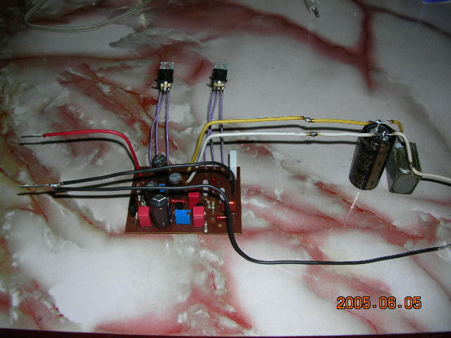

Disabled Account
Joined 2005
There are substantial differences between yours and the original design but I like yours better.
Yours has the gain in the first and 2nd stages: both are drain-loaded-with-CCS and with global feedback. The original is a source-follower, followed by a drain-loaded with CCS for gain, without any feedback.
It is my experience that it is easier to have gain with small signal. So I was wondering if you can improve upon your design by using a source-follower in the 2nd stage (source follower + CCS).
You can then limit the feedback to the first stage as well (you can look into the Zen to see how to implement feedback in the first stage).
Let me know what you think.
