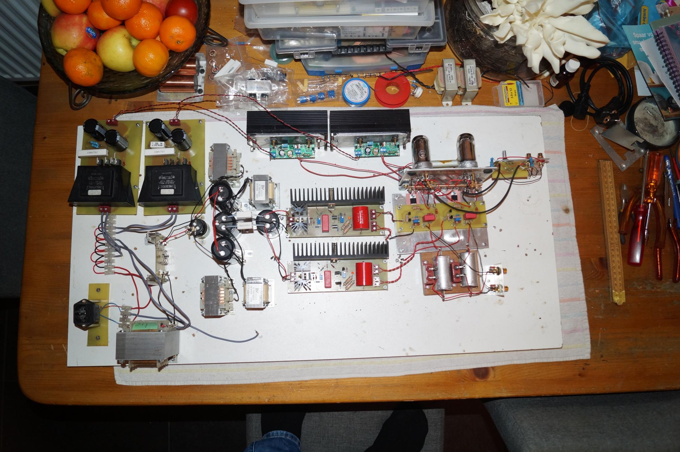

I am still listening, switching back and forth, but it seems that I hear the following:
- g2/g3 as Anodes: Very, very precise. But as well a bit dry.
- g2/g3/anode as anodes: More body and sould, more "tone", but a certain smearing takes place, not as precise as above, it is like you listento two tube with two different sounds in parallel.
- g2/anode together, g3 not connected at all: You got the tone and you got precision. No smearing. Not as dry and precise as g2/g3 only, but maybe the version I like best in the end.
I need to listen further, but the switches you saw in the picture allow me to do a A/B test within a minute.
Ne ertheless, its time to compare all of this with a real DHT. 801a is waiting. Coleman regs will get bigger heatsinks...

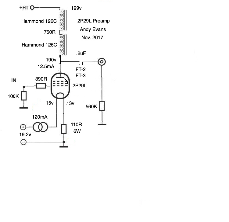

For my ears a choke is a must too. I just use LCRC - single choke - but try and make that choke as large as possible. I have quite a few big chokes of 280mH at 2.7A, and I use those for the PSE 4P1L output stage. For the input stage 2P29L I use Hammond 158T, which is 1H at 300mA. As said above, the sound is audibly smoother with a choke input. Yes, it's an extravagance but we're in the game of maximising everything with DHTs. The circuits themselves are ridiculously simple, but the filament supplies are almost amplifiers in themselves. I have them all in separate boxes with 4 pin XLR leads. Just a different way of thinking overall.
As I've said elsewhere, I'm really pleased with 2P29L into two of Hammond 126C in series, just used as plate chokes. Ends up being large and heavy with 4 of the things - I take the end bells off and mount them in the chassis. But it's worth it. I have a 10Y version with the same 4 of 126C but for daily use I'm fine with 2P29L, and it's on 24/7. 2P29Ls are cheap and good, just like the 4P1L.

I believe that the126C has only one primary with 106H...(http://www.mouser.com/ds/2/177/5C_124_126-32259.pdf). I believe Andy had two of these around and connected two primaries in series and just did not used the secondaries, so a hefty 212H...
