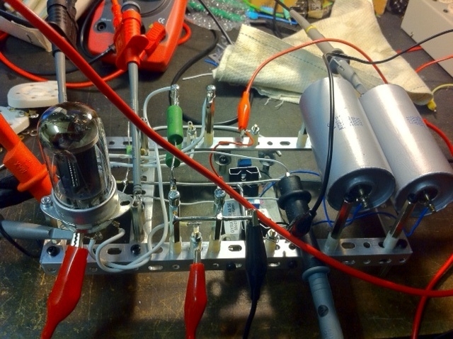

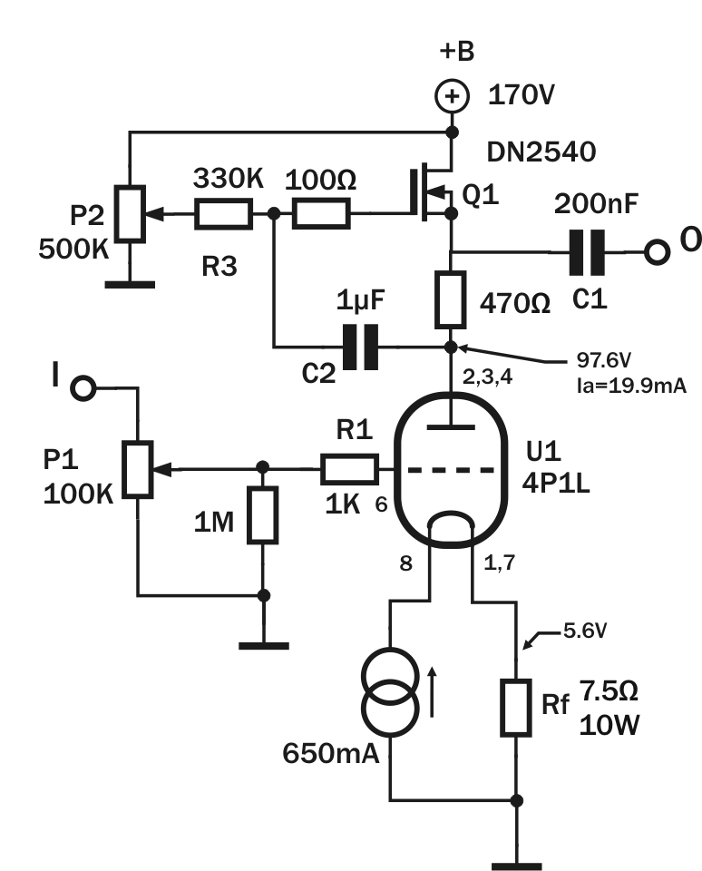

Breadboarded preamp attached. This valve in triode mode is really linear. You can get down to 0.01% when anode current is about 40mA!
My tests were done with Vi=1Vrms. At Va=97.6V and Ia=19.89mA the THD is 0.05%, much better than an average 26 though. Gain stage is about 9.5 in this circuit.
Now need to build a pair of these and build the preamp to do a proper listening test. I can't wait to listen to results and hopefully not end up with a ringing preamp!

I just built a 26 preamp. It definitely has something special, but nowhere near as clear as 4p1l preamp. I am off to India for a month in a few minutes. When I get back, I will complete my //4p1l power amp then optimise and compare the 26 and 4p1l preamps side by side. Should be an extremely revealing test.

Did an audio test with my breadboard preamp and results as expected:
1) The sound is crystal clear and dynamics are superb. Great bass response. Everything you would ask of a preamp. Still need to do a side by side comparison with the 26. Although this preamp version is powered from my bench power supply and has no filament regulators.
2) It rings indeed. Oh man, many said so and it's true. Not that critical though. The ringing is very low and in my breadboard I have to tap with the back of my screwdriver to get the ringing out loud. It develops some harmonics around 1.3 - 1.6kHz and decay is quite fast. See attached FFT
After listening to Dvorák for 15 mins on my workbench with this preamp have to say that sounds really nice. I take that the ringing will colour the sound, but I wasn't able to notice it so far in the breadboard.....
More tests to follow...

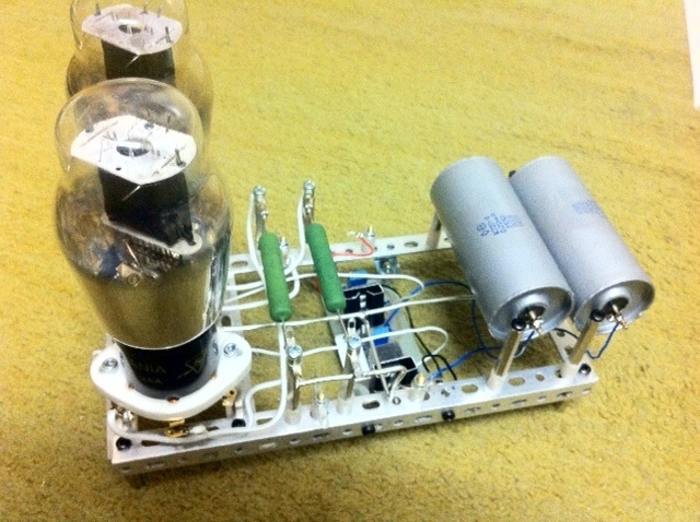

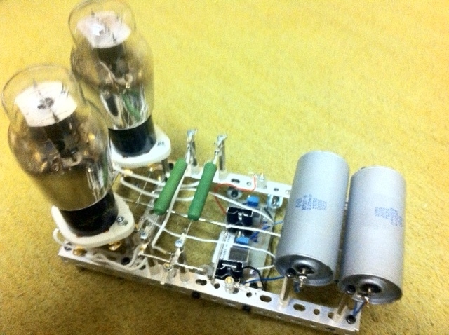

Finished now my modular breadboarded pre-amp and now tested the 46/VT-63 and was amazed with the results!
Quiescent point at Ia=11mA / Va=100V (Vgk=-8.8V - filament bias) where the stage gain is around 6 and the THD=0.16%. Surprised with the linearity of the 46.
Andy Evans recommended it before and he was right, it sounds really good.
Still running this setup with my bench power supplies and am amazed with the results so far.
Still listening to Dvorák (Concert for violoncello) and enjoying the full bass, warm and clarity of this stage circuit...
