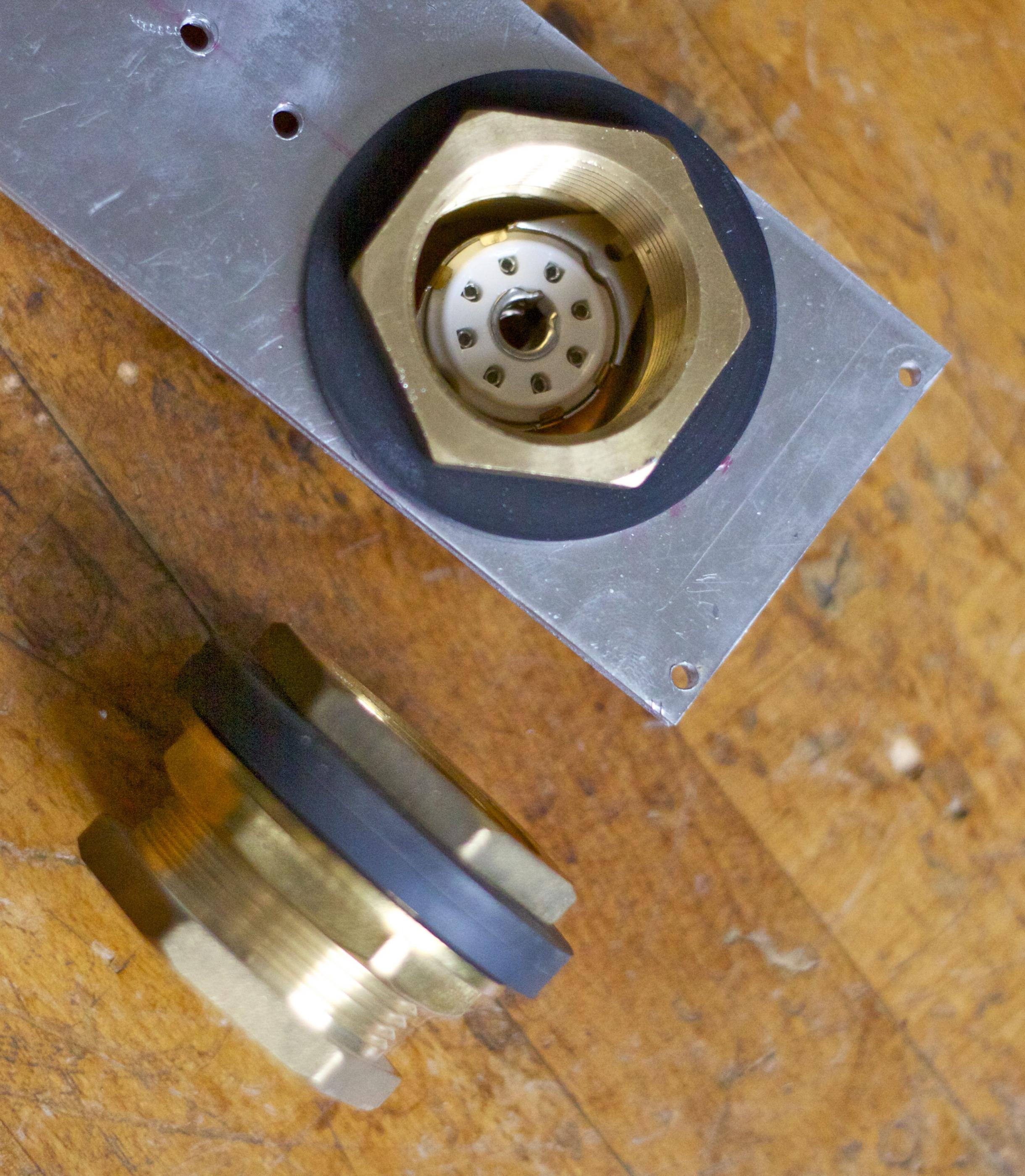

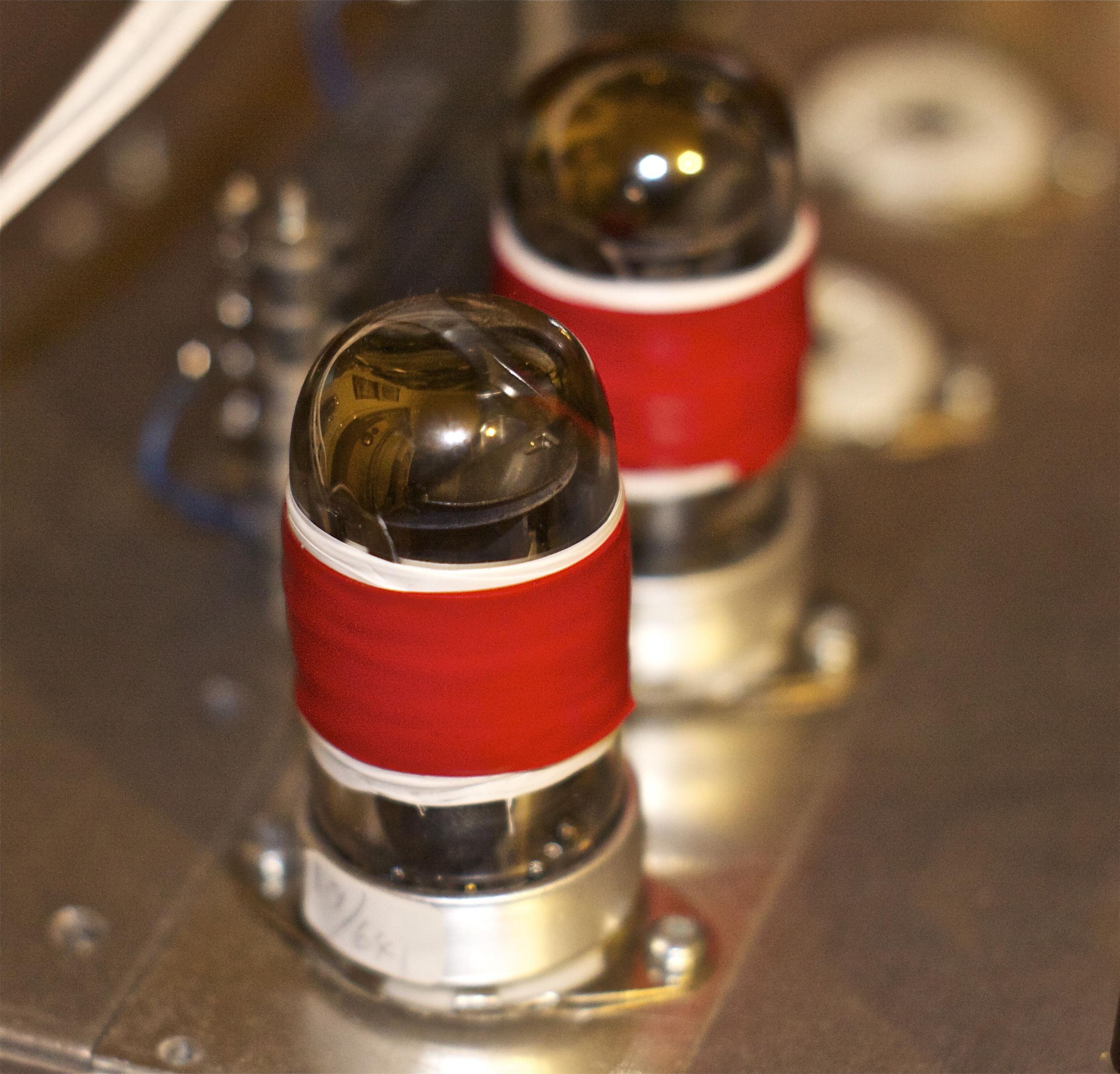

I use the 4P1L as the input stage in my 4P1L PSE amp, fed by a 9023 DAC outputting 2v. With 2v input microphonics are less of an issue than with say 0.5v in where you have to be creative. I use a LL1660 in 4:4.5 because I want to keep the gain for a 2-stage amp. Works fine. Two things you can do for microphonics:
1. Wrap plumbers teflon tape around the bulb. Helps a little.
2. Use a big and heavy chassis
Here are a couple of photos.
