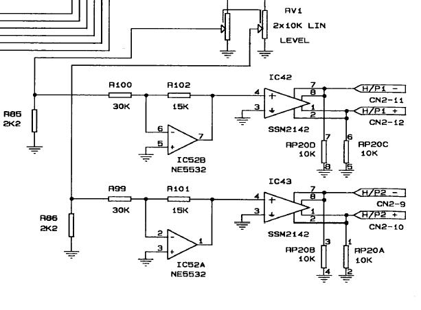

DRV134 is not easy to UK source in small qty. Use SSM2142 (equivalent). Best price is from Rapid Electronics.
It's really easy to use, just follow the data sheet' application circuit. The power supply requirements are the same.
You'll need an opamp as well if you need gain.
Sorry, I've got no spares of these:)
from one UK broadcast console ;)
omit R85,86
change R99,100 to 10K, R101,102 to 100K for 20dB gain
regards

Fantastic - it looks the same as the one on the datasheet except for RP20C/RP20D (tying outputs to earth) On the datasheet it shows pins 6/7 being (+), and pins 1/2 being (-) is this irrelevant?
EDIT - Does the 5532 invert the signal ?
I reckon I'll have this built within a week or so.
Cheers
Rob

Sorry John -
I should have said pins 8/7, and pins 1/2. On the link you gave me it says that 8&7 are positive output and sense pins, and 1&2 are negative output and sense pins. On the schematic Moamp posted its reversed. Hence why I asked about the previous stage inverting the signal.
Bear with me I'm on a learning curve here:D
Cheers
Rob
