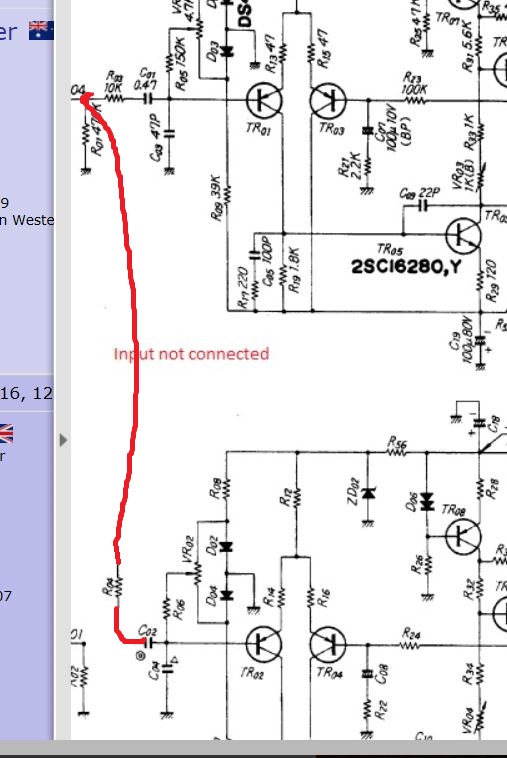

Lift the 10k at the input to the faulty channel and cross couple it to the good one such that each channel is receiving the same signal.
Ive got +5.4mv and -5.8mv across an 0.33 ohm output resistor on the good right channel. The left channel has +0.0mv and -0.2mv across an output resistor. If I lift the 10k ohm resistor on the left channel,do I connect the 10k resistor to where on the right channel,at the same place as the other 10k resistor? Another thing Ive noticed is the changing voltage from the big cap power supply,with the DBT connected it will be 50v,then maybe 46 volts,then something else.today its 43.6 volts? I dont know if its the load or the power supply itself but Ive checked the PS a few times before and cant find anything wrong there?

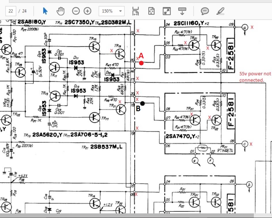

Lets stick with the easy stuff :) The 10k is done like this. Lift one end and wire it to the good channel as shown here.
If the bad channel has no bias current (0.00 volts across 0.33 ohm confirms that) then there may be a problem with the output stage.
Put your red meter lead on point A and black on point B. The voltage should be around 1.4 volts and should be alterable with the bias preset. As the voltage approaches 1.4 volts then the output stage should start to conduct and current flow. Be careful, don't blow anything up.
Also compare this voltage with the good channel for reference.
