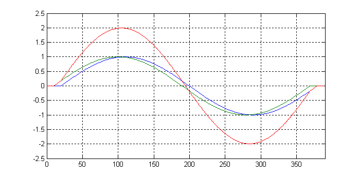

I don't question what the ADC can to, it is how often sampe should takes place. If you have two 20K signals superimposed at different times just 1/10th of a wave length apart and only one cycle of these, How can it mathematically be reconstructed since the two samples can also be a samples of a different combination of modulation? I would have to be proven that two samples can only be the results of one unique modulation combination for perfect reconstruction to be true. Is there any reference information that proves this?

I think he's describing a transient like the attachment's red curve...
Remember: anti-alias filters ARE PART OF THE SYSTEM, both before the ADC as well as after the DAC. The waveform you have drawn has components far above 20kHz, is illegal in this system and will never occur. Sorry, this is a very strict definition that those engineers set up, to make the system work. You've got to stick to the rules.;)

Exactly what i'm saying.
So notice the ends of the red curve. In reality, music signals like this can possibly occur, but the ends would not be reproduced. So the reproduction is not perfect. All music signals are transient signals.

soongsc said:
So notice the ends of the red curve. In reality, music signals like this can possibly occur, but the ends would not be reproduced. So the reproduction is not perfect. All music signals are transient signals.[snip]
Music signals like this CANNOT occur. What we call transients in music are sudden attacks of a tone TO OUR EARS, but compared with the electronic 'instanteneous' start of a wave as in the red graph, music starts slowly and leisurely, even as 'attack'.
