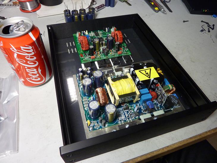

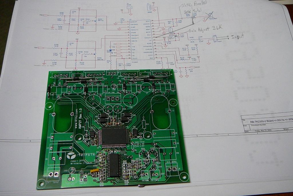

Yes I have everything on AMP2 - I started building a bridged version of an AMP2.
I bought 2 boards, one for each channel. 1 board is partially completed.

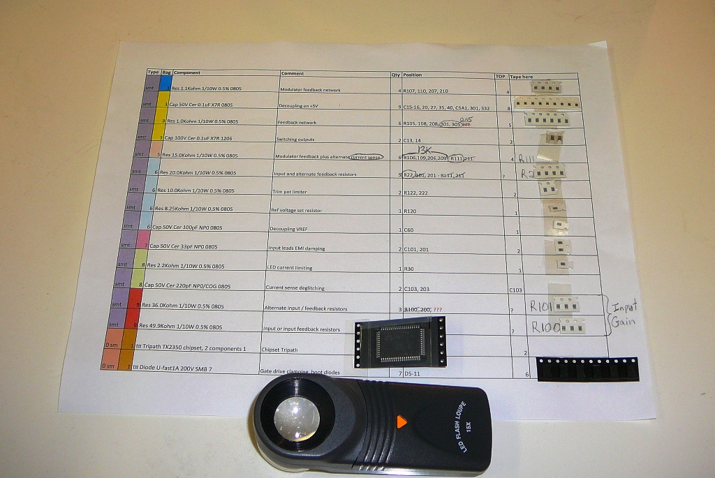

1st photo is the spreadsheet I made with parts placement & optimization calculator.
2nd photo is fitting of board in a Bryston 4B amp case.

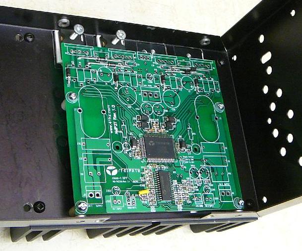

The last photo is an AMP2 in a 1U case that V-bro made & sold.

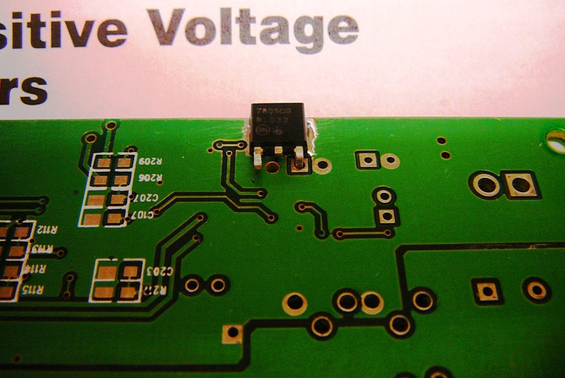

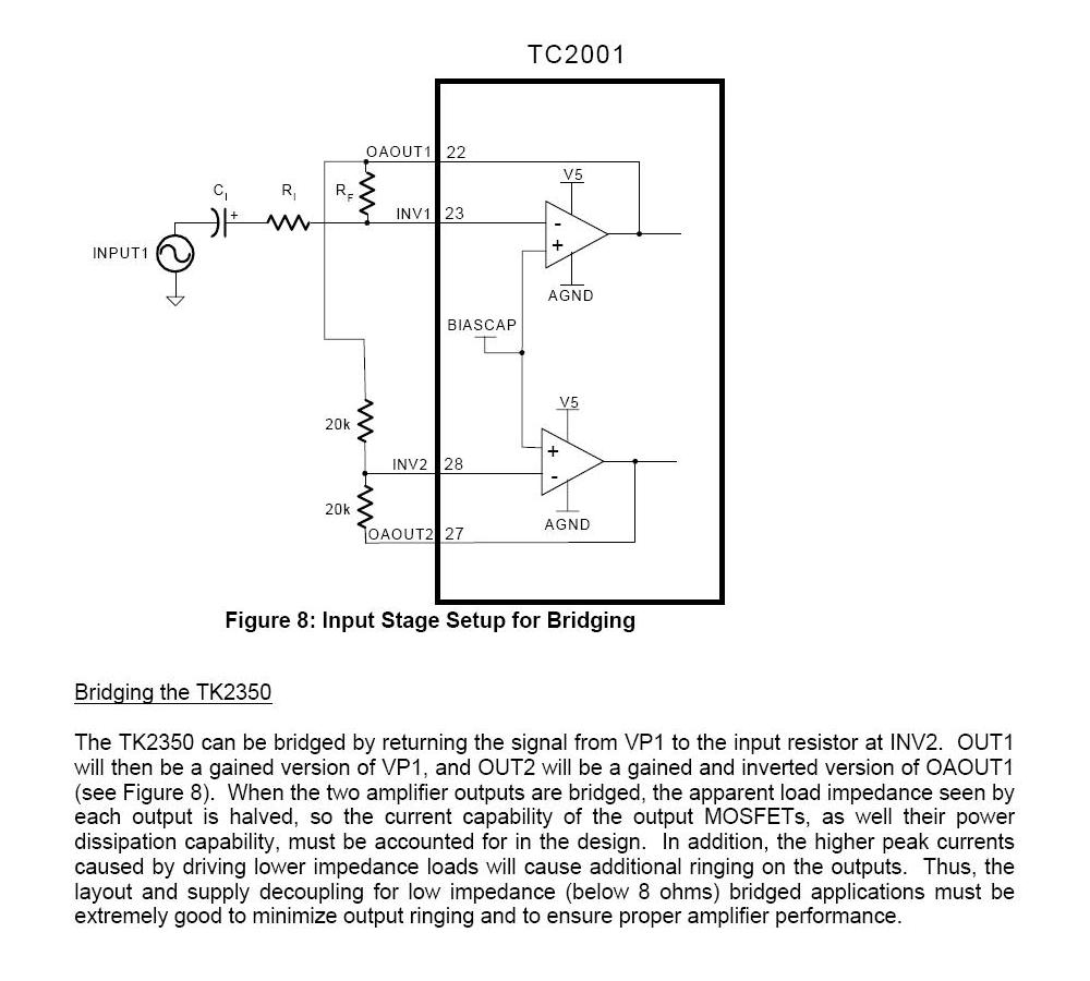

If you look closely in the 3rd pic above, you can see the jumper I added to bridge it (yellow insulated)

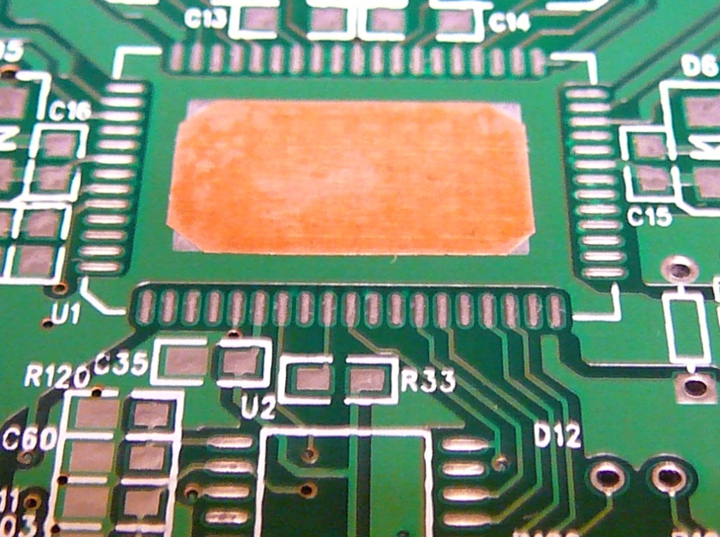

In photo 1 soldered a copper sheet under the chip.
In photo 2 you can see the heat sinks I bought to stick on the chip
In photo 3 you can see the on-board MC7805 voltage regulator chip I added.
Sadly it has been sitting unfinished like this for the last 6 years.
Now that I am retired I plan on finishing these off as a winter project.

I see the jumper... to bad it is not jumper like with amp7, that could be call modding.. in any case, you can't do it very fast if you wanted to, but didn't ever look into it, what would it take.
I don't know why do you need CU sheet under the chip, it will raise the chip and make soldering harder, I wouldn't use it (I can see it is very slim)
First time I soldered it, it was the best, 2nd time I used thermal past, not as good, but still good enough. For top heatsink I use U shaped Al profile, nothing special.
If you will need any help or advice, come and find me!
Thanks Luka,
I did consider leading the jumper out to an external switch, but this can subject the input to extraneous noise. In any case, the amp is designed to as 2 bridged mono amps and will not be switched back to 2 channels each.
I see you have some info on your Amp2 build on your web site.
I'll let you know how the build goes when I get back into it this autumn during the long cold winter evenings.

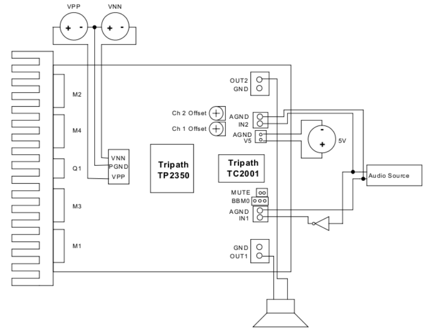

Hi Ryssen,
Based on your question, it appears you are building the early reference design amp and not the 41Hz Amp1?
Grounding is very important with these amps, especially the 5V supply.
On mine I used separate windings on the PS toroid to isolate the +5V supply ground from the +/- 30V PS ground.
Here is some detail around this from the 41Hz assembly instructions:
The +5V is used for the analogue input amplifier and the in-chip digital parts of the TA2022. It needs to be well stabilized and well bypassed.
You can use a 7805 voltage regulator or similar by tapping current from the positive main supply. You can use a separate transformer supply to feed the 7805.
The +5V should be connected using shielded cable, to prevent it from picking up noise. The +5V will not draw more than about 60 mA.
Hookup and shielding.
Switched mode amplifiers are a bit noisy by nature, in the sense that they emit EMI that is generated by the high power, high frequency output transistors.
This can be transmitted via cabling or as radiated in the atmosphere and picked up by other equipment like radios, preamplifiers etc or by the amplifier inputs.
It is therefore recommended that some precausions are taken. The most important is that the amp is housed in a metal/shielded casing.
Proper grounding is also important. Note that input ground should be taken to the board J2 connector ground, not to the housing or power supply ground.
The speaker returns should lead to J3 ground, not to the casing or power supply ground.
It is recommended that hookup cable for the signal input and +5V is shielded and as short as possible so that it does not pick up noise from the outputs.
Input cables and +5V cables should lead away from the outputs as far as possible.
Speaker cable and power cables can be twisted. All cables should lead the shortest way out of the casing.
More details on grounding can be found in the attached Ver4.0 reference design doc.
Three external power supplies are required to operate the EB-TA2022: VPP, VNN (referenced to
Pgnd), and 5V (referenced to Agnd). The VPP and VNN form a split rail supply referenced to Pgnd.
The 5V ground (Agnd) must be kept separate from the VPP and VNN ground (Pgnd). Agnd and Pgnd
are joined at a common point on the EB-TA2022 near headers J2 and J3.
