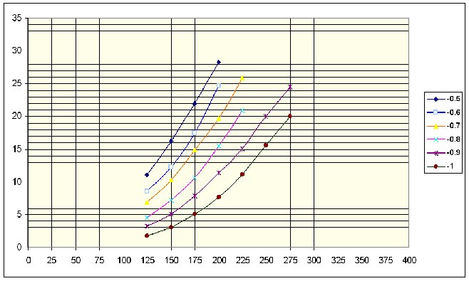

Note I did some curves for these; they are a bit tricky - my conclusion was that it's not worth bothering with the Bs - use the Cs or Ds as they can stand a higher voltage which is actually very useful when trying to find a sensible operating point.
Also give consideration to the fact that they get very hot; I devised two aluminium alloy plates that clamped to the valves to act as a heatsink - originally the valve - designed to operate at 3GHz - was designed to screw into a waveguide.
As far as I remember I used an infra-red LED to give the bias I wanted - about 0.9V I think.
I cannot upload an Excel file so I've copied it into PSP as a .jpg but half the gridlines have disappeared. You will see that you have to run a few watts (it is rated at 15W hence the heat) to get results.

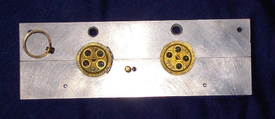

I suppose I should explain that I was planning a RIAA stage, using 416Ds and a pair of globe 37s(!). I did a lot of work and spent too much money on this - yet another of my half-finished projects. As EC8010 wrote, 416D looked very promising; loads of gain, only 2nd harmonic distortion etc. However it does have to be handled carefully as one might expect - and one can also expect some variation between examples.
An example of my approach may be seen in the attached photograph which shows my aluminium-alloy mounting for a pair of 416s; this was precision machined and is clamped together with three cap screws. It is drilled also to accept a large finned heatsink. The brass ring on the left of the picture is one of two I had made to screw onto the anode connection; I had to buy a tap (40 TPI) from California to get this done.
