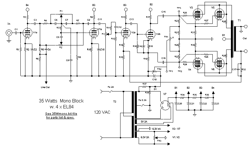

4 x EL84 in UL PP, 470 B+!! is this right
You're right rmyauck,
But it also depends on total resistance Rs, the rectifier sees in the transformer secondary windings. 47uF should be safe, if the transformer is not oversized.
But then there will still be a lot of hum on the B+, that will create 100Hz (or 120 in USA) nasty sidbands on all music signals. At no signal the hum is out-balanced and not audiable, but will modulate with the signal.
A way to overcome all problems and make the life longer and happier for both the rectifier tube and the EL84's, is to put a 8-10 Henry, 150mA choke between the rectifier cathode and the 100uF capacitor.
This will lower the voltage to just under 300V, so ordinary EL84 can be used and lower the B+hum by a magnitude.
There was a tube that was very common in amplifiers in USA in the 60's that was called 7189. It was mixed up with and used as the EL84/6BQ5 as it had much similar specifications, except it could withstand much higher voltages.
IMO, the specs for your diagram was made for this 7189 and not EL84. 7189never had an european equavilent what I know. Nowadays some manufacturers call their EL84's for 7189, despite not having this high voltage withstanding.
I personally belive that the 7189 was not a pentode, but a beam tetrode and then able to carry higher voltages both on G2 and the anode.
Notice that the idle current in this RCAdata book page below, is for two tubes in PP, with a common cathode resistor.
JohanB

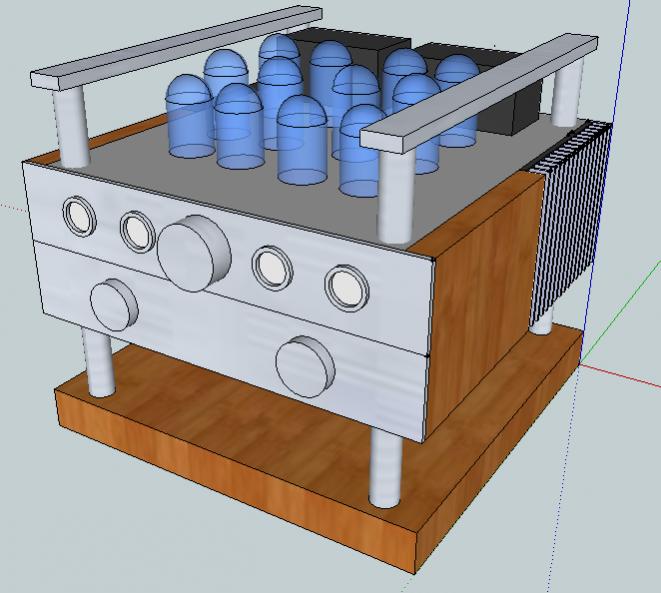

Wow love this Forum, thanks guys for all the great advice. So, final PSU design would look like:
The PSU spec is 360 volts for B+,
Seperate fixed bias supply that is adjustable (LM337),
A nice wad of 6.3 VDC for the heaters.
Throw in a softstart
And finally add a standby switch that drop the heater supply from 6.3 volts to 4 VDC (ala Morgan Jones's comprehensive PS) and we are good to go.
overall design concept attached, will now go away and draw up the PSU Schema, more to follow, very soon.
Don't stabilize the bias voltage in fixed bias ultralinear or triode mode. It should vary as the main fluktuations vary the anode voltage. If you stabilize it, the anode current will be unstable and easily burning your tubes.
I even do recommend to put a zener diode around 12-15V in series vith the bias voltage supply (in the EL84 amp), to make anode current stable to all mains fluctuations.
In an EL34 30W UL-amp of my design, I even have a 24V zener in series with the bias supply, to have a slight negative anode current regulation in the output tubes. This will work over a range of +-15% variations in the mains.
That also results in a constant idle power in the output tubes and they never overheat due to high mains.
JohanB
