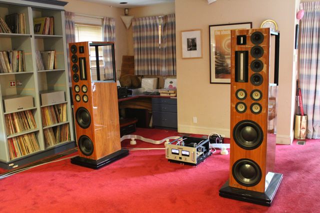

The most famous case for a tweeter array next to a mid-array is of course the Genesis builds.
I think a quite reasonable speaker could be made with a tall AMT next to 4 good mid-woofers. FaitalPro has a number of suitable options, with good extension and high power handling.

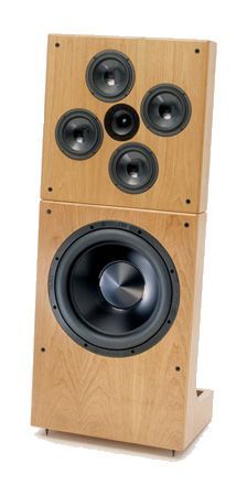

My original intention is to align the AMT's plane to the midrange voice coils vertically. In a MMMMT setup it's easy, in a MMTMM setup.. well, not anymore because when I design the midrange-tweeter box there has to be a dip in the middle for the tweeter where the dip's walls might act as some kind of horn maybe. Okay, perhaps 30° deviation from the flat front plate but still.. (and I'm not sure if it's 30°at all.. if I wanted to keep driver distance small, I would have to count with a steep "wall" around the tweeter which makes the horn-effect even stronger).

Arguably the worst option is to use 1/2 wavelength spacing. Because that will create a null. (Because the drivers are out-of-phase at the xover point, due to them being 180 degrees out-of-phase.)
What? I thought 1/2 wavelength or less was the rule of thumb to avoid lobing?
Isn't this easy to fix by just running the tweeter inverted?
"Arguably the worst option is to use 1/2 wavelength spacing. Because that will create a null. (Because the drivers are out-of-phase at the xover point, due to them being 180 degrees out-of-phase.)"
To avoid a null, you have to compensate by manipulating the phase. That can be done by:
1) flipping the polarity
2) using asymmetric xover slopes
3) using delay
4) all of the above
Any reason why one shouldn't go this route?
What about if the center-to-center spacing is over or below 1/2 wavelength? Say 1/4 or 3/4 of a wavelength.
1 Wavelength CTC spacing is always worse then 1/2 wavelength; the lobing you try to avoid will happen at half the frequency and more lobing for the higher frequencies is created; as close as possible results in the least lobbing.
An AMT/planar/ribbon has a cylindrical wavefront, little vertical off axis response and thus ctc spacing is less important.
