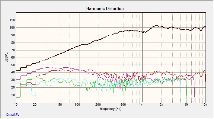

I looked up a couple of (slightly larger) drivers, the 15M I mentioned earlier, and the 4.5" Dayton that Bill Poster just mentioned. These are images from Voice Coil.
The Dayton midbass level was "a 2.83 V/1 m impulse response" (about 86dB) ...and it has ~3% distortion under 1kHz, rising sharply below 200Hz.
The 15M level was "setting the SPL to 94 dB at 1 m (1.16 V) using a pink noise stimulus" ...and it has ~1% distortion under 1kHz, rising sharply below 200Hz.
So: it looks like both units are suitable for a 200Hz crossover, but the 15M looks a jillion times better, with 1/3 the distortion when played 8dB louder.
Am I interpreting these graphs (and signal levels) correctly?
Yes but we were talking about a 4", the 15M is even closer to 5.5". The usual issue is excursion as most of these are designed for sealed use and at higher power levels they`d distort badly if used so low.
SB12PFC has no copper and 0.26mH coil inductance. SB13PFC also appears to be missing the copper sleeve, as with the SB16PFC.
SB12NRX does have copper sleeve, with 0.14mH inductance and obviously lower distortion across the midland compared to the PFC flavour.
Looks like the PFC (cheap plastic) drivers are missing the copper across all sizes.
I always thought the Peerless was very ambitious looking and wanted to try it. I think as a true mid the NE123 looks promising, as does it's larger cousin the NE149.

4FE35 has a copper cap, the 4FE32 uses neodymium magnets and has no copper in the motor. I have used the second in a car install and for the money its a beast. Not sure why some of the Fostex bunch are not mentioned - they have a very sweet midrange.
None of the PFC drivers have copper, but the pole piece is undercut. Very nice for the money with significant 2nd order distortion at an above 2.5Khz.
