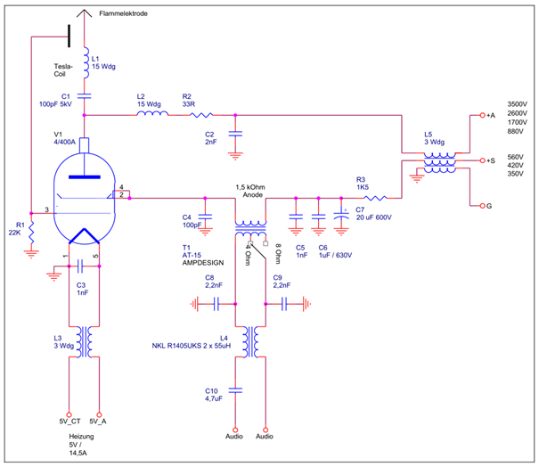

Hello. If anyone can solve or point me in the right direction, that would be make my day.
Basically, what the heck does one need to do or look at in order to make a 4-400A equivalent solid state version which mimics this tetrode in terms of electrical in- and output as well as performance. Since I have no idea, I figured why not reach out for help.

not sure what parameter exactly you want to mimic
I can do better and show you parts of the circuit.

See attached circuit. Its a HF high power (RF output amplifier) and it will be used to oscillate at several MHz which is supplied by a carrier signal in the audio spectrum.
It looks like a light show that follows the music (entertainment purposes?).
Or it is for some kind of scientific experiment.
In either case it is an AM transmitter, and one that has many watts of radiated power.
The laws of transmitted electric fields are controlled by the country where the transmitter is located.
It would have trouble with meeting EMI regulations if it is to be a commercial product.
There are different regulations for intentional than for non-intentional electromagnetic radiation.
In a properly screened room it may have to meet other regulations, including safety.
The way to build such a device with solid state parts (probably in parallel) is to use more current at less voltage, and then use a voltage step up transformation. Either a resonant pi network,
or an RF autotransformer. This will require a complete re-design of the circuit.
You are right, a search will not find an equivalent part. Even if there were such a solid state device, it would probably be hard to purchase in limited quantity, and would cost much more than the 4-400 that it replaces.
