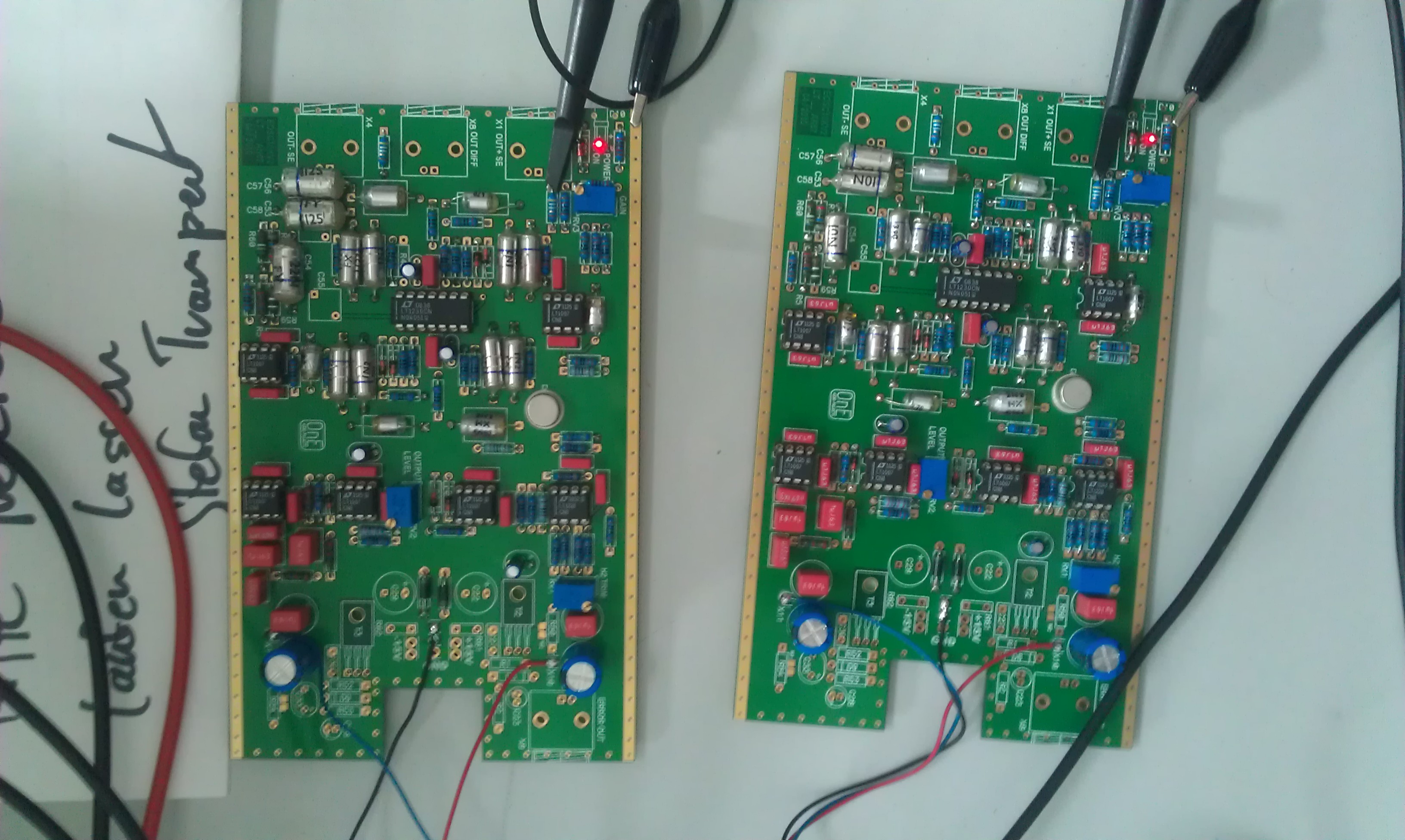

I finished 3 of those boards a few months ago.
I noticed a few "strange" things, that you should take care of.
1) If you are not using Frex regulator, do not exeed +-10.5V. It's not a problem of destroying a component. On my boards the THD turns instantly bad.
2) The version on 3Khz does not have the same performance than the version on 10Khz. Even with a moded stability network around the opamps.
3)Both 10Khz Versions had some stability issues. I wondered, that sometimes the THD was bad turning the board on, and sometimes it was good. The oszillating was only viewable on a very good scope. With my finger as a RCL Network i found the "failure". Both failures were on the controlled side (by the way, the K2 is much more visible on this side). On one board, i lowered one resistor, on the other board i had to put a very small trimm cap on one output (it was very strange, sometimse the scope probe was enought to get it stable).
On all of my tests I used very gut powersupplies from Funk Audio (with 80€ a little bit expensive but every penny worth!).
I compared the oszillator with the Rhode und Schwarz UPV. It was not possible to see any K3 on the screen. With the internal osz. was less noisy. I'll search for the screenshot again.

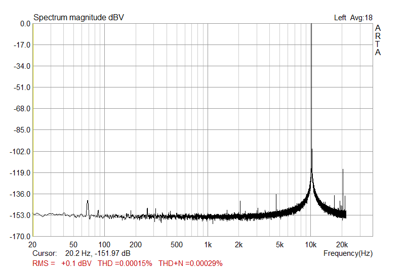

Here is mine....
I finished mine a few months ago and this is what I got. Measured with Xonar Essence STX sound card. The only problem I have is that the other non-sym output has higher THD and I don't know why. THD on other output is around 0.004 or something like that, I don't remember the exact number. I am showing the good output.
0.004% is around -84db? That is exactly what i measured with the instable ones too.

I've finally got round to building my 10kHz oscillator, and am struggling with stability too. I'm using Frex's power supply and have all 3x BNC connectors installed. I can get it to oscillate without saturation, but it's very load dependent and doesn't start reliably. The best I can get 2nd harmonic at about -85db, but there's lots of 1.5MHz and 85MHz noise on the signal. Finger 'LCR' can start the oscillator and change its amplitude, but I've not found a way to tame it to get a good looking signal. Has anyone got any advice on where to start looking? Thanks!
This thing is sensitive to adjust, it took me a while to tune it up. I had a small window on a trimpot for oscillation. Amplitude adjustment was no problem. The final part about second harmonic distortion adjustment described at AN67 note didn't work for me. I found it impossible to adjust THD on LT1228 output using my audio card (since I don't have spectrum analyser). I adjusted THD with one of the output connected to my ASUS card as the whole thing. Also, sometimes, it fails to start. I think power supply is very important. I hope you used at least LMxxxx pre regulators before the Frex' zenner regulator.
