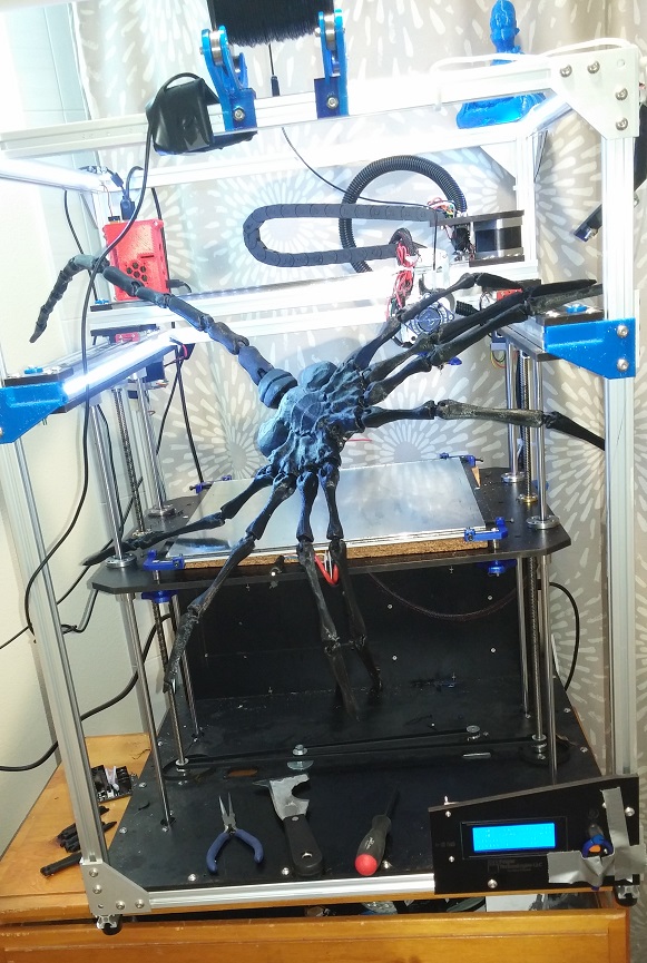

After (if?) I get this working well, I'll probably post a link for the waveguide's STL file. Then it would be possible to send the file to any of about a thousand "3D hub"s to get it printed by them. But I want to make sure there aren't any major "gotchas" first.
