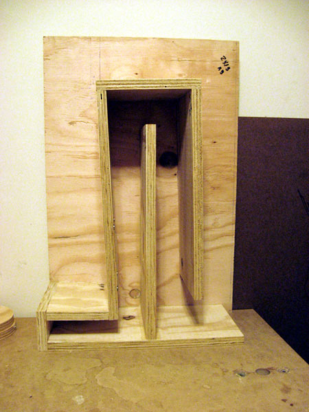

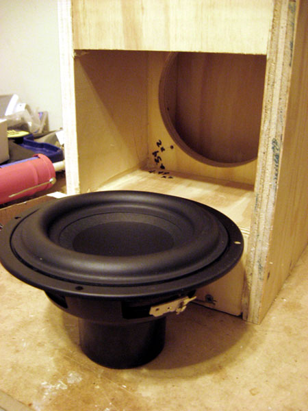

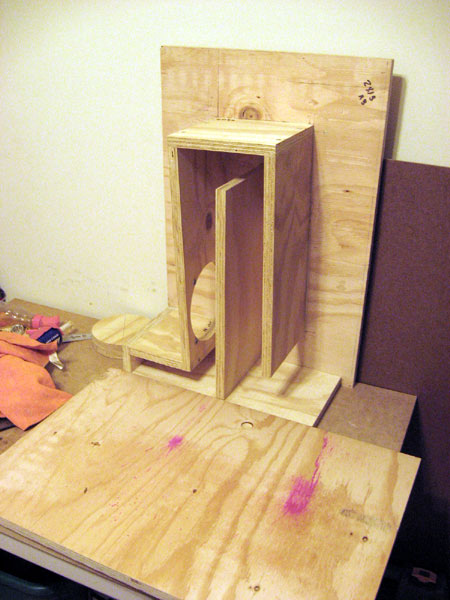

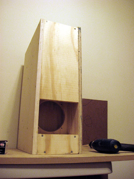

I made a pair of these - I find they sound better with the inductor off.
