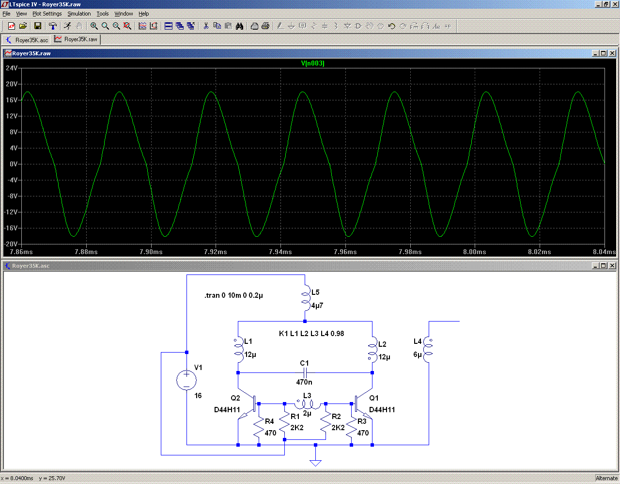

To build my magnetic audio amplifier, I need a 12v AC source running at a frequency of 35Khz. The input into such a circuit would be stepped down 60hz line voltage at 12v AC.
I looked all over the net, and I couldn't find a good simple circuit. I have explored the possibility of building a tiny spark-gap Tesla coil tuned circuit, but I was hoping for something more conventional.
Any ideas?
A Royer converter is simple, robust and gives a good approximation of a sinewave.
It can be made to work from rectified and filtered 12VAC.

That will put out 35 Khz? Or is it adjustable.
I am not familier with such a circuit. Also the mag-amp doesn't nedd (in this case) a dead on freq. The old book I have says 30 khz, and the guy who replicated it used 35 khz.
It can be adjusted by changing the capacitor value, or modifying the gap of the transformer.
The frequency is not particularly stable or accurate: it is a compromise between a pure LC oscillator and a multivibrator.
