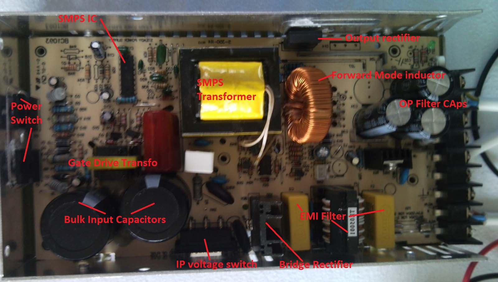

I have a meanwell clone s-350-36, which has broken, IIRC due to crossed speaker cable. I would like to fix it both for use and to improve my understanding. I have tested the defective unit and mapped the voltages across the board

So to me it seems that the most likely broken component would be the small yellow/black part above the space between the two large capacitors, as this seems to have power one side but not the other. Which i believe is a transformer?.
Does this seem likely?

Hi i've seen your post. Am not an SMPS expert but am struggling my way through. That black and yellow transformer is if am not mistaking a gate drive transformer. Its purpose is to provide the driving signal to your power transistor or power fet and to isolate the SMPS chip and driving circuitry. up to now i've blown fuses and power fets while building my SMPS but never that transformer. It cannot be replaced blindly as its custom made for your PSU frequency and tuned for your power switch driving signal
From your voltage mappings(RED shaded tracks) the input section might be OK your fuse does not seem to have blown.
Now normally there are protection circuits in SMPS (over current, over voltage, under voltage over temperature, e.t.c) which trigger in case there could be a fault in the SMPS. They will to keep it simple prevent the psu from turning on. if you are getting voltage on part of the drive transformer it could be one of your power switch or both has failed. POwer off the circuit, let the mains cap discharge and check these switch.
For your info two very important points, that PSU you have here seems to me like a half bridge. You can search on this on the net and get tons of info on how it works.
Last but not least to built or repair a psu an oscilloscope is needed, its really hard to deal with SMPS without one handy as all the problems in an SMPS can only be diagnosed through the waveforms its producing
I have labelled some of the sections from what i could recognise visually in the attached file

I really hate trying to trace faults from pictures but... it looks a bit like you've measured voltage on one side of the main (larger) transformer, did you not continue trying to measure voltage on the other side, or was there no voltage present? See if any voltage is present on the output rectifier's pins.
