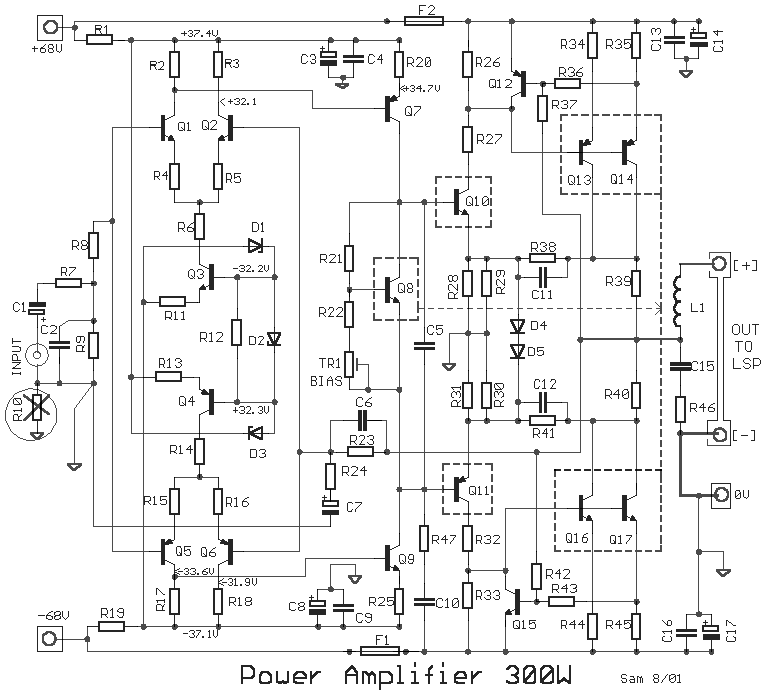

Power 300 Watt Amp
What is noticable
is that it uses Output Stage where
the Output is taken from the Collectors of the transistors.
So it uses some voltage amplification in the output stage.
Does not have to be bad.
I wonder what transistors are used.
In the input and the output?
here it is:
Q1-2-3= BC547
Q4-5-6= BC557
Q7-11-12= BD140 or BC640
Q8= BC549
Q9-10-15= BD139 or BC639
Q13-14= MJ15004
Q16-17= MJ15003
Very nice :cool: for us "homebuilders"
This is transistors that are very easy to find
in every part of the world.
Not often designers think of that.
If we use unusual and very new transistors, =exotic
it can be very difficult to replace, if something goes wrong.
Designs for DIYselvers should consider
how a potential builder can get the parts easy.
A common factor of Very Popular Successful amplifier-projects
is that they use semiconductors that belongs to "the mainstream"
of production, by the BIG manufacturers.
So this looks good to me.
But I will never need a 300 Watt Amplifier.
Never more then 50-100 Watt, in worst case. ;) ;)

Yeah, Halojoy, using easily available components is indeed a good design-objective - especially for guys like me who live in a country called India. Only the 62V/5W zener (D2) seems bit of a problem to find, if at all. The circuit seems quite well designed and notably, symmetric.
The protection scheme uses both voltage & current sensing (R36 for emitter current & R37 for Vce), making it 'load-line' type of protection, which is definetely a step above the constant-current 'clipping' type of protection mechanism. The load-line cover helps exploit most of the SOA of the power devices, while still protecting them from breach of PD(max) due to a terribly reactive loading.
However, I find that only ONE of the two output transistors on each side is sensed. This would put a greater emphasis on matching, IMHO.
The BD139/140 at the driver stage gave me a bit of discomfort at first (as they are 80-volt devices), but then I saw the mid-point of R29/R30 grounded hard, so each of the devices is never likely to see more than one of the supply rails. This is possible because of the collector-coupled output topology.
One thing that I can't figure out is the R10 with a 'crossed' circle around it! Any explanations?
Please take a look at this one's power-supply schematic also: it uses a resistor in series with the transformer-primary to limit the surge current, which becomes quite a bit for such power levles! The resistor is shorted by a relay-contact after a delay.
Cheers
1.If the amplifier have no more 2x500w/4ohm it work very well without the soft start .
The only problem may apear if it a large number number of amplifier will start in one moment ( sound reinforcement or P.A )
2. For home use a 300W amplifier will beat every high-end 60W amplifier. ( THD , Noise , Dynamics etc. ) . If you don't belive that , just make a test . Put a 60W amplifier on left speaker and 300W on the righ speaker and run both at 30W. After that try to give a 6dB bass or some loudness.
3. Conclusion ? Well , it may be interesting to know some opinions !
djdan
djdan:
You see that this R10 goes to ground.
Now there is also a direct connection to Ground.
So you can use either option.
Start with direct ground.
Sometimes you can get "hum" or a ripple from 50Hz AC.
Then you can try the other option, with R10.
this is usuually a very low value,
like 10 ohms and below.
The ground connection and how/where you connect Ground
to the Chassis, is important in most power amps.
We do not want "ground-loops", so there should only
be one rail going to Central ground.
There are several good articles on the Web,
that gives advice about grounding considerations.
Regards
halo

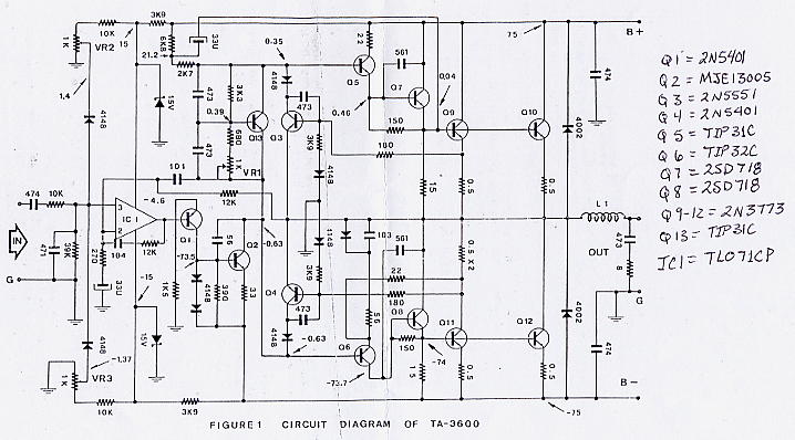

If you dug that amp, you may love this one. I have built 7 of these from kits and use them in my home theater setup.
Specs 300WRMS into 8 Ohms! +/- 75V rails @ 8A
Measured 242WRMS into 8 Ohms resistive w/sinewave input
368WRMS into 4 Ohms resistive w/ sinewave input
I think, with a bit better capacity of power supply, I'd get 300W into 8 Ohms.
Chris
