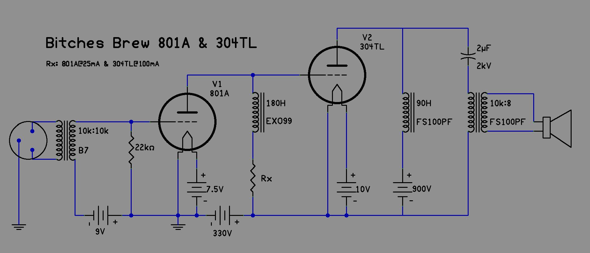

I have two separate PSUs and they are stacked to avoid the large biasing resistor for the 304TL (just think to the Loftin White and variants). The EXO99 choke and that Rx are fixing the bias for the 304TL, to make it more clear
801A grid:-9V
801A cathode: 0V
801A anode=304TL grid: +280V
304TL cathode: +330V
304TL anode: +1200V
The OPT is returned to the 304TL cathode.
I loved that amp but I am not using any more 304TL as they were way too hot
In the same amp I used GM70, 813, 304TL and 75TL. Going to give 845 a try soon.

How about posting your schematic.
grazie e buonna pasqua!
Gianluca
Sure. 801A was running at 20mA.

this is my 304TL amp
Rx sets the bias for the 304TL. You need two separate PSUs and, what else?, yes heating the tube is not an easy task.
Good luck with the OPT, not easy to find a good one.

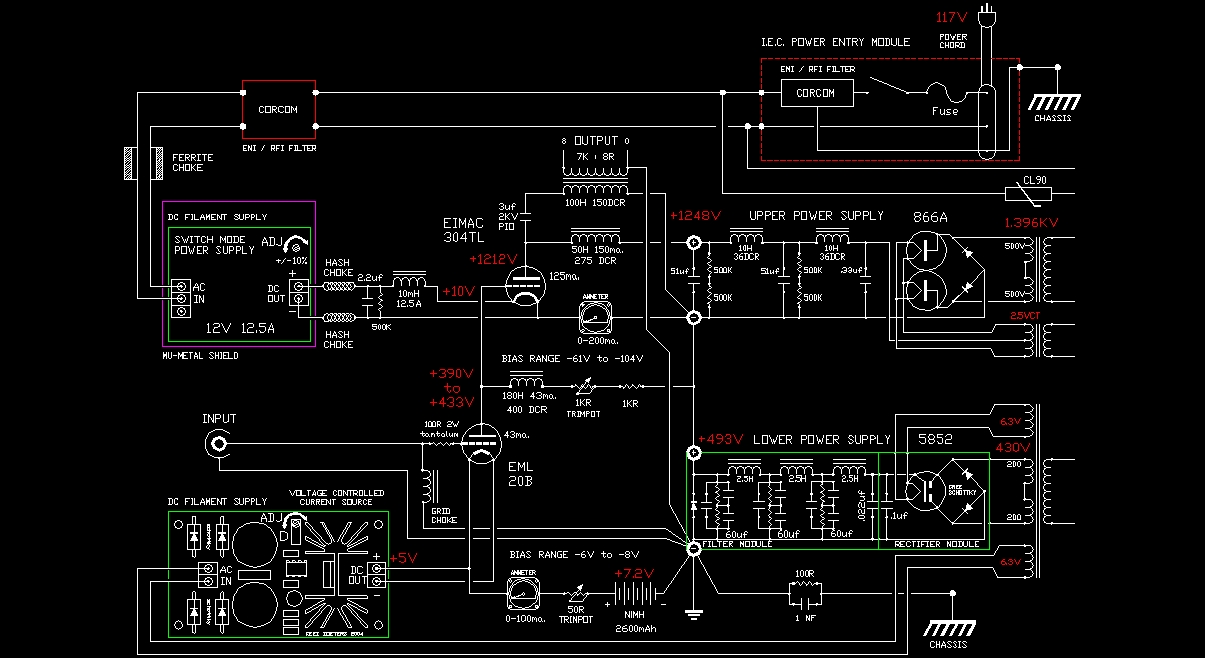

Hi Gianluca...I am loving my 304TL as well but not so much now as it's not working The Croatian gentleman who built this amp said that this is a technicians' amp and I understand why. Getting someone to service this is very difficult and getting a custom replacement power transformer is almost impossible...I am still researching this. The designer (Kruno) was likely nearing his 70's, if not already in his 70's when he built it and he owned it for 4 years with no issues. When he placed it up for sale, I happened to see it and had to have it!!! It looked so sexy and beautiful...I fell in love...LOL LOL! He seems like a very practical hands-on kind of designer and we are still in communication. He redesigned the power transformer and that is what I am trying to have manufactured now. I live in Canada and no one here can help me...I am now searching within the United States.
I've attached some files for you to look at but only really to satisfy your curiosity perhaps? The second attachment is what I send to a transformer manufacturer to get a quote.

Hi petertub, thanks for your input. I talked to my technician about a switching power supply but we decided we may go down that road if I can't get an updated power transformer. I think old-school may be the way to go as I don't want to modify the chassis. I am not a technician so I am only guessing that reply.I saw the transformer spec.
If you have the 5V filament's powered by a switchmode power supply it rest is
very much easier to find an "stock" transformer.
I used a "mean well" SP480-5 . This can supply 85A @5V , if not cathode bias is used
it can power both 304TL tubes.
hello - I am interested in building 304TL SE amp and found your schematics with 6J5 driving 304TL... How is this combo been working for you? Have you changed output transformer? It looks like your new xformer has 1.5kV winding I assume to power 304? Is 6j5 going to be able to provide enough drive for this?Hi Gianluca...I am loving my 304TL as well but not so much now as it's not working The Croatian gentleman who built this amp said that this is a technicians' amp and I understand why. Getting someone to service this is very difficult and getting a custom replacement power transformer is almost impossible...I am still researching this. The designer (Kruno) was likely nearing his 70's, if not already in his 70's when he built it and he owned it for 4 years with no issues. When he placed it up for sale, I happened to see it and had to have it!!! It looked so sexy and beautiful...I fell in love...LOL LOL! He seems like a very practical hands-on kind of designer and we are still in communication. He redesigned the power transformer and that is what I am trying to have manufactured now. I live in Canada and no one here can help me...I am now searching within the United States.
All the best to you Gianluca! Happy Easter!
Hello Superhik, my technical abilities are limited unfortunately but I can talk to you about this amp privately if you like and let you know my thoughts? My personal email is wgs"at"outlook.com. Perhaps we can talk if you would like to leave me with your phone number...provided you are in Canada or the US?
