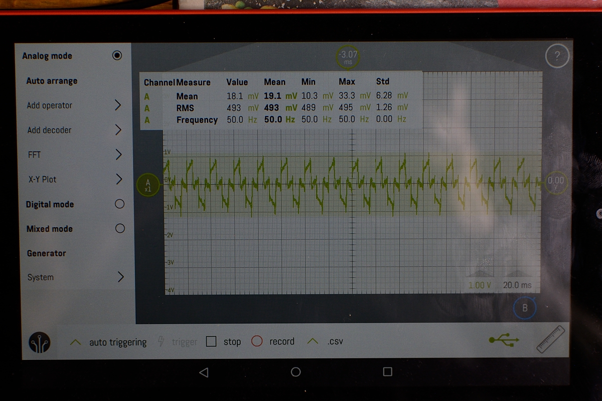

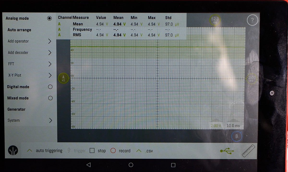

I have attached a picture of the scope screen. It is 50 Hz noise....1V pp.
How can it be 50 Hz?
It fits fine with what I hear in the speaker......it sounds like 50 Hz.
If it was the 7805 regulator ripple it would be 100 Hz?
Think the 5V DC is my main problem and I should concentrate solving this first.

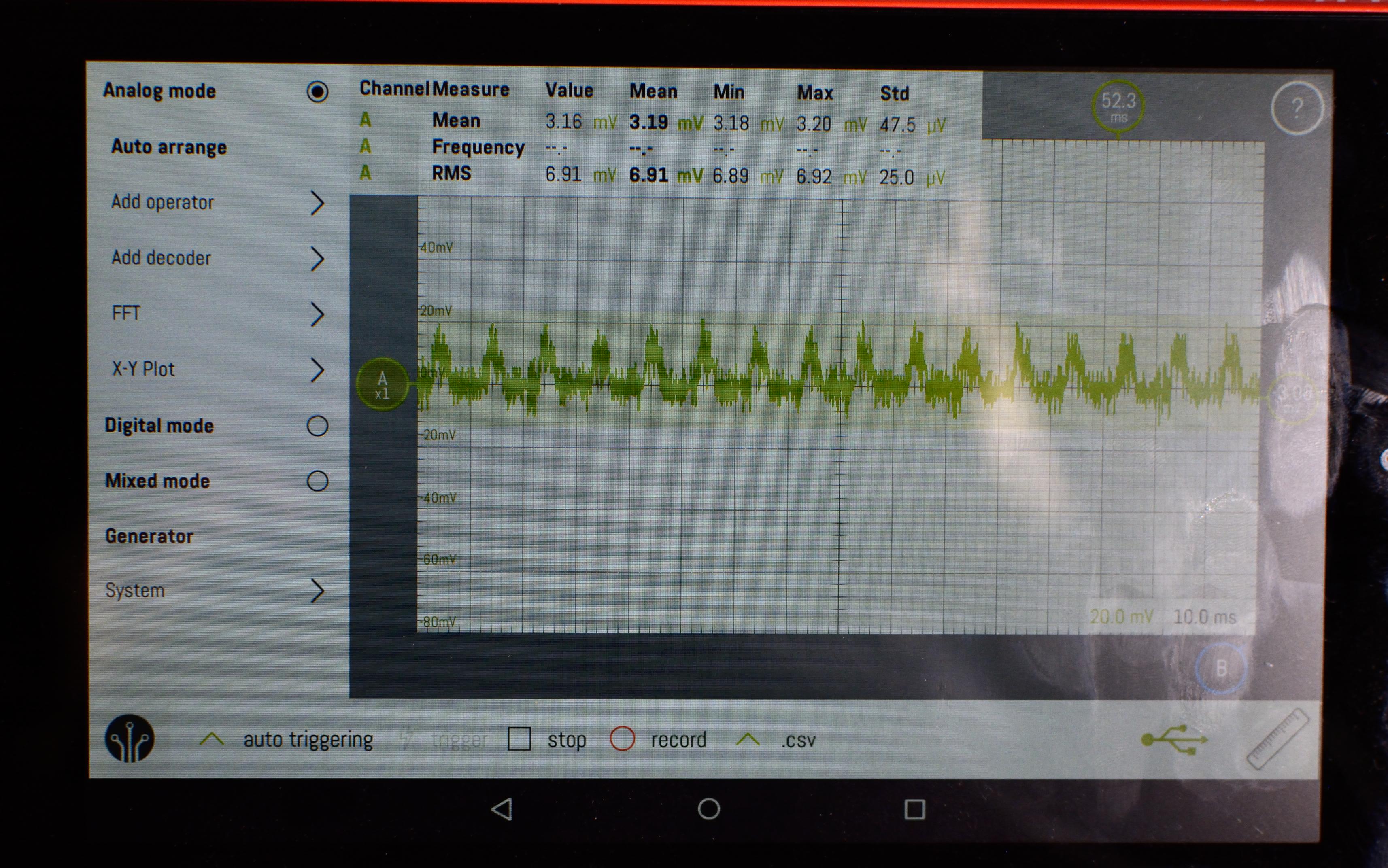

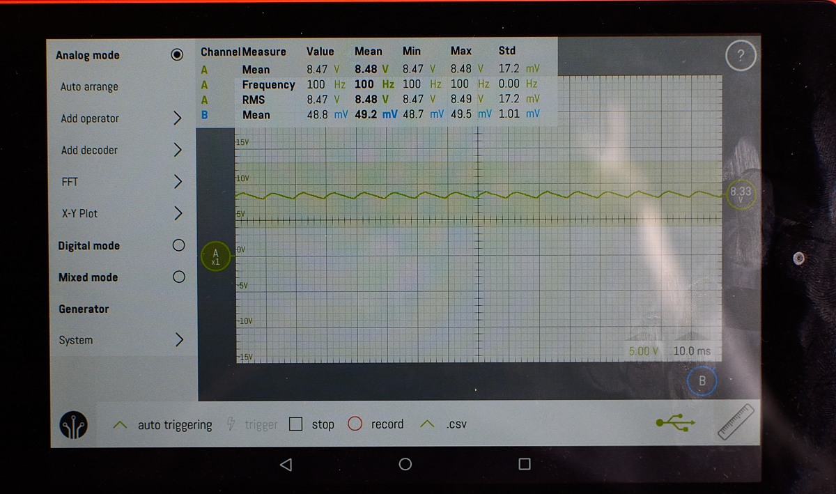

I think the measurements from yesterday was not right. The probe had a bad connection so it picked up hum from the mains. I saw this also tonight.
I have made new measuremens which are more correct.
Measurements are:
Input to 7805 in both DC and AC mode for left channel.
To my eye it looks ok.

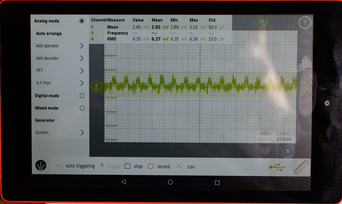

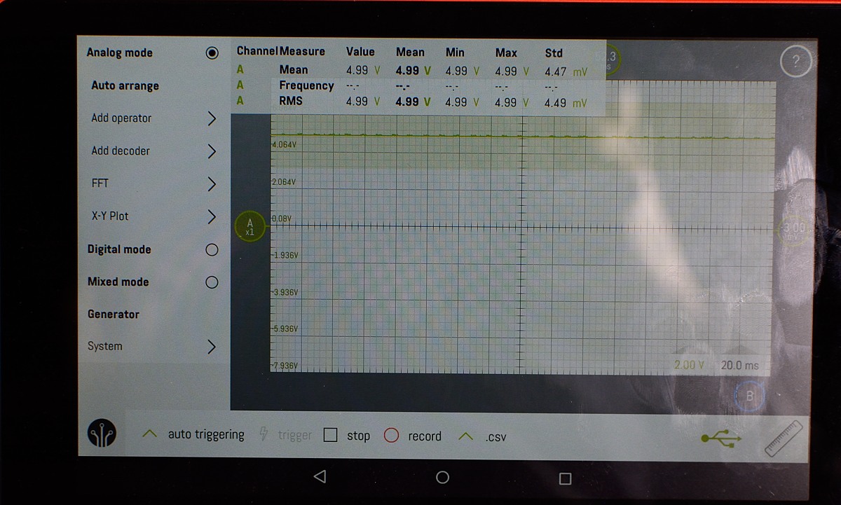

300B filament in both DC and AC mode for left and right channel.
In AC mode some noise is visible. Should it be less?

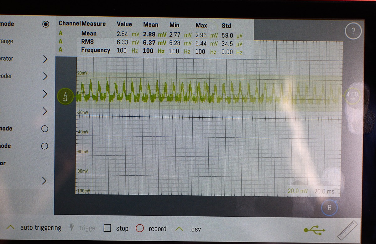

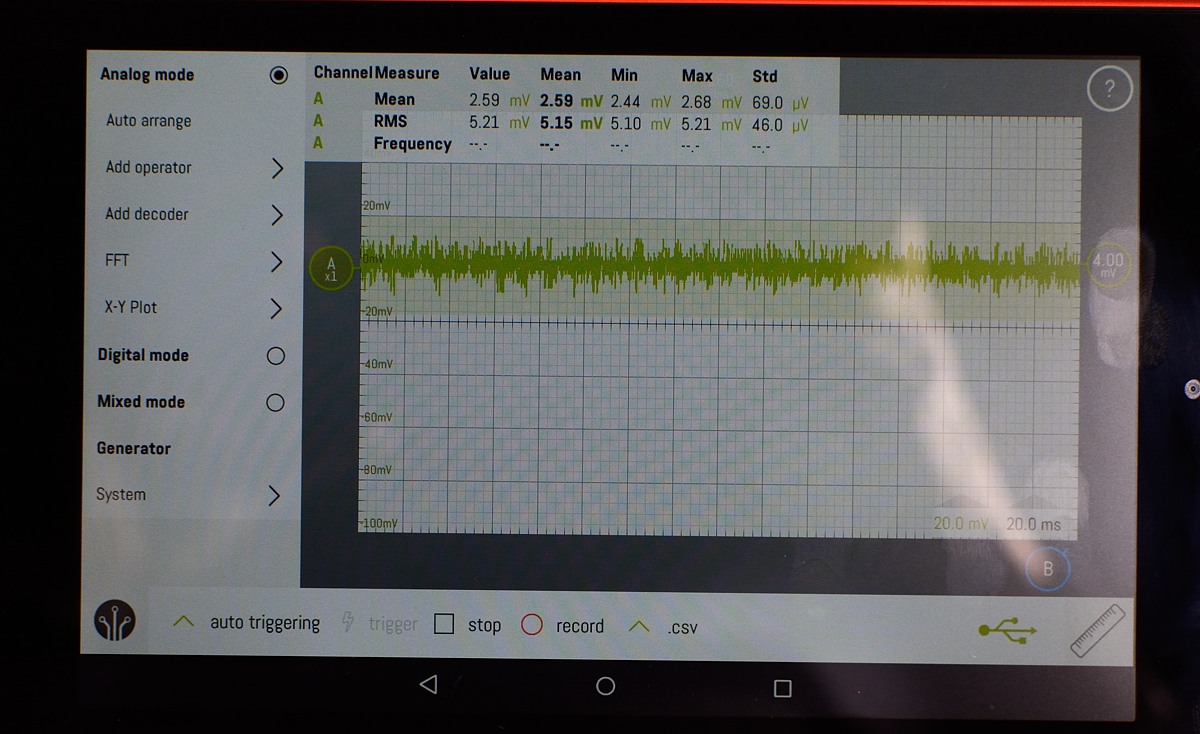

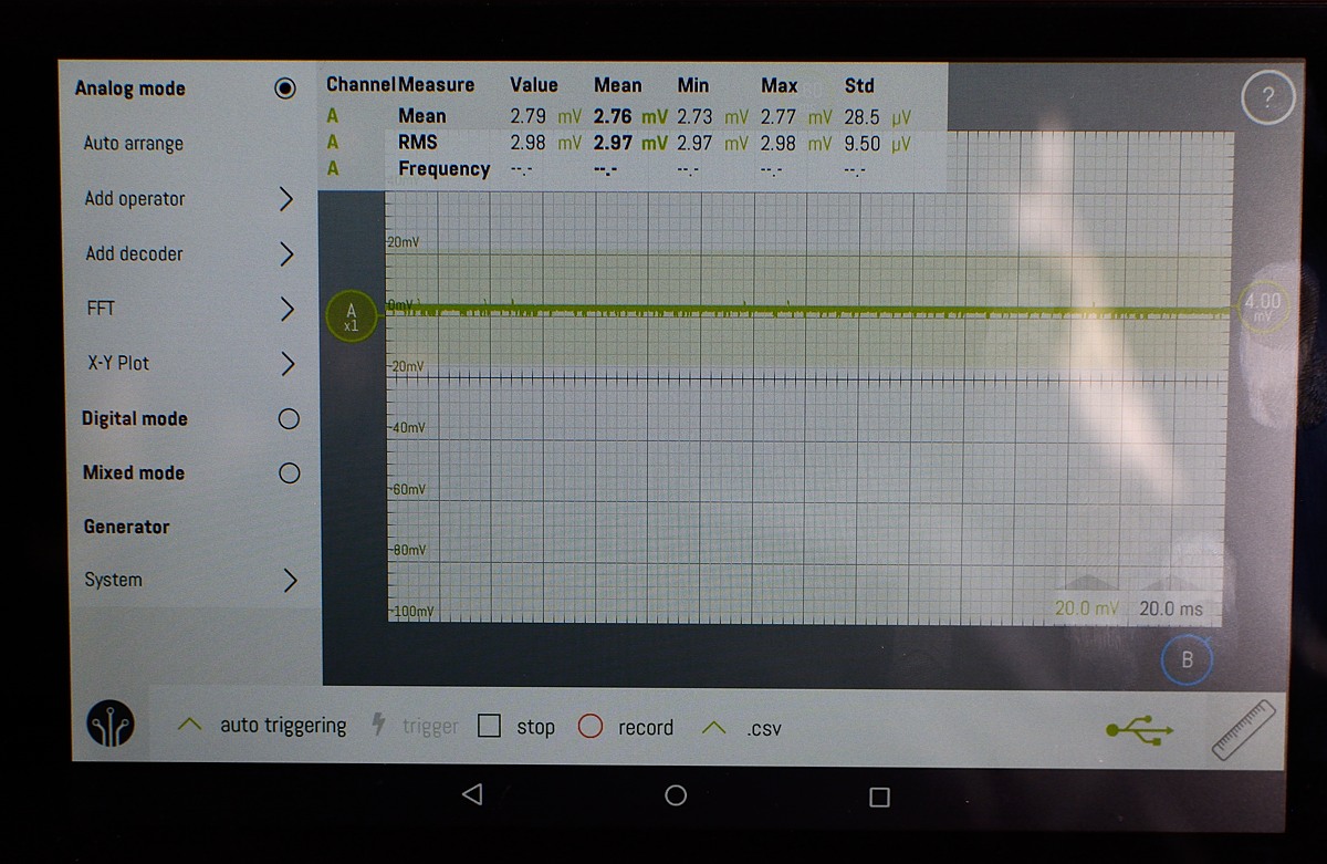

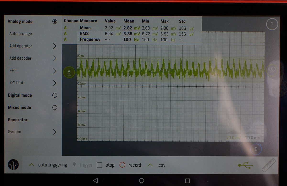

Some results after the bundle has been broken and 400AC wire pulled away from the others.
It seems the noise signal is a bit cleaner as the scope now can measure 100 Hz.
All measurements are with probe on 300B filament.
There is a measurement with no power cord plugged in.
Then there is a measurement with only power cord plugged in but no power on trafo. It seems there is a bit of noise before the power trafo is turned on.
Chassis is connected to safety ground and cord has safety ground but no saftety ground in the installation (normal here not to have safety ground in the living rooms). So safety ground is "floating" in the power cord). Can that cause hum?
I measure with a headphone box connected as this has 2 x 8.2 ohm resistors. When I connected the headphone the noise signal was reduced a bit.......why? .....the headphone is a very small load compared to the two 8.2 ohm resistors.
It seems the hum is a bit less.....subjective when I took the headphone on.
Maybe a re-wire project can reduce it further.

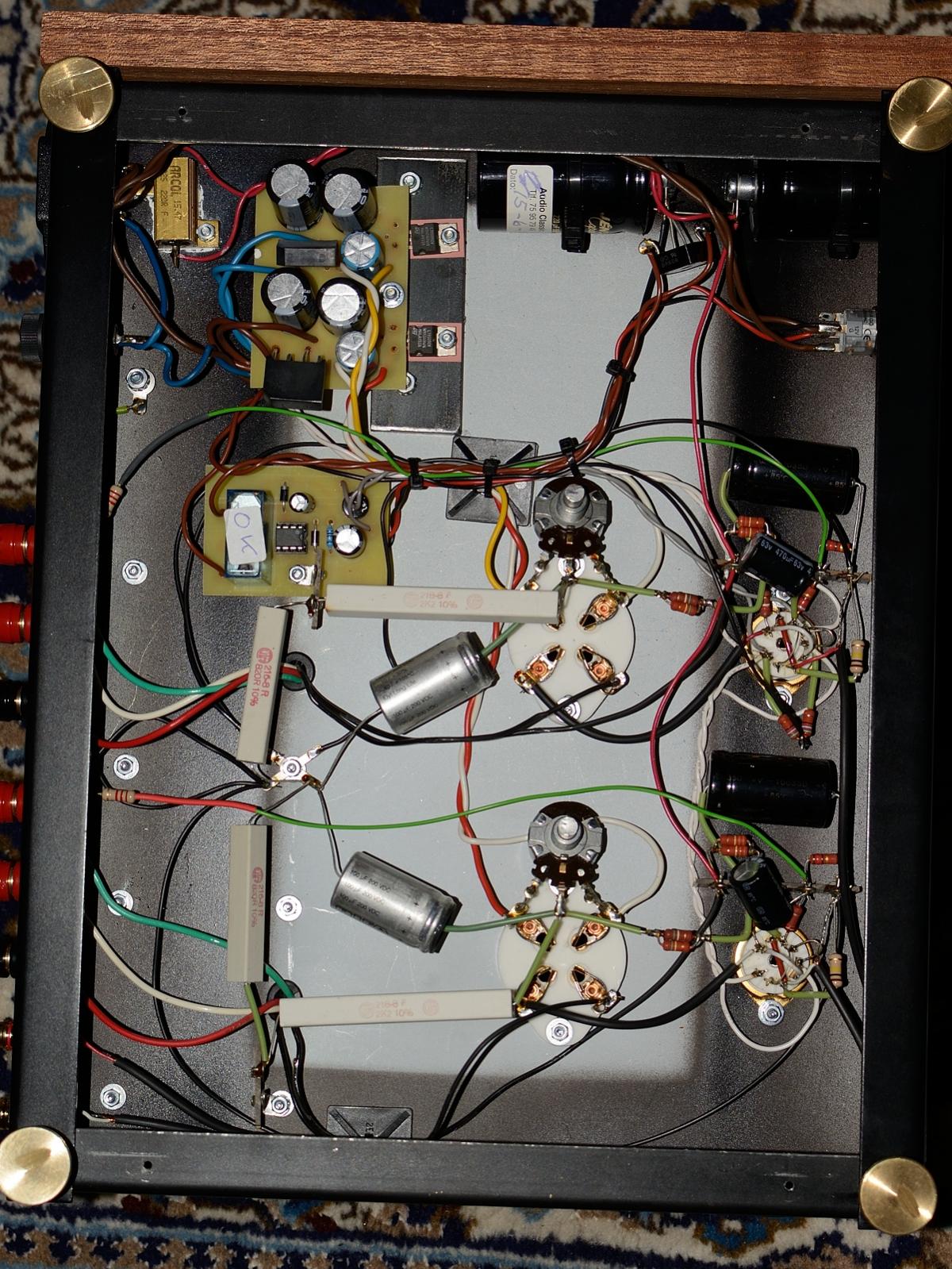

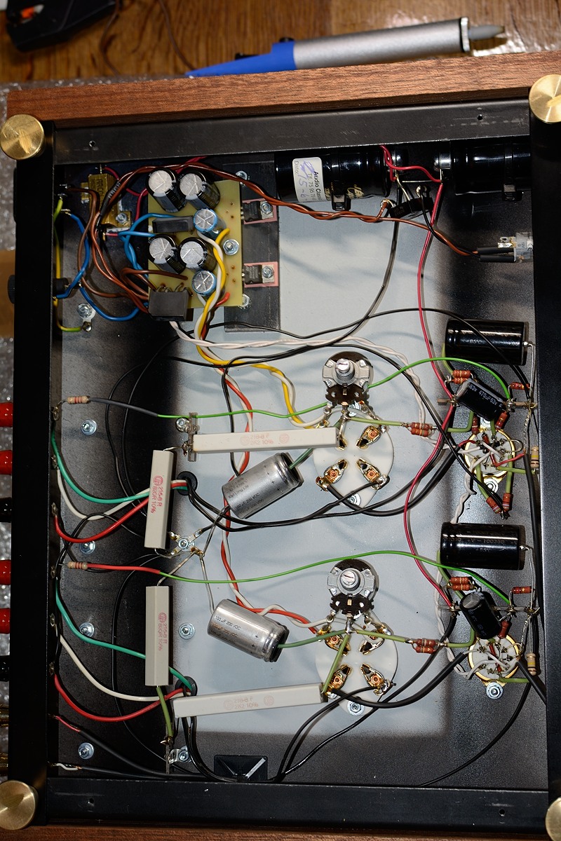

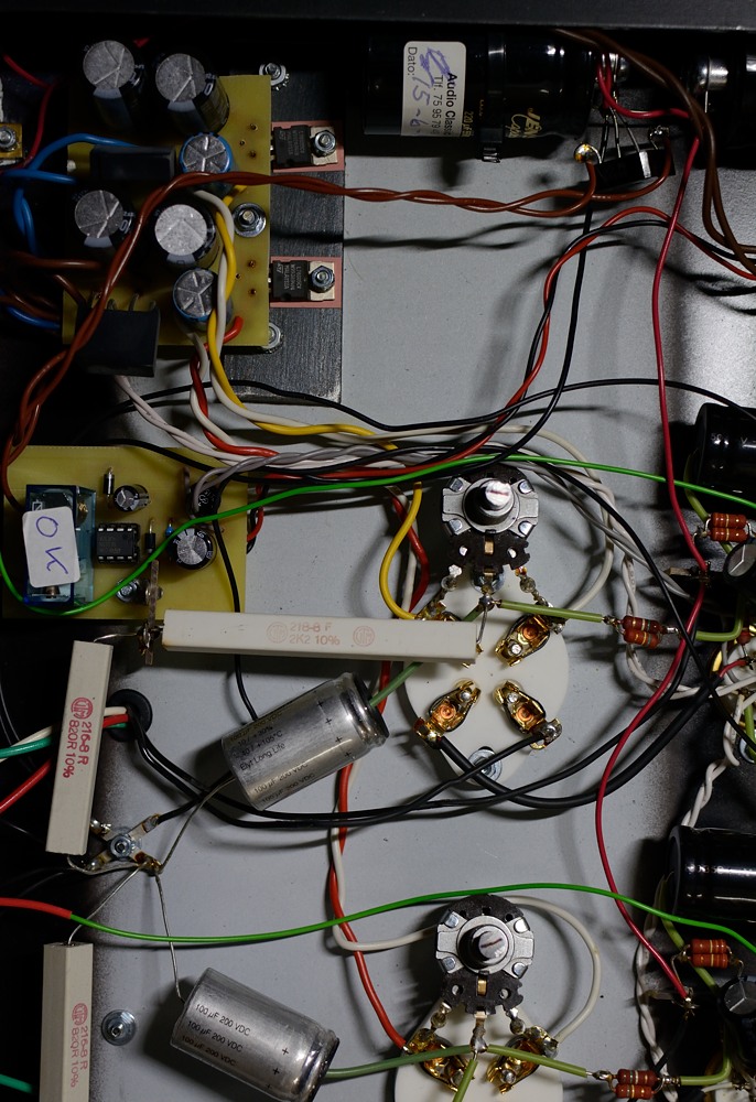

I finished first part of the re-wire project. A picture is attached before and after. Think it looks "more correct" now. Will test it tomorrow. I removed the "soft start print" as this was "stealing" power from the 6.3V heater via the quite long gray twisted wire.
I now use the "on/off" switch to manually with on the high voltage. The heater voltage are switch on as soon as the power cord is connected. I wanted to make it as simple as possible.
I know that the switch on the front which before was the main 230V AC switch should be a 400V AC version. But I assume it will be ok for testing as the 400AC only is about 200 mA (probably less). The switch is rated 250V AC/ 5A.
We will se what happens and interesting if this rewiring causes less hum. I expect there will still be hum and that I need to switch to more "silent" 5V DC filament devices for the 300B and maybe need reduce the ripple on the high voltage.

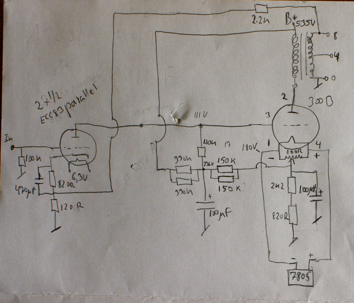

I have added a simplified schematic. Can anybody tell what the purpose is for the 2x150k from the cathode of the 300B? I can see there is a "DC purpose" defining the anode voltage for the ECC83 but what is the "AC purpose"? Is it a local feedback loop for the 300B?
There is only a dc-purpose for the resistor network: The 100µF cap means that there is only a dc voltage at the bias-node. There is no ac-feedback.
I think it was a problem that one side of the primary of the OT is floating. I have measured that it picks up some 50 Hz noise. Think I need to insert tubes or ground the floating end of the primary via a resistor. I may try that or just insert the tubes to test the new layout/simplification of the wiring. Will do that next week. Now I know that everything is ok after the "re-design" with manual delay of B+ via an on/off switch.
Thank you for the answer. I am still new to tubes so a steep learning curve. The AC signal path of the 300B from the anode to cathode is via the 100 uF capacitor to ground (I know the electrons are going the opposite direction)?
The purpose of the 2 x 150k must be to define the anode voltage for the ECC83? .....in principle this could have been done without involving the cathode capacitor of the 300B (e.g. just finding the right resistor divider from B+ to ground)?
They way it is made........could it be to "out-cancel" ripple for the anode voltage for the ECC83? .....if there is some ripple on B+ then this will be in reserve phase at the 300B cathode? .....and then the bridge with 2x330k / 2x150k will reduce the ripple for ECC83?
It's a better circuit than just setting up the driver's anode voltage. The resistor network also allows the driver triode ECC83 to help stabilise the 300B anode current. (If the 300B draws more current, the ECC83 anode voltage increases, and the driver then increases current, lowering the 300B current).
This dc-stable configuration of driver and 300B output has a big advantage: it allows dc-coupling between driver and 300B grid. Many power-triode designs use capacitor-coupling to the grid, which easily leads to the capacitor acquiring dc-voltage during large-signals. (web search "grid blocking distortion", for more).
DC-coupling solves the blocking distortion problem more simply than adding a power-FET grid driver, and reduces the risk of grossly overdriving an expensive 300B. But, at the cost of the very high anode voltage supply.
