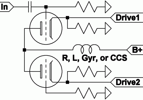

Well, if you ever wanted to pioneer something unconventional....
Long Neck Pair of 6AS7 or 6080 low Mu Triodes ought to do it.
