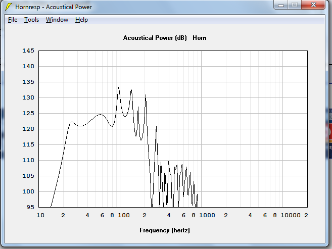

i came up with something along these lines. 2pi sim, vc's series, 2 drivers parallel:

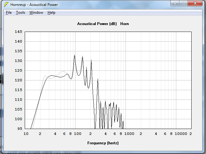

Patrick, I really like that design but yep I want lower response for HT. Impressive results! You're right the 15 does work. Black is 15 and grey is the pair of 10s. This design is also really dangerously close to kinda my goal here for PA too. 140db @ 30hz with 4X boxes (single 125db) in a slim cab. Curious if shortening the path with say a 36x36x17 box would do it.
My sim is from post 21. Yes, it is definitely enough for a build but I like those little cutsheets so you can figure out best way to cut and estimate material. Did you use Alpine drivers? That looks even better. Honestly, not sure how to fool with changing VC setups in HR.

do a search for cutlist generator...free program from years ago...there are other free online tools as well. the sim I posted was for a pair of Alpine sws 10d4s in a 34x45x17" internal box. I have a sim for the 15 on my laptop, I can post it probably sometime this weekend. my enclosure layout is a bit different from Patrick's though.
playing around with VCs in hornresp is more about the inductance imo. as Patrick said before, the box is pretty forgiving of driver parameters etc, I'm thinking of building one for a pair of 12s or even a couple 10s I have laying around.
