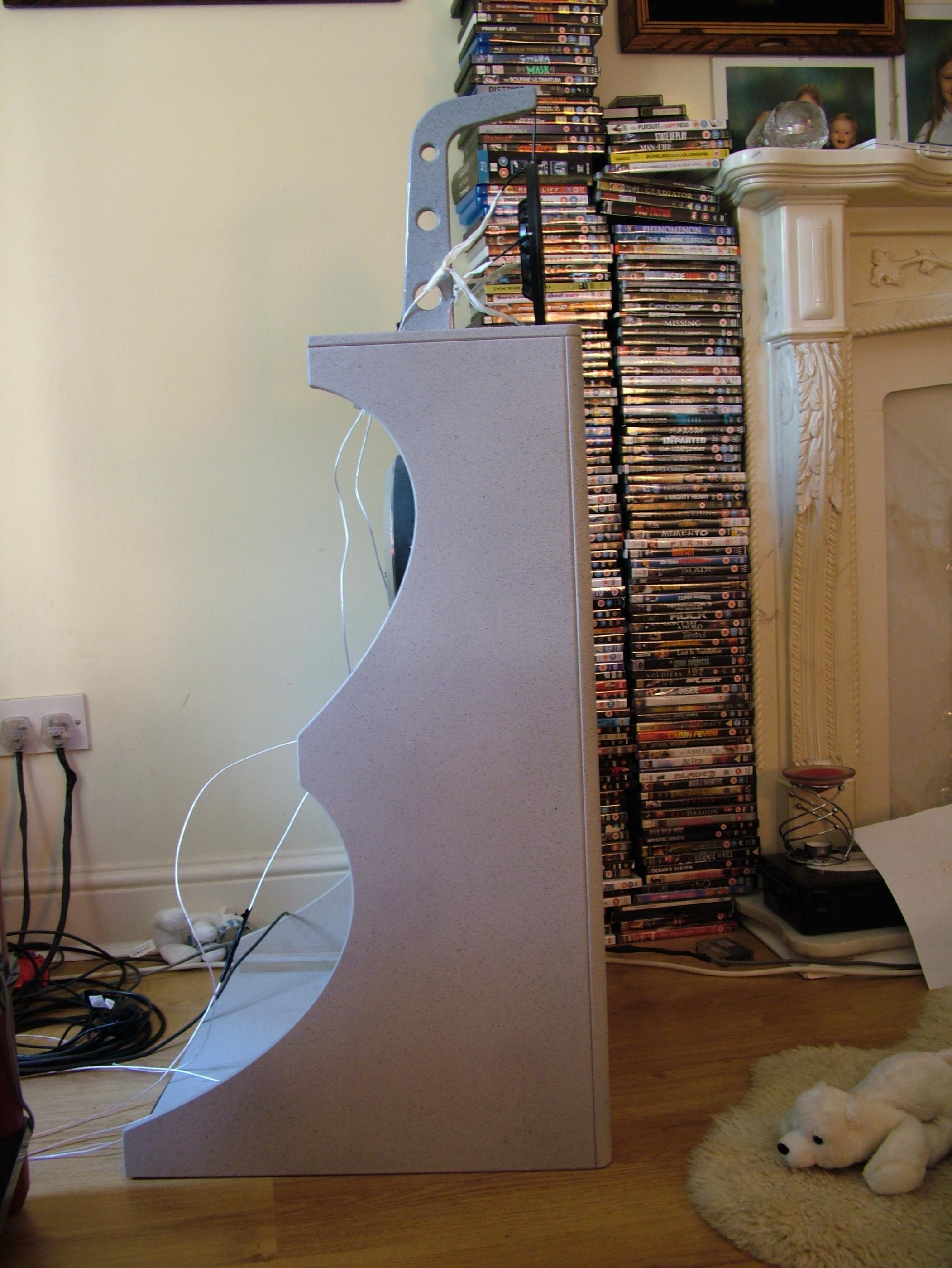

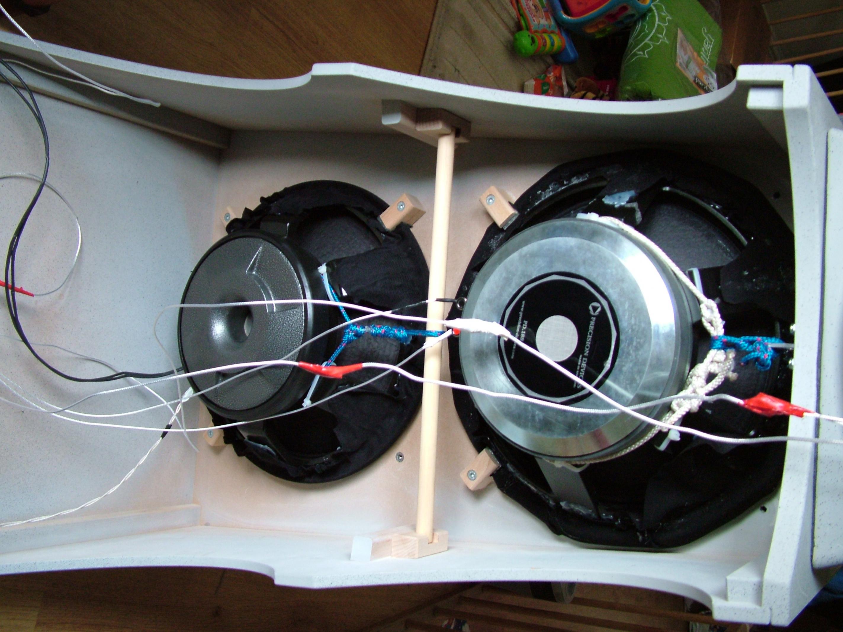

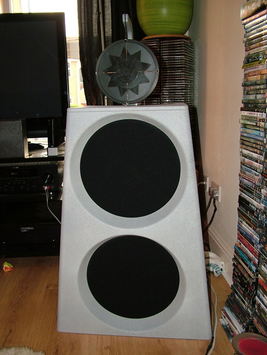

Big Midrange...See yours and raise you 3!!
These beauties (? in the eye of the beholder and all that!) use the 15 inch Precision Devices PD158 in a VPL open baffle from 100Hz up to 800Hz with the Manger running " naked" above that.
The Manger actually sounds better in a small sealed rock sold egg shaped enclosure, but thats OT here.
The bass was a 15 ich Beyma SM115K ( GREAT value!) or the even better, but twice the price, Precision Devices PD 1550.
Running in the VPL open baffle, I found the 15 inch PD 158 could run all the way up to 800Hz before it started to sound a bit" thick and cloudy" , but WOW what impact and transients...Drums and percussion make you blink and grin big time!
When mounted in a well damped heavy sealed birch ply box of 30 litres If the PD158 could only go up to 400Hz ish beforethe sound started to "close in".
Cheers
D.
