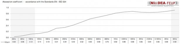

I'm not sure that material would have the same sonic characteristics as rockwool or polyfill. It sounds like it could become reflective at some frequencies if it's made of shredded plastic.
I think you should be looking more (google for your local area) under sound absorption and soundproofing products not insulation. Some of this are also of good use like rock-wool used in the construction industry. If you understand the concept (different in the case of BR and sealed) it will be easier.
Now to be practical and only as an example of many, adapt to your case
1. A layer against the walls of a thick material like "acoustic grade rock mineral wool slab"
Acoustic Rock Wool
or Vicoustic Vifoam 40mm/Vicycle (both alternatives to mineral wool)
www.vicoustic.com
I personally like to use the Vicoustic Vicycle type
2. A material like bats of (real/organic and the most effective) wool as filling material and sound absorbent, also the same as the "30 mm polyester damping sheets" (you can buy everywhere).
http://jantzen-audio.com/image/accessoreis/Jantzen_Audio_Denmark_-_Damping_materials[1].pdf
