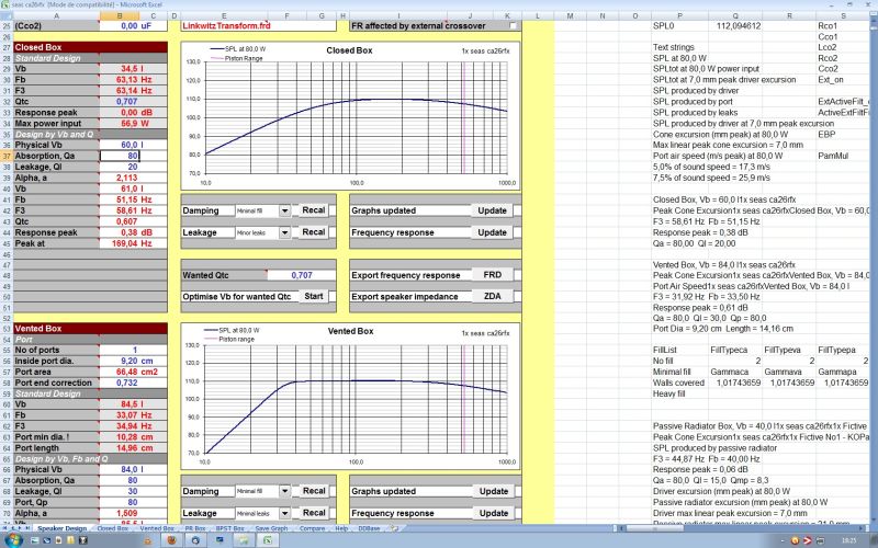

ok here is my proposed final design... for the bass section
interior volume 58.75x30x50=88.88liters
length of port: 107.58
port entrance and exit: 13.75x13.75
tuning at: 24.3 hz (requiring final volume of 80.5liters)
8.38 liters being left for driver, 2.5*2.5 cross and T bracing. and padding
external dimentions high=80 wide=35 deep=55
all wood 25mm ply (or mdf) all corners rounded off nicely
here is a rougth scetch up (please excuse my poor angles and reprensentation)
and here is the sim (yellow line closed blue line vented)

are my calculations, and curved port length, in order?

it is still the H1305-08- previously i entered the parimiters for the other one, because i had the wrong pdf open. a very noob mistake. so i went back and updated the imput fields for the H1305-08. however i left the name in the program as h1305
the sim on the previous page is the H1305-08
I'm confused. What driver are you referring. (SEAS CA26RFX_H1305) The one mentioned says +/-2 KHz.The relatively high Le makes the driver roll off as soon as 300hz.
I am also contemplating to buy this driver for use in a closed box.
I entered the parameters into Unibox .The relatively high Le makes
the driver roll off as soon as 300hz. So, if you intend to cross it
over at 500hz you'll have to take this into acount.
