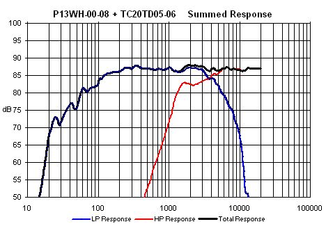

I'll show you some acoustic slopes on various tweeters using some example speakers that have been built.
Even though it is the acoustic slope or order we are after in the end, I think it might be worthwhile discussing using the electrical crossover slopes as that's what everyone can see in the physical crossover. To see the actual acoustic slope you have to measure or model which you can't do when reading a post. We know that the 1st order electrical will give us BW2 or LR2 or whatever acoustic slopes, but not always as some tweeters shelve which in turn give less than 6dB slopes. What has not been mentioned is some of the benefits of 1st order electrical such as being constant voltage, phase etc (there is a good article on 1st order series by John Kreskovsky and yes, he talks about 1st order electrical) but requires certain criteria to be met to pull it off such as driver offsets.... alignment.
I've heard Andy's speakers and in fact on Friday heard the Rocket which was a real blast (no pun intended). There was no hint of the tweeter being distressed at any point and this speaker uses 1st order electrical filters with the SEAS 27TDFC. Common sense as well as Vance Dickason tells us to cross over the tweeter 1.5 - 2 octaves above the Fs as a minimum and Andy has these at over 2 octaves above the Fs.
There are 2 things that have stuck in the brain since I started designing speakers. The first is to use the minimum crossover that will get the job done and the second is to choose your drivers wisely to suit the application and filters.
My crossover of choice these days is the AR series crossovers which do give around LR2 acoustic slopes.

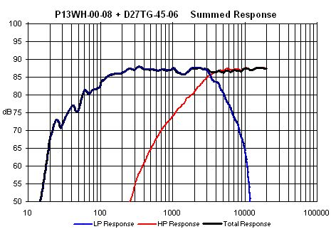

This is a speaker that is from the diyAudio reference speaker thread.
http://www.diyaudio.com/forums/showthread.php?postid=1005310#post1005310
This is the response of a Vifa D27TG-45-06 (also D27TG-35-06) using a 1st order electrical series filter. At Fs, the tweeter is down around 20dB which is a good place to be.

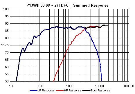

Now swap the tweeter for the SEAS 27TDFC (one of my favourites BTW).
Close enough to being 25dB down at Fs.... pretty cool. With the 1st order filter plus the natural driver roll off gives us great suppression at Fs.
Zaph used it in a speaker crossing over at 1700Hz (2nd order electrical) and made this comment:
Large MTM's need a tweeter with high power handling, low Fs and low distortion in the range of 1500 Hz and up. Not a whole lot of tweeters can claim that, particularly in the $30 range, but the Seas 27TDFC is up to the challenge.
It's a great tweeter... I think I said that before.

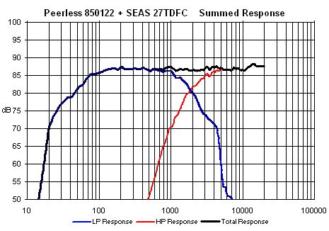

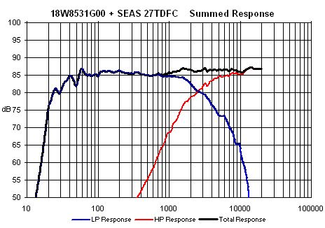

Here's a 27TDFC with a 18W8531 designed for lazyfly who is a member of this forum. Nice wide overlap which some say sounds nicer, large dip in the reverse null indicating a good phase relationship using the amp friendly AR series filter (1st order tweeter, 2nd order woofer electrical).
He reported the tweeter has no problems at all and would be a waste of money with a more expensive tweeter.

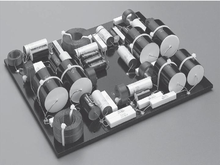

Attached photo is the 1st order crossover from a Thiel 3-way speaker which compensates for speaker physical acoustic roll-off and break-up effects.
Thiel has moved to a coaxial mid-tweeter to solve some 1st order large frequency overlap problems. B&W Speakers white paper mentions that using the same cone material on all drivers is important for 1st order speakers.

As Jay says. the only reason for creating a 1st order acoustic cross-over is as a curiosity.
And you can see just how complicated (and pointless?) it is !!!

LineSource said:Attached photo is the 1st order crossover from a Thiel 3-way speaker which compensates for speaker physical acoustic roll-off and break-up effects.
Very interesting xo and it's an acoustic 1st order? Those parts would keep me going for several speakers.
B&W don't use the same driver material on their 1st order xo as it's tweeter to mid only for the 800 series. I think you find a lot who do 1st order xo's (electrical) do use the same or similar materials on their mids and woofer as they need well behaved drivers such as those with polypropylene cones so no correction is required.
