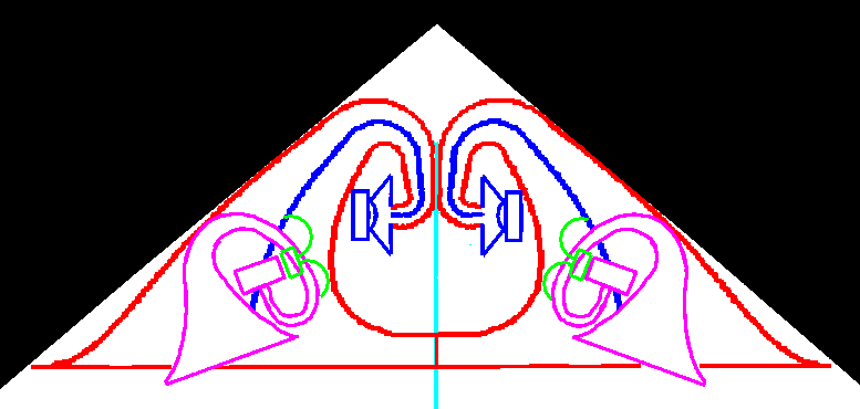

Does anyone know what type of enclosure this bass "horn" is
Avantgarde Acoustic Hornlautsprecher
Hello,
Here are 2 bass horns ("stand" type)calculated by my method (at my knowledge there is at the moment half a dozen French audiophiles using such bass horns):
builder : Frederic Lebas :
diyAudio
builder : Jean-Paul X. :
http://nsm01.casimages.com/img/2009/05/17//090517055721545253677910.jpg
Also here attached a projection on the floor of a "stand" corner bass horn (in red).
Total width 3 meter, depth 1.5meter.
Best regards from Paris, France
Jean-Michel Le Cléac'h
Thankyou Jmmlc, they are some well thought out designs which I am sure were years in the making.
I think i will use 1 or 2 15's in a more standard enclosure for now, with some equalisation. I need to confirm the quality of the dcm 50 and the T500A mkII and would like any opinions of users of either of these components.
