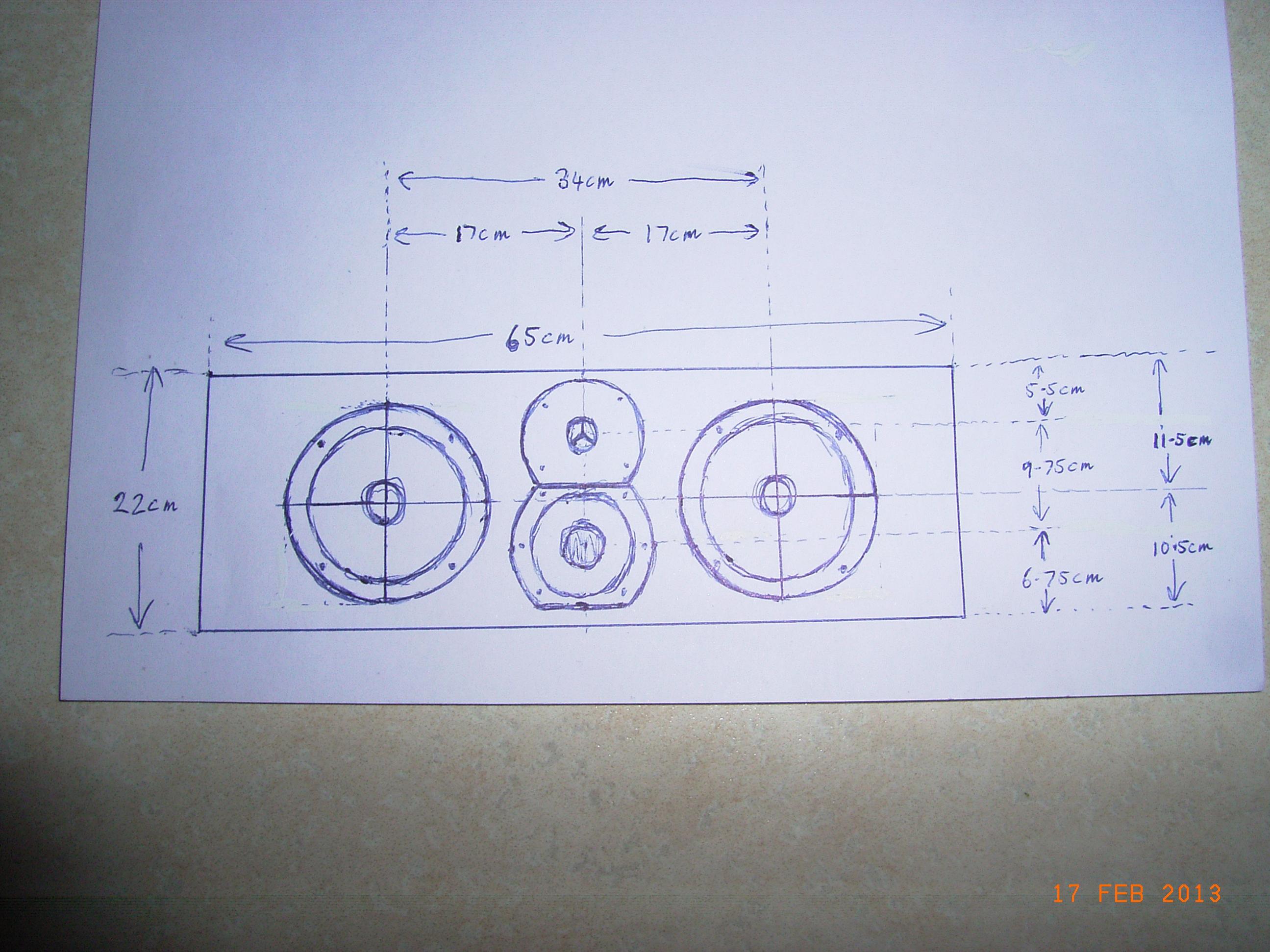

A (dodgy) drawing of the front baffle arrangement is below. :)

Really couldn't think about this much without a schematic of your current trial crossover. The volume of the mid enclosure and bass enclosure is relevant too. Is it reflex?
2X 6.5" polycone bass and a 4" polycone mid it seems. Fairly regular sort of tweeter.
Troels has a 3-way design, Mark 21, not a million miles away in drivers and I don't see an issue in rearranging it as D'Appolito:
Mark 2115
Are you somewhere near those values? You really need to explain yourself clearly. This is way too much homework as it stands. :)

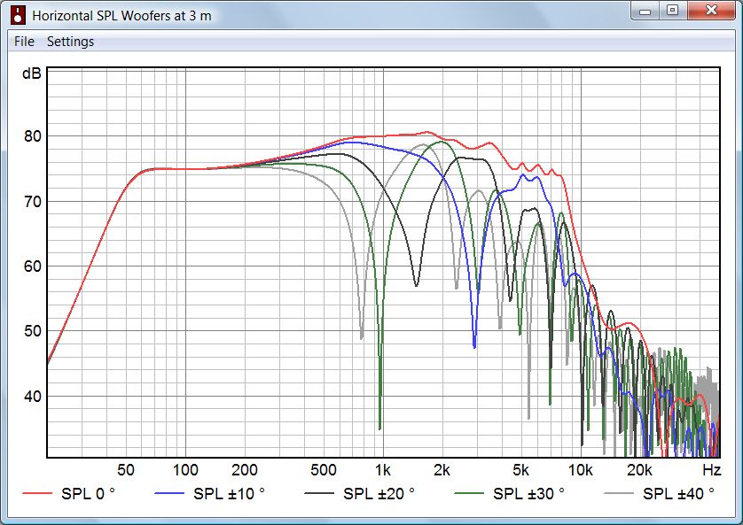

A simulation of the horizontal off-axis response of the woofers helps to answer your questions:
A crossover frequency of 500 Hz is already critical, 300-400 Hz seems to be on the safe side. A 2nd order low-pass filter (12 dB/oct) is inevitable to compensate the rising frequency response caused by the baffle step. The midrange polarity is always reversed to the woofer.

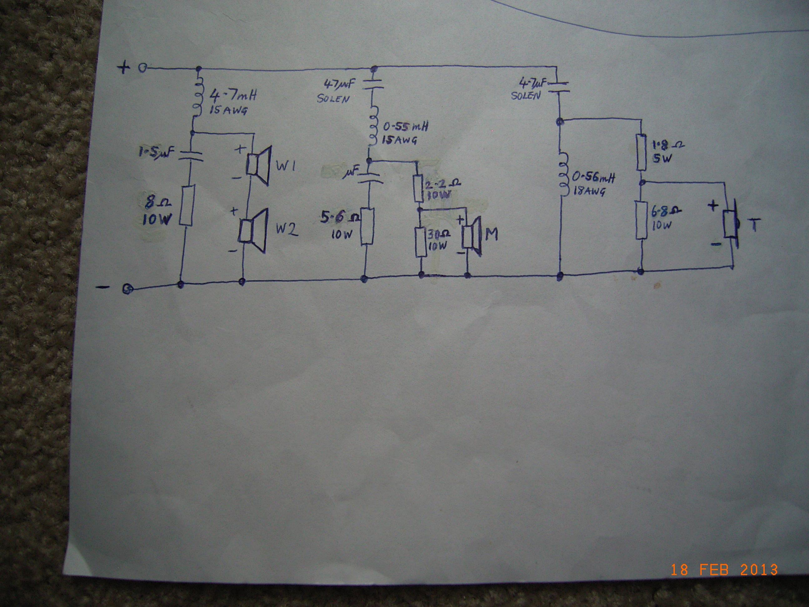

Below is one crossover schematic I used for a while which sounded quite good to my ears.
However since then, I've tried 12db/oct of various combinations, reversed 'mid' and 'tweeter' polarity, and then even went back to parallel but that throws off all the values and sensitivities, so need to start again, so that's when I decided to get on here. :)
Hope this helps a bit more, but its sorta hard to explain. :confused:

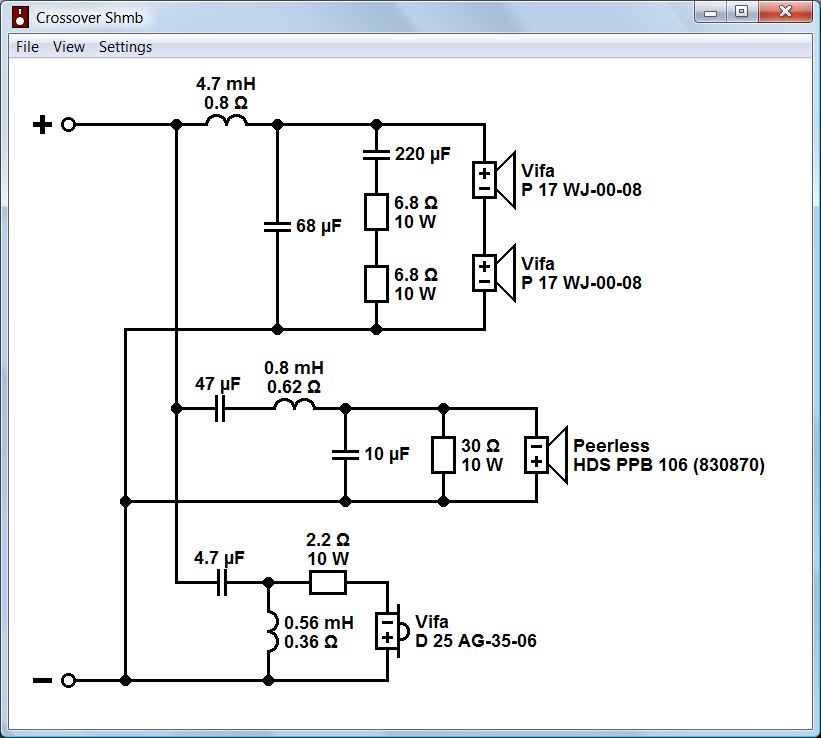

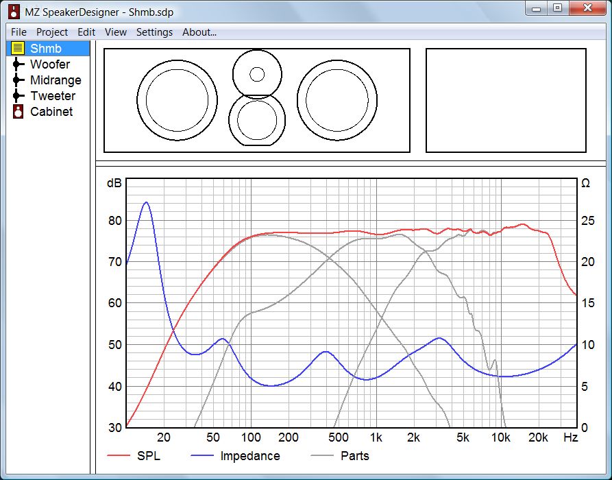

A crossover proposal using as many as possible of the existing crossover components. The design is optimized for a listening distance of 3 m and a vertical angle of 15 degrees. The simulation attached refers to that position also. The lower crossover frequency is about 430 Hz, couldn't go lower using the 4.7 mH woofer coil and the 47 uF midrange capacitor...

You give Dissi's design a go, my friend. Exactly as stated. He has rescued you. :)
You're not going to warm to me when I tell you your own efforts were laughably bad. But it's the truth. :rolleyes:

Did you plot a graph with my crossover? If so what did it look like? Dunno if I wan't to see it though. :eek:
BTW: I did Dissi's crossover last night and it is, as expected, much improved, especially in the lower crossover region. Maybe just a touch bright in the tweeter, but I can work on that.
Thank you very much.

I did model your rather vague crossover. It seemed to be essentially a two-way crossing over at about 3kHz with a midrange added to do something. Phase matching was non-existent too. :)
What the heck is the shunt on the bass doing, for instance? Nothing! :confused:
It was obvious that the midrange was not efficient enough to work except with series woofers to keep the SPL down. Dissi's design seems to be doing about the right things although the treble filter is a bit odd.
Ok, fair enough. :rolleyes: Yeah that shut wasn't doing much, I already knew that, it was removed soon after that picture was drawn.
Anyway Dissi's crossover is in use now, and is no doubt much much better.
I just had to pad the tweeter down a bit more, .....after a bit of playing and a few listening tests, all is now good.
