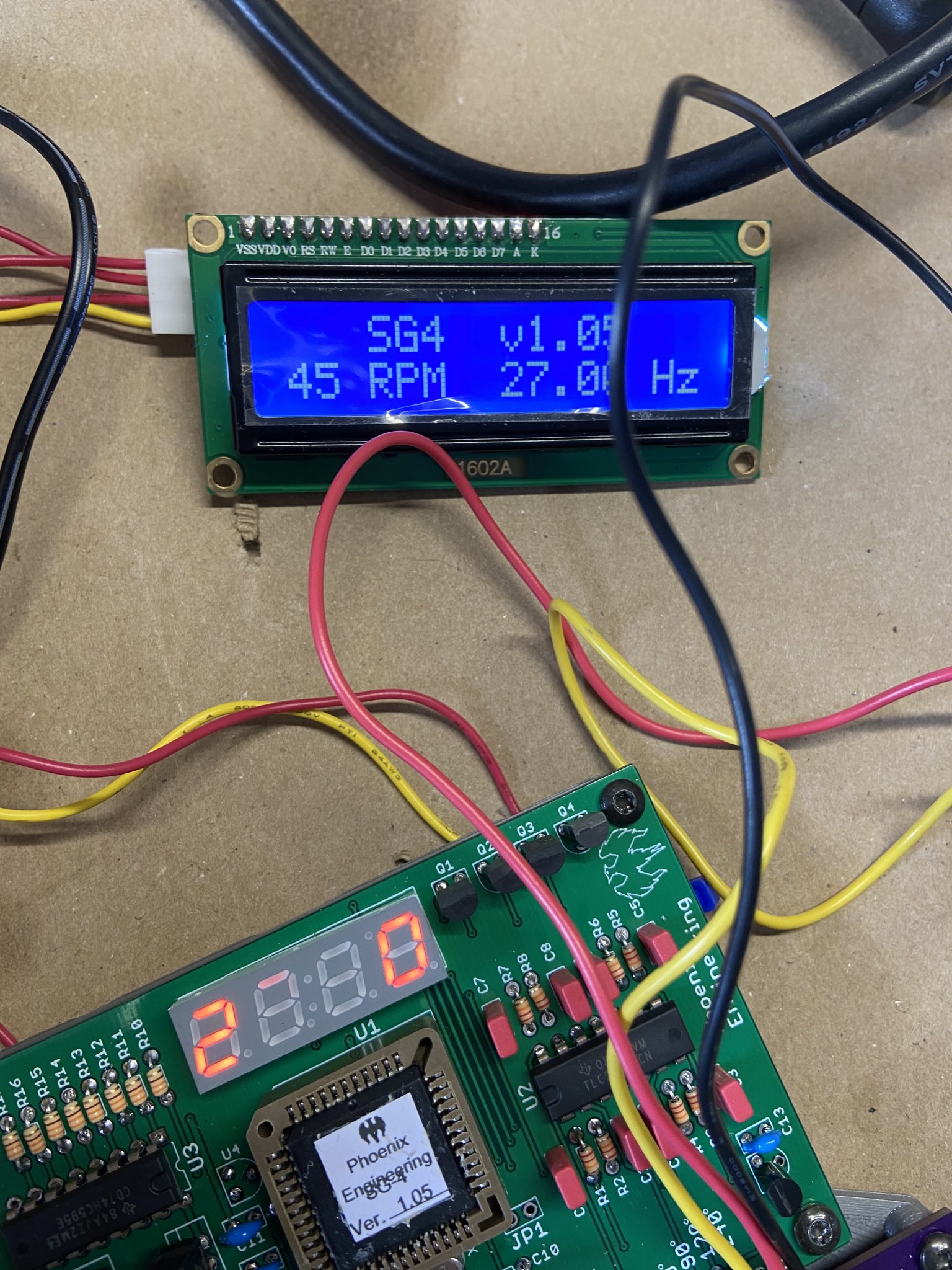

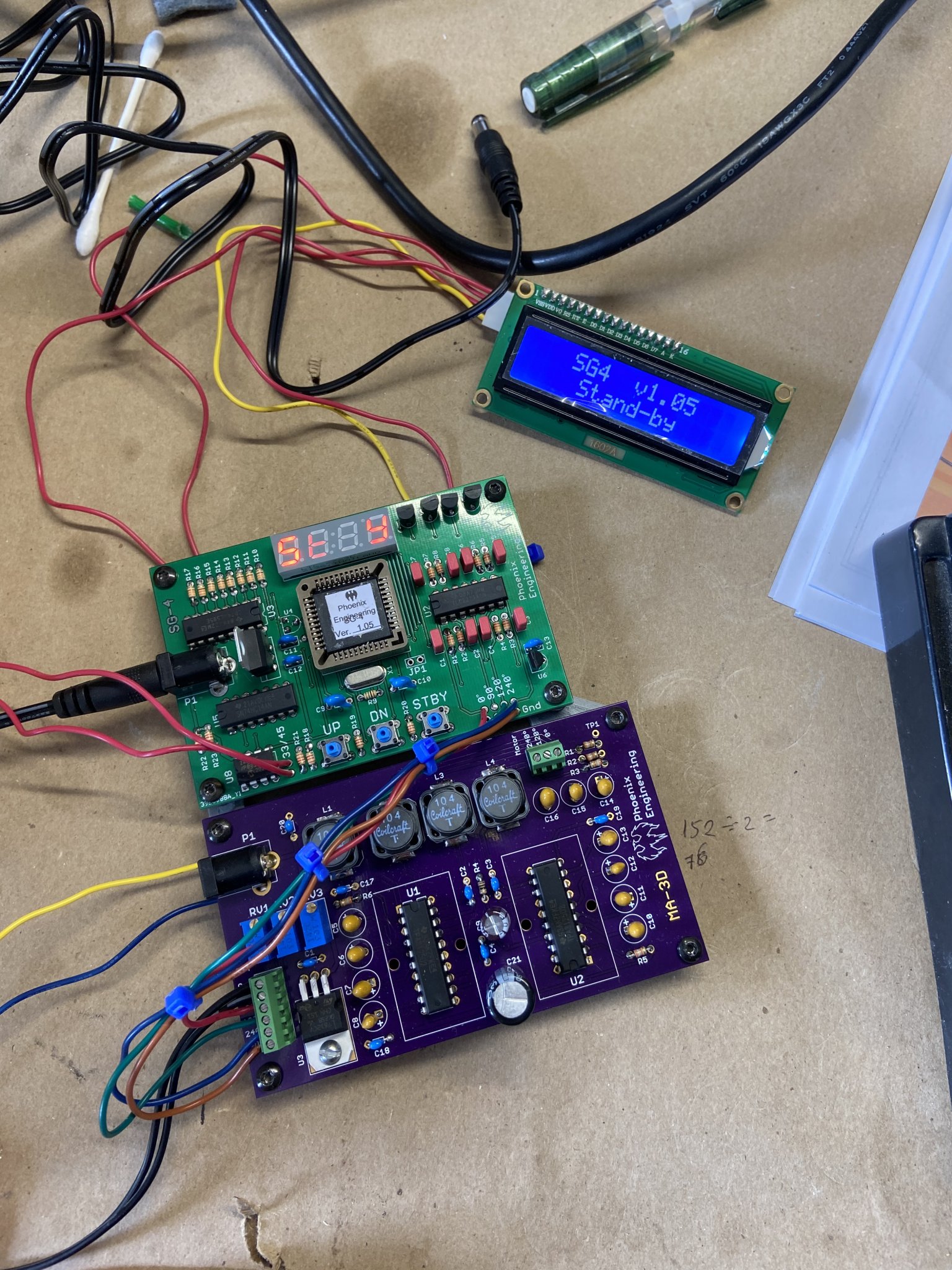

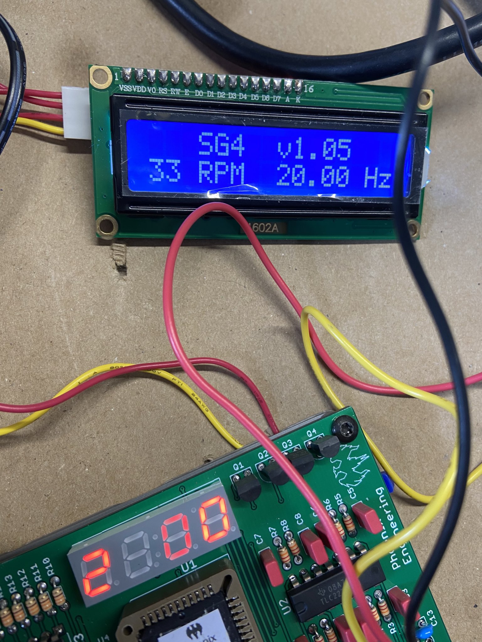

So far so good! I have all the pots dialed in at 4.2v, and have a question about getting the voltages adjusted.
An earlier post referenced a Nominal and Reduced voltage for the same table/pulley combination I am using and the recommended voltages were:
13.57Hz: 2.72/2.35 VRMS
18.32Hz: 2.88/2.50 VRMS
In this case is the 'nominal' voltage the 4.2v? So follow the same procedure, adjust the pots for 2.88 (rather than 4.2v), then bring the reduced voltage on the SG4 down until the AC output on the MA-3D is 2.5v for 45 and 2.35v for 33? Or should I be adjusting the 'nominal' voltage on the SG4 outputs?

I saw that post from 2018 and I was confused because it does not match the numbers I'm looking at. I may have given the voltages for the BLWR series instead of the BLWS motor in that post.
If you are using the BLWS motor, set the nominal (full) voltage for 3.71VRMS and the reduced voltage for 3.2VRMS at 33 RPM (13.57Hz) and 3.4VRMS at 45 RPM (18.32Hz).
Success!
What a great build, thank you Pryamid! I aligned all three pots at 3.71VRMS and the reduced voltages at the numbers you gave. It hiccups a bit on startup, but runs smooth and switching between speeds is great. Maybe just needs a load on it.
And the motor fits in the cutout for the TD125 motor, so no major surgery there. Going to start working on the plinth and the layout for the controls.
Thanks again for all the help and apologies for asking questions there were already answered earlier in the thread.

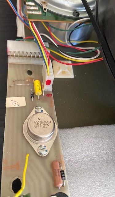

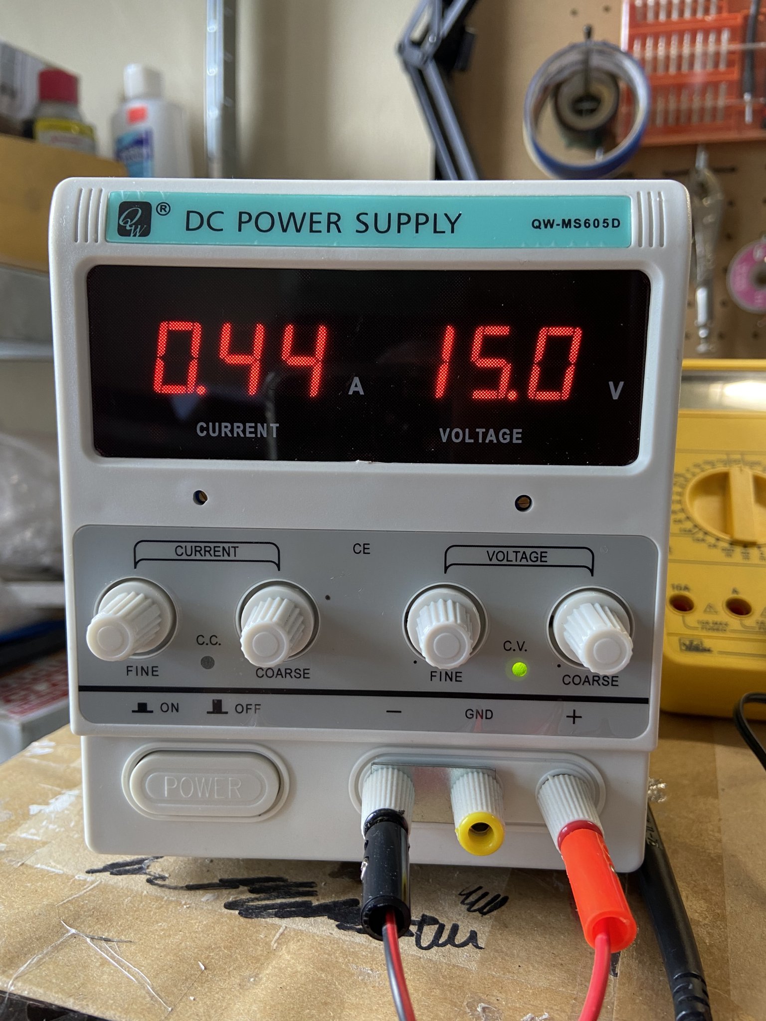

Got everything I need thanks to members here. Have a question: a 2A 15v PS is recommended for MA-3D/SG-4 combo. I'm building this for early Sota Cosmos, which uses LM317HVK to power the old Papst motor. LM is rated at 1.5A max, and supplies regulated 23V. I can replace the resistor on board to bring the voltage down, but will the current be enough? If it blows, expensive to replace ($70ea now). This would make a very graceful solution, I could use existing switches and everything... Thx
Thank you Mr. Pyramid!The LM317 should be OK at 1.5A. The SG4 draws minimum power and the MA3D is class D so it is 90-95% efficient.
Happy to report that all electronics are working perfect! Now the mechanical part. I want to thank Pyramid and Ralph for their great help.
Max current draw I saw at 33 rom start-up at 840mA, which after about 2 sec drops to 440ma. Motor runs smooth. Minimal vibration in hand, should disappear in housing. Excellent project. I plan to house it in existing Sota body, only the LCD and switches will be located outside.
Hi. This is proving to be too complicated. It will be easier to kill the original supply, and just use the original switch to manually turn-on the vacuum. I guess it’s possible to use some trigger from the SG-4 or MG, to add a relay etc but it becomes way above my expertise…The LM317 should be OK at 1.5A. The SG4 draws minimum power and the MA3D is class D so it is 90-95% efficient.
