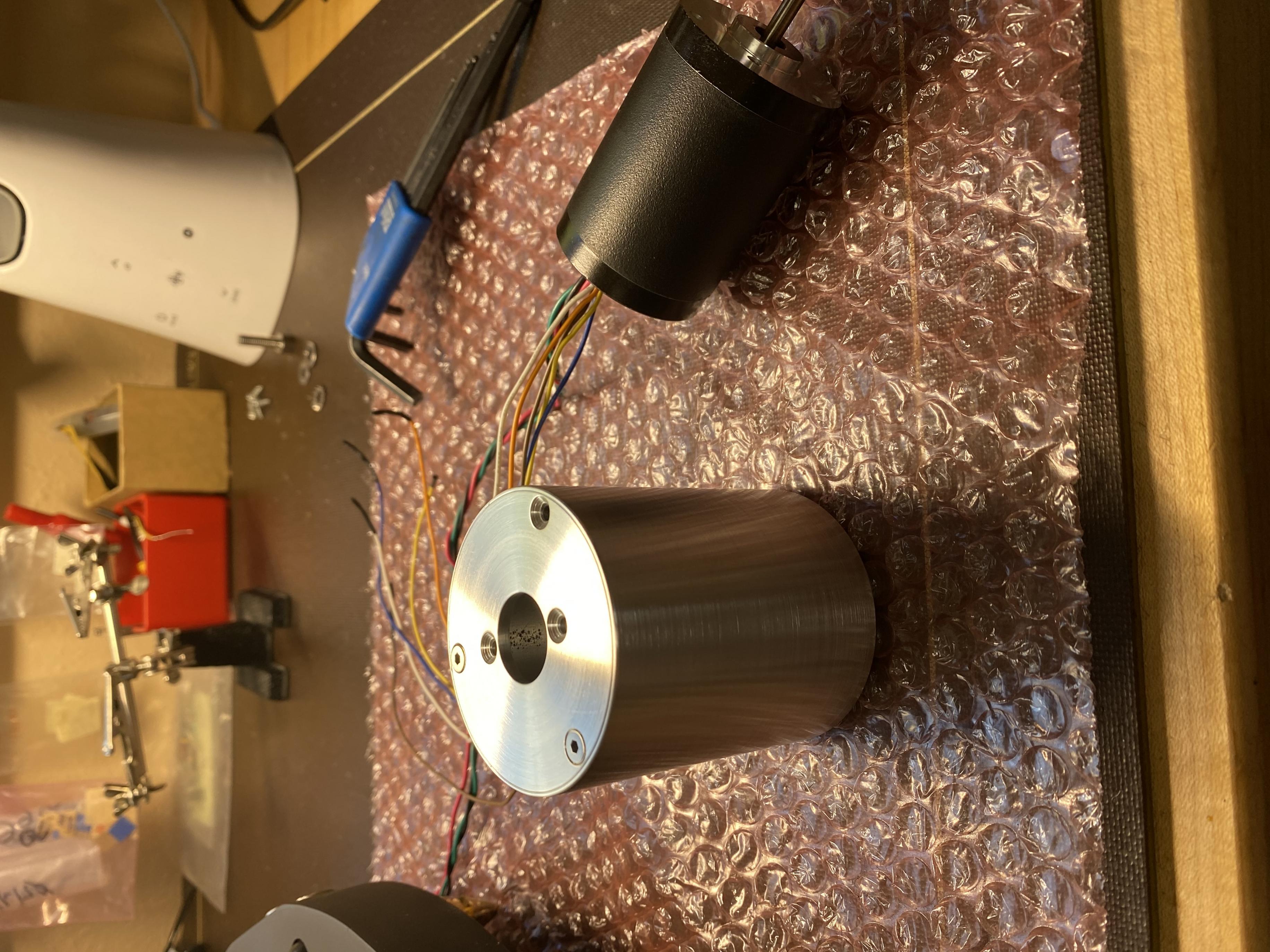

I got myself the Sota eclipse package and Sota told me they could make a bigger pulley at extra cost (75 $) Already got the motor because i wanted to have a POM material motor housing machined at a nearby "" plastics company" where they have 5 axis machine centres.

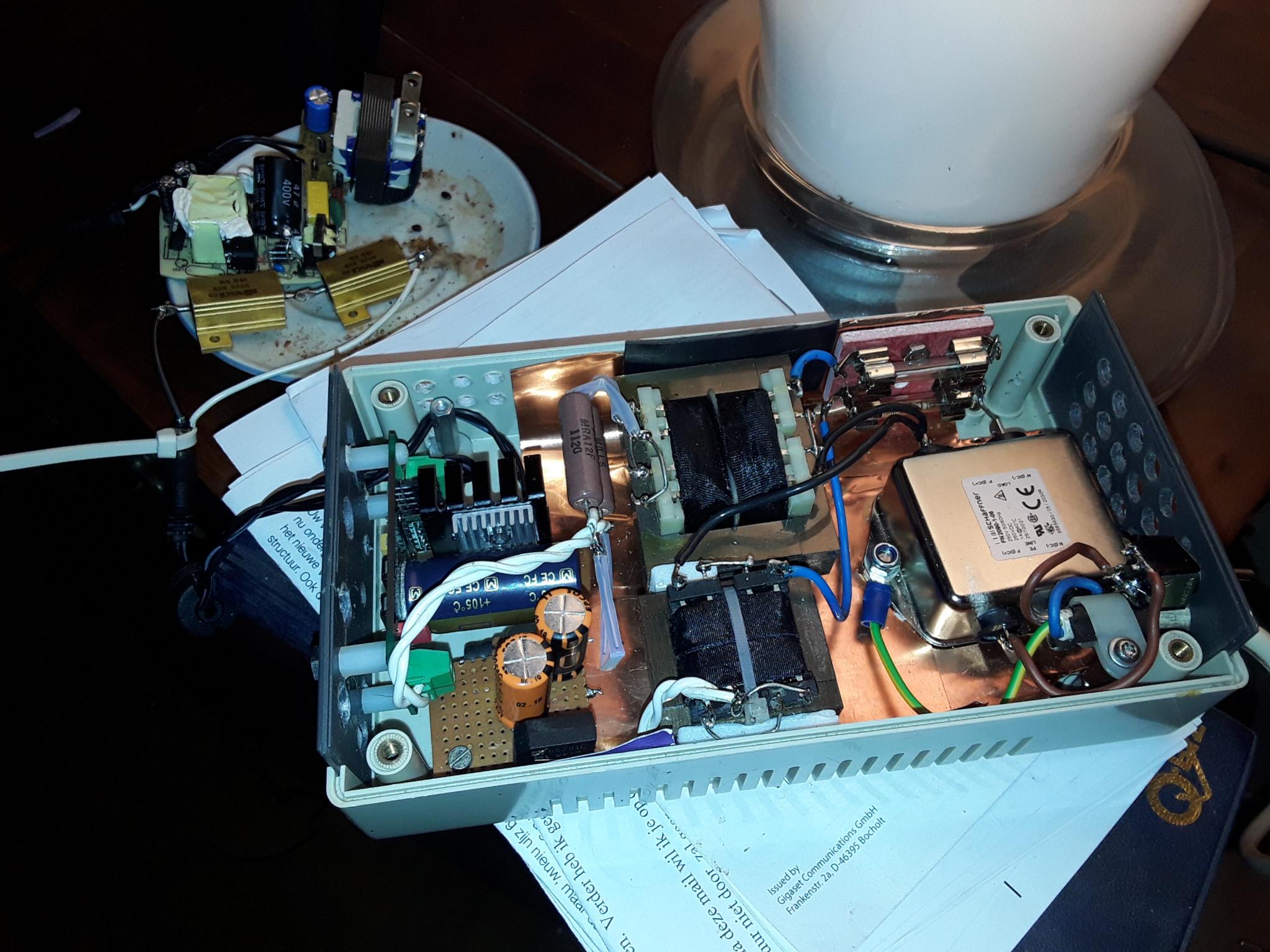

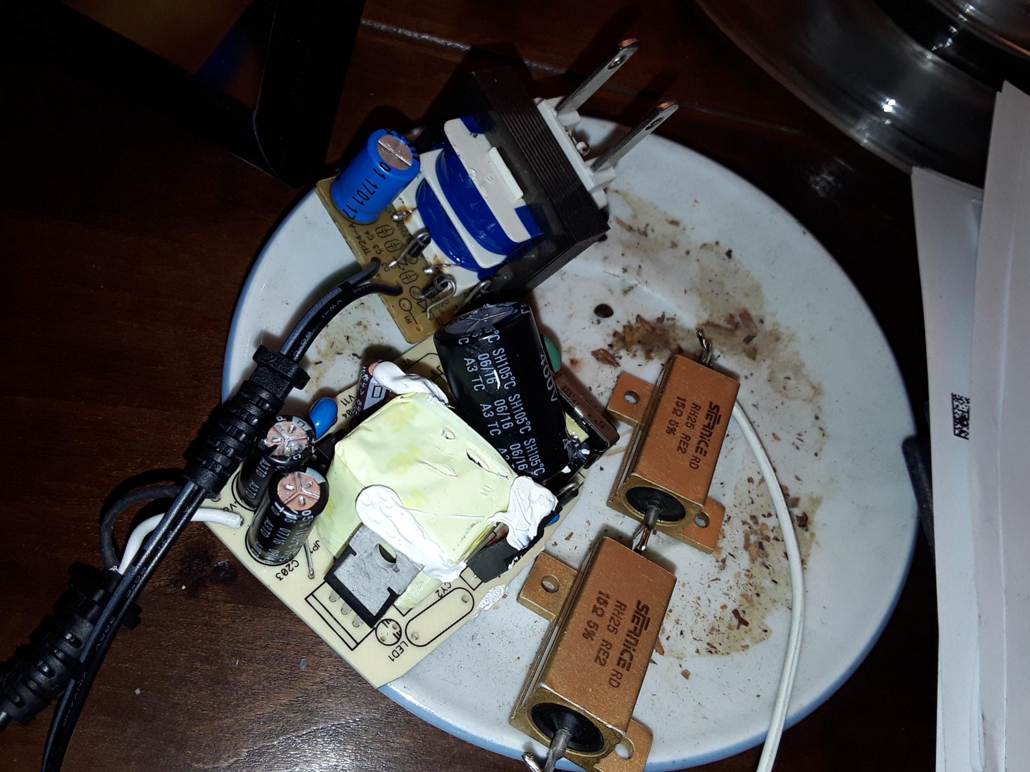

Because Sota send me a supply for 120 volts 60 cps i decided to use corona time to make my own from the part box.
On the plate with the test resistors are the old ones with 6 feet cables. Mine are less than one feet for sure.

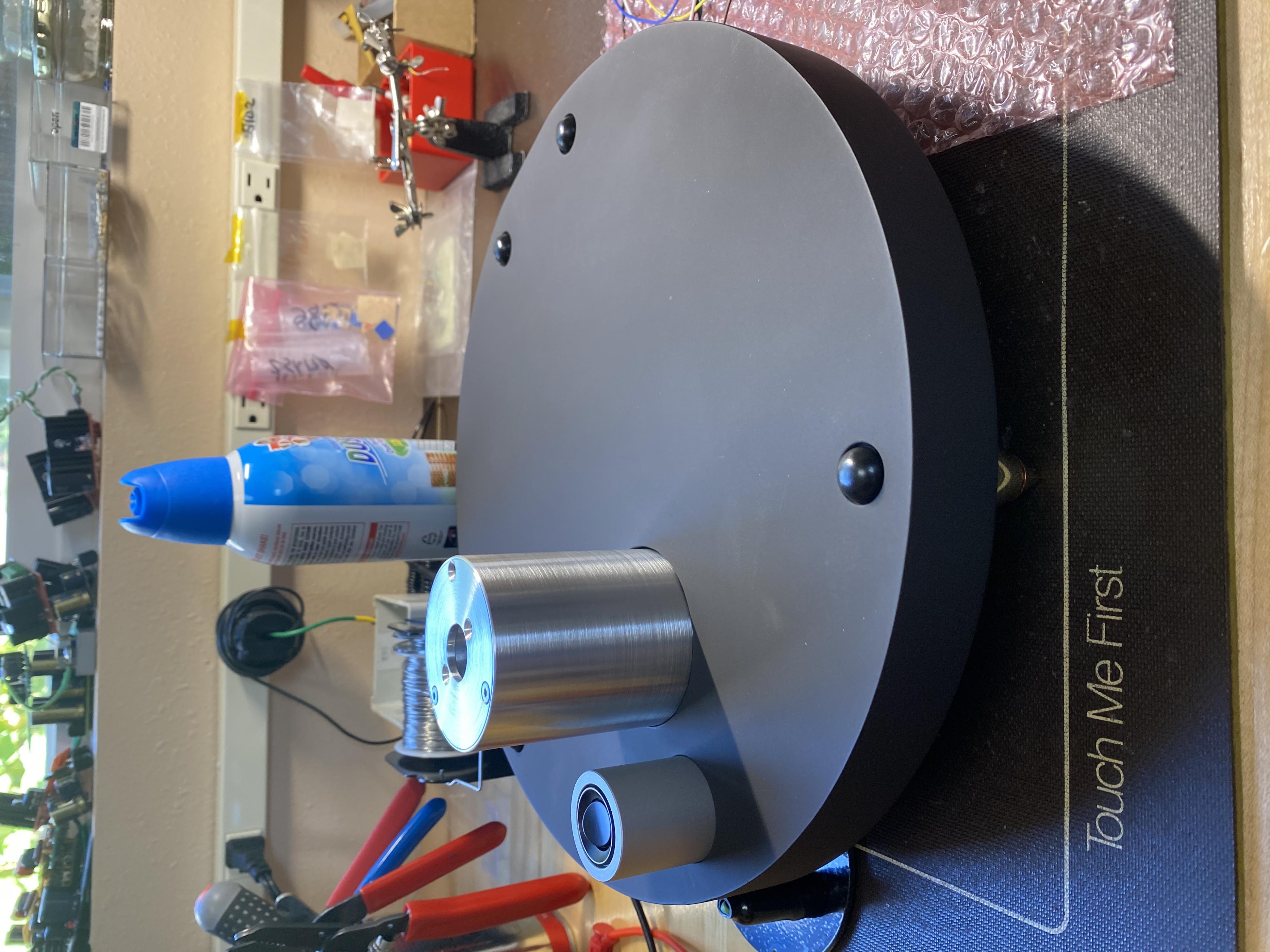

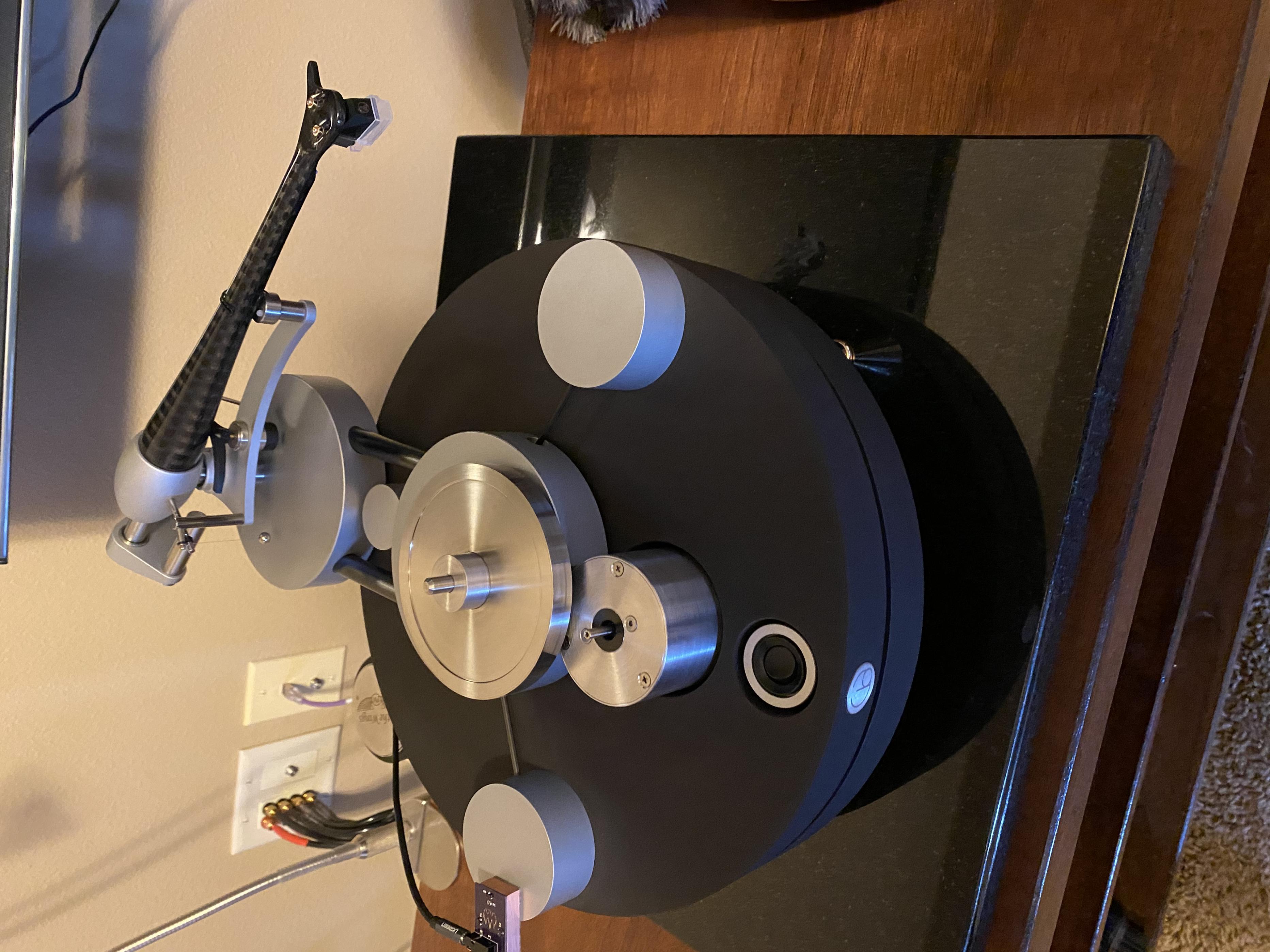

Motor case is ready and motor is in. Pulley must go back for some fix. I made mistake with its height and we made it too tall. So, if some of you have Wilson Benesch Circle One turntable, and you want to upgrade with for new motor, then I can share with all my final drawings.
Got all tested today (PSU controller is not boxed yet). It is fine, but my speed is not in the range that I targeted. It is fluctuates between 33.320 and 33.350. Each revolution creates random up and down jump. I probably know the reason and it is related to my two belts (o-rings) wobble on sub-platter side-wall. I see that by eye. Is that common practice to make these tinny grooves on sub-platter, same way as I see VPI platter has?
