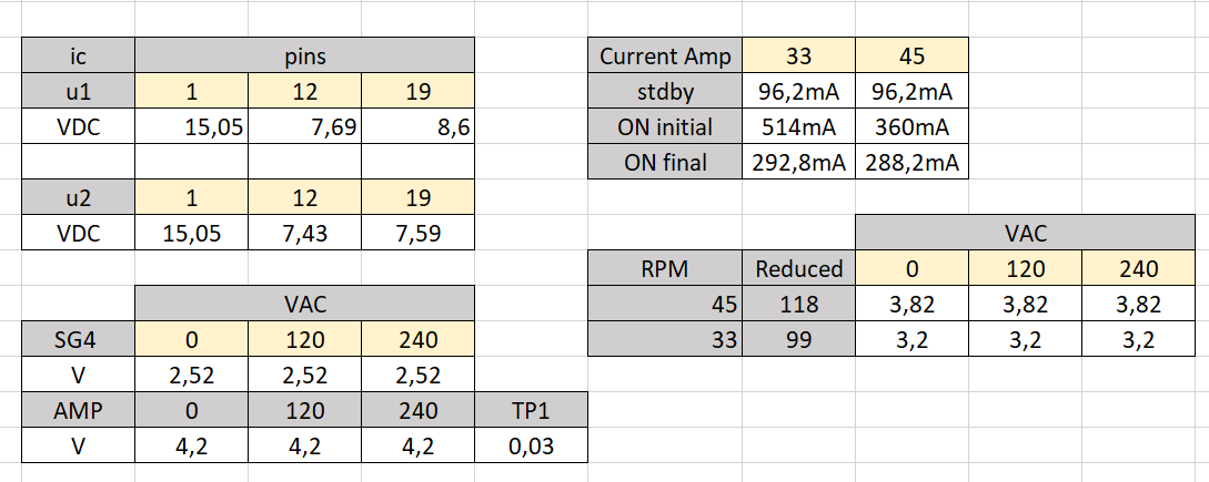

The measurements are attached.
The u1 is showing odd values again for pin 19... Something on the circuit could be damaging the chips?
I've run the motor for 90min, without the platter, and the temperature was 55 C (infrared thermometer with EMIT setting to 0,1). Yesterday the motor was on for around 6h when it started to fail.

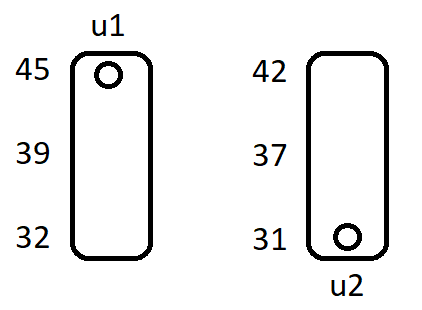

here are the temperature (Celsius) on the ics after 30 min of operation, with the platter
I'll proceed with the ic replacement, but it will take a while... can't find it here in Brazil so I'll have to order from mouser.
Is there any other component that I should consider replacing? Two ics having issues on the same pin does sound strange to me.
I measured the VDC on the output terminal block and the readings are 8.2 to pin 0, 7.69 pin 120 and 7.59 pin 240.
How can the VAC reading be roughly the same for all three pins (3.2) and be different when measuring VDC?

The VDC reading will be the filtered average of output and should be VCC/2. The VAC reading will be affected by the changing duty cycle of the output.
The temps look a bit high for the ICs. If there is an imbalance of the VDC output, they will draw excessive current which may account for the increase. They make small heat sinks designed for 24 (or 40) pin DIP ICs that could be glued to the tops of the TPA3123 chips that may help them run cooler.

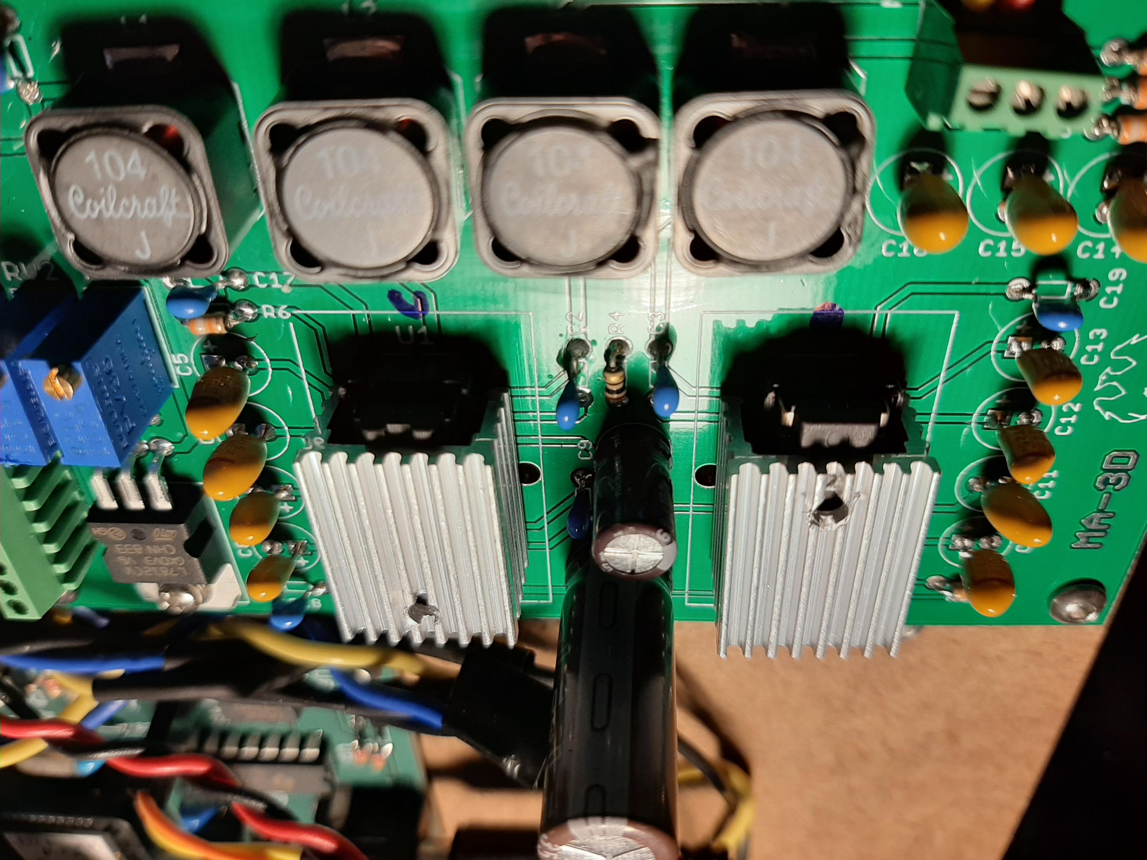

I´ve managed to get the parts and changed them. The DC voltages are back to normal and I´ve installed heatsinks on the ICs. I used some to-220 heatsinks that I had laying around, 'glued' on the top with just a layer of thermal paste. I´ll monitor the temp from time to time.
The voltage readings for the three output pins are all around 7.59 VDC.
