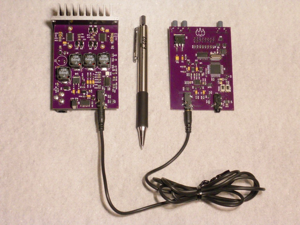

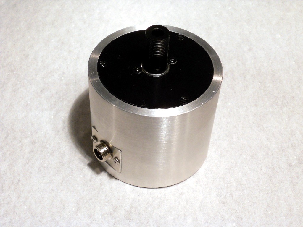

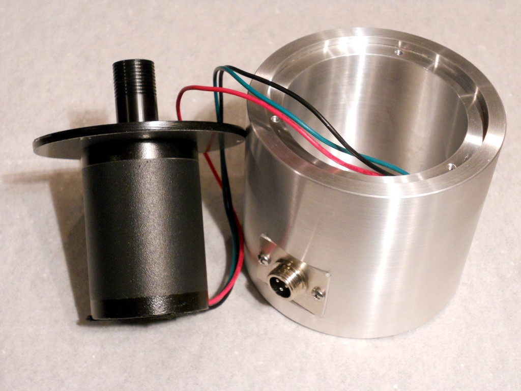

I've been kicking around the idea of a 3 phase BLDC motor and controller for a couple of years now. I've experimented with a lot of the Hurst AC synch motors, but vibration was ALWAYS a problem. I found the Hurst motors to be very inconsistent in build quality. Problem with the BLDC approach, I could never find a motor that I liked or that was cost effective, until a recent trip to Japan when I found a fantastic 3 phase BLDC motor in the Akihabara electronics mart. Inspired by a couple of conversations with Mark Kelly on the subject, I finally decided to pull the trigger on the controller now that I found a suitable motor, mainly as a non-commercial project-- just to see what was possible.
The motor is 24V / 12W / 1500 RPM and has about 4x the torque rating of a 10W 600 RPM Hurst AC synch motor, although it is smaller diameter (45mm vs 59mm) and only slightly longer (60mm vs 40mm). When I spin the motor by hand, I feel no cogging at all, even though it has iron stators and a PM rotor. The motor uses precision ball bearings that are pressed onto both ends of the shaft so there is no end play at the pulley at all. I think this is one of the reasons the Hurst motors are so noisy; that and they only have one bearing at the top of the shaft, the magnet/rotor is left to fly around at the bottom with no support. I've built 2 phase controllers for the Hurst motors, but of the 6-8 motors I have, not all of them would work; some of them would start vibrating horribly as they got up to speed unless I damped the motion with my thumb. I contacted Hurst about this and they said that was typical and that I should attach a small collar to the shaft to control end-play like VPI does on some of their motors. Didn't seem like a very workable solution to me. The bearings in the BLDC motor initially gave me pause, until I fired it up and realized it was far quieter than any of the Hurst motors I have. The construction of the stators is similar to AC induction motors with all of the windings on one core assembly rather than on 2 bobbins like the AC synch motors (another source of vibration in the latter). The BLDC bearings are sealed and never need lubrication; and unlike friction bearings, they can handle much higher radial loads without having to replace them when they wear. The motor runs quieter than any of the Hurst motors I have and is comparable to the 2W Premotec motors for noise.
The controller is the same basic design as my other controllers (DDS based) except that it has 3 phases instead of one. I also needed to adjust the output voltage and phase based on the speed of the motor and the torque required. Having independent control of all three elements creates an extremely smooth rotation with much more torque than an AC synch motor. The other HUGE advantage is the range of speed control with this method: With the Hurst AC synch motor, I would be lucky to get 3:1 speed range, even when driving both phases with quadrature signals. The high end (90Hz max) would have almost no torque and the low end (30Hz) would cog excessively. With the BLDC motor, I can easily get 100:1 speed range running the motor from 15 RPM to 1500 RPM (<1RPM to ~83 RPM at the platter) and the torque is surprisingly high even at 78 RPM. I start the motor at ~5Hz (4.2 RPM at the platter) and can ramp up to 93.6Hz (78 RPM at the platter) in a matter of seconds with zero burn out on the belt and all 3 speeds (33/45/78) using the same pulley. The controller drives a 3 channel class D amp powered by a 24V 1A wall wart. The amp fits in the same sized housing as the controller (about the size of a pack of cigarettes) and never gets over 100 deg F.
Since I have complete control over the phase of the 3 windings, I can also control the direction of rotation in software. I can easily switch between CW rotation for belt drive or by putting a rubber grommet on the pulley and switching to CCW, use it as a direct rim drive. I had a local machine shop turn an aluminum housing from a piece of 3.5" solid aluminum bar; the standard SAMA housing on my Scout was too wide to allow the motor to get close enough for the pulley to make contact with the platter. I wasn't happy with the vinyl grommet so I stuck with belt drive for now, but I'm going to keep looking for a softer silicone washer to use for rim drive.
I did some listening tests with the new motor vs the Hurst AC synch motor on a VPI Scout table and there is a noticeable improvement. Dynamics definitely took a step or two in the right direction. Because the motor has virtually no vibration, the noise floor seems to have dropped as well and the back ground is eerily quiet. Detail and clarity seems to have improved, but only because they don't get buried in the noise as before. I don't think it change the sonic signature of the table, the detail was always there, I just couldn't hear it as well. I wished I had found this motor earlier, but now that I have it, I'll never go back to AC synch motors again.

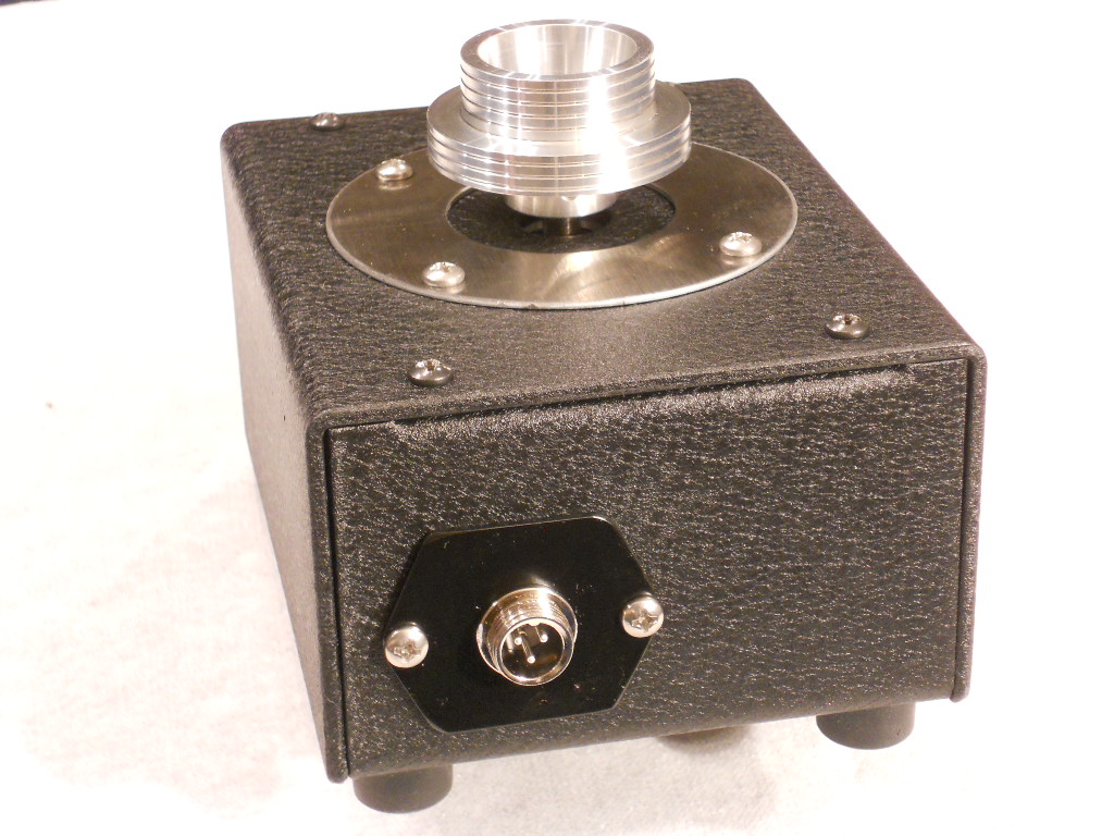

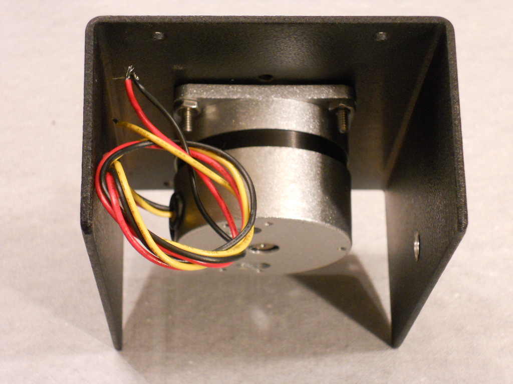

This project really has me thinking. The BLDC motor I found overseas worked beautifully, but it was just a tad too tall for the Scout SAMA housing and also would not fit in a VPI Classic table. I found a US supplier of similar motors and they had a version with the same basic electrical rating (12W, 24V, 1500 RPM) but in the same form factor as the Hurst 59mm series. Unfortunately, it also has a 1/4" shaft, but I still have some pulleys left over from the 300 RPM motor project that I was looking at 2 years ago and they work a treat!
I did have to modify the firmware just a bit as the motors were not identical electrically, but close. I was able to mount the new motor in my Scout SAMA housing using slightly longer hardware as the mounting flange is much beefier on the new motor. I replaced the IEC inlet with a small plate and mounted the 3 pin low voltage connector onto the plate.
I was also able to mount the new motor in the cylindrical housings I had made with only minor modifications to the mounting flange of the motor.
The new motor is just as silent as the original with absolutely no vibration felt or heard at the motor when running. It also has the same torque rating as the original which is ~2x the torque of the Hurst 300 RPM motor of the same size. Since I'm starting at 5Hz, the motor spins up to speed without chirping or slipping on the belt. The sense of increased dynamics is still readily apparent with the new motor as is the quieter background.
Next up, I want to mount the new motor in a VPI Classic plinth and do some listening tests.
