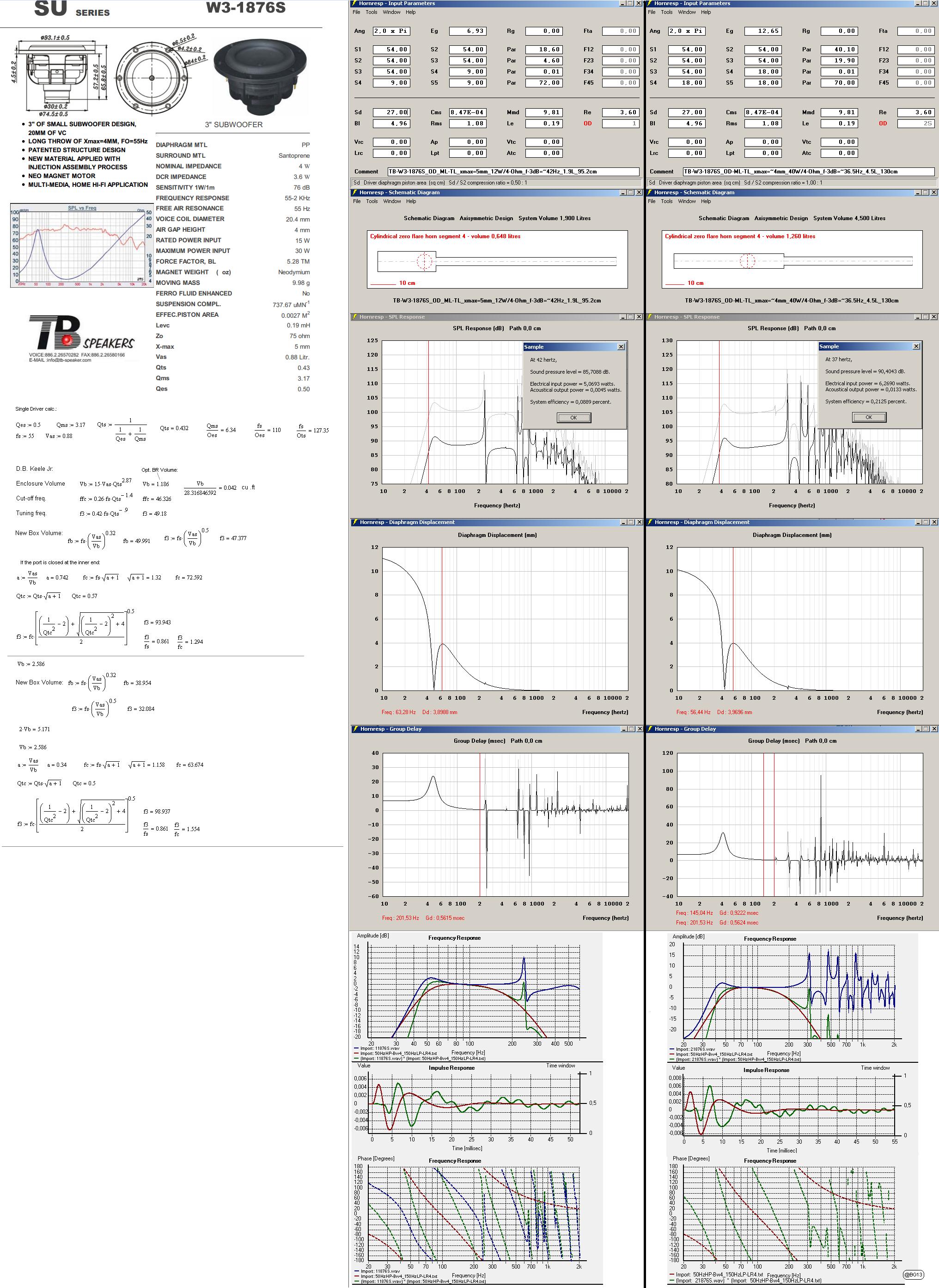

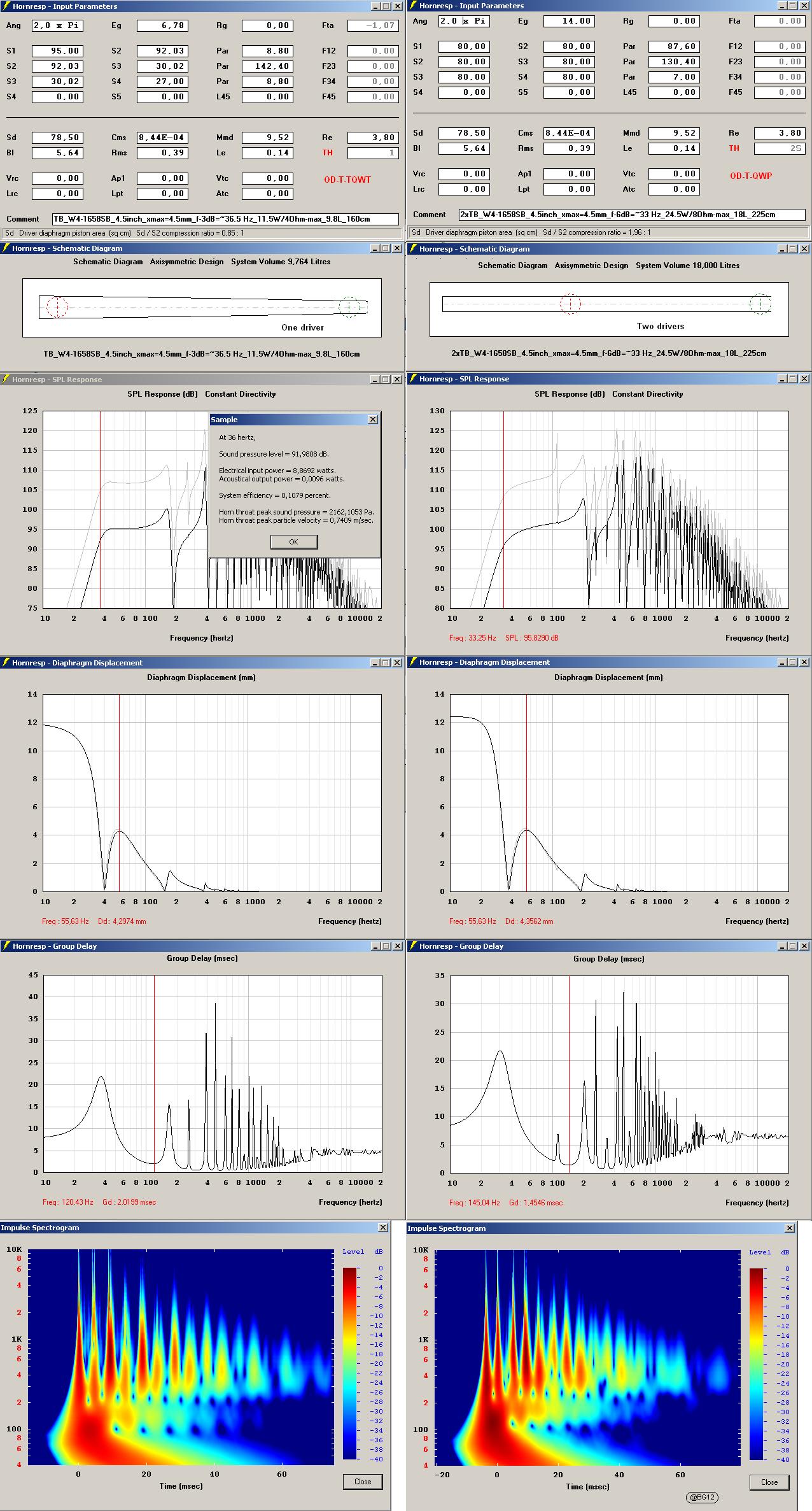

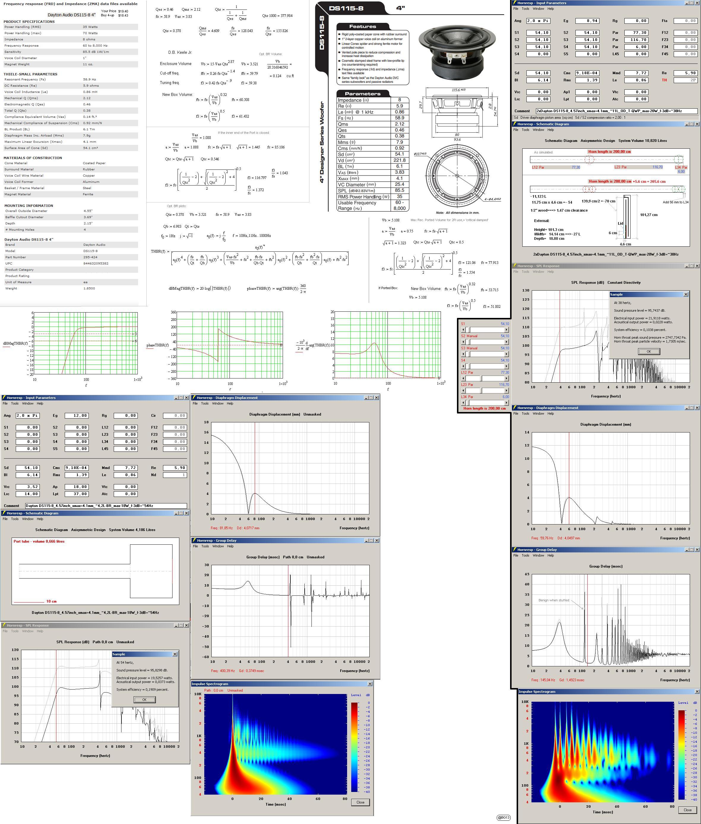

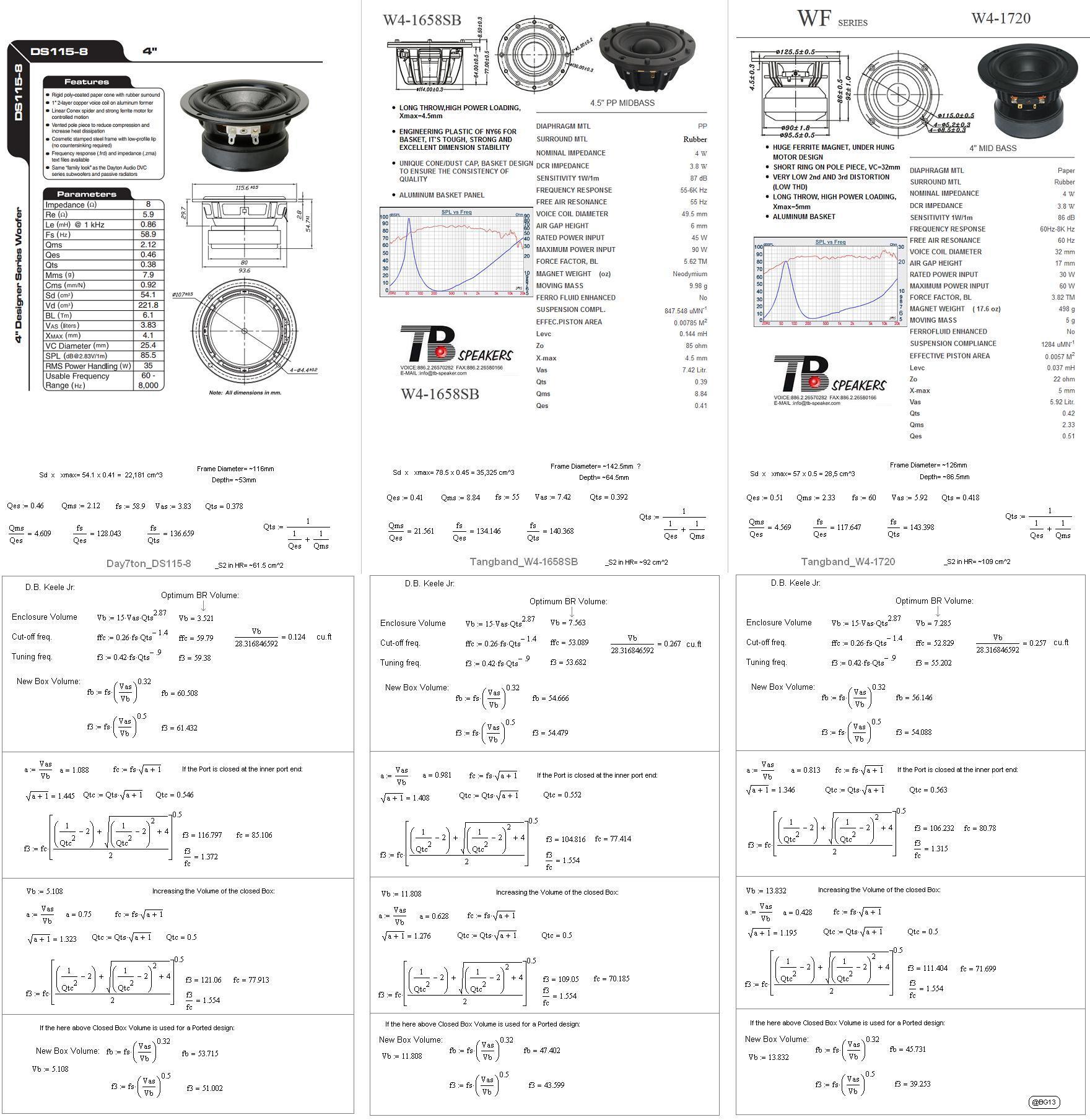

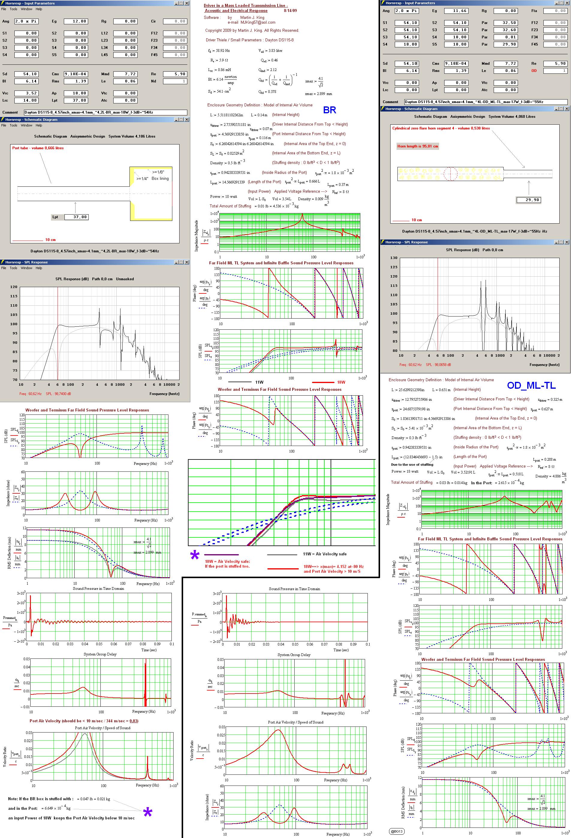

Hi realflow,
Here are a couple of simulations using small drivers in not that large boxes:
b
PS: Performance is targeted, not SPL.
