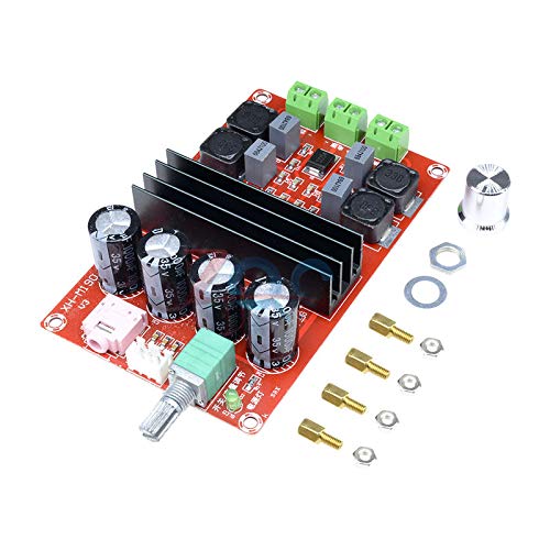

Does anyone have some experience with this board?

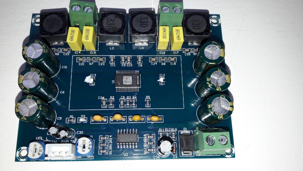

Yep, lots do. Poultygeist was the first I read of using it, I think. Mine is connected to a Chromecast audio but not currently in use. It sounds good. It won't do 2x100 watts into 8 ohms. It needs a 4 ohm load to approach that. I have read that it isn't really suited for high output use. The solder tracks are thought to be "puny" by some. Used at 16-19V and with normal indoor listening levels it's fine.
.... It won't do 2x100 watts into 8 ohms. It needs a 2 (not 4) ohm load to approach that. I have read that it isn't really suited for high output use. The solder tracks are thought to be "puny" by some. Used at 16-19V and with normal indoor listening levels it's fine.
Put some 105dB/W(very sensitive) 2ohm speakers on them and come back to tell us, it wasn't loud.
You will get about 100W from pbtl tpa3116 at 2ohm, 50w@4ohm, 25W@8ohm with 26V. With 18V you get about half.
The 2 chip 2x100w boards are only louder then the 1 chip boards, when you put a 2ohm load/speakers on them.

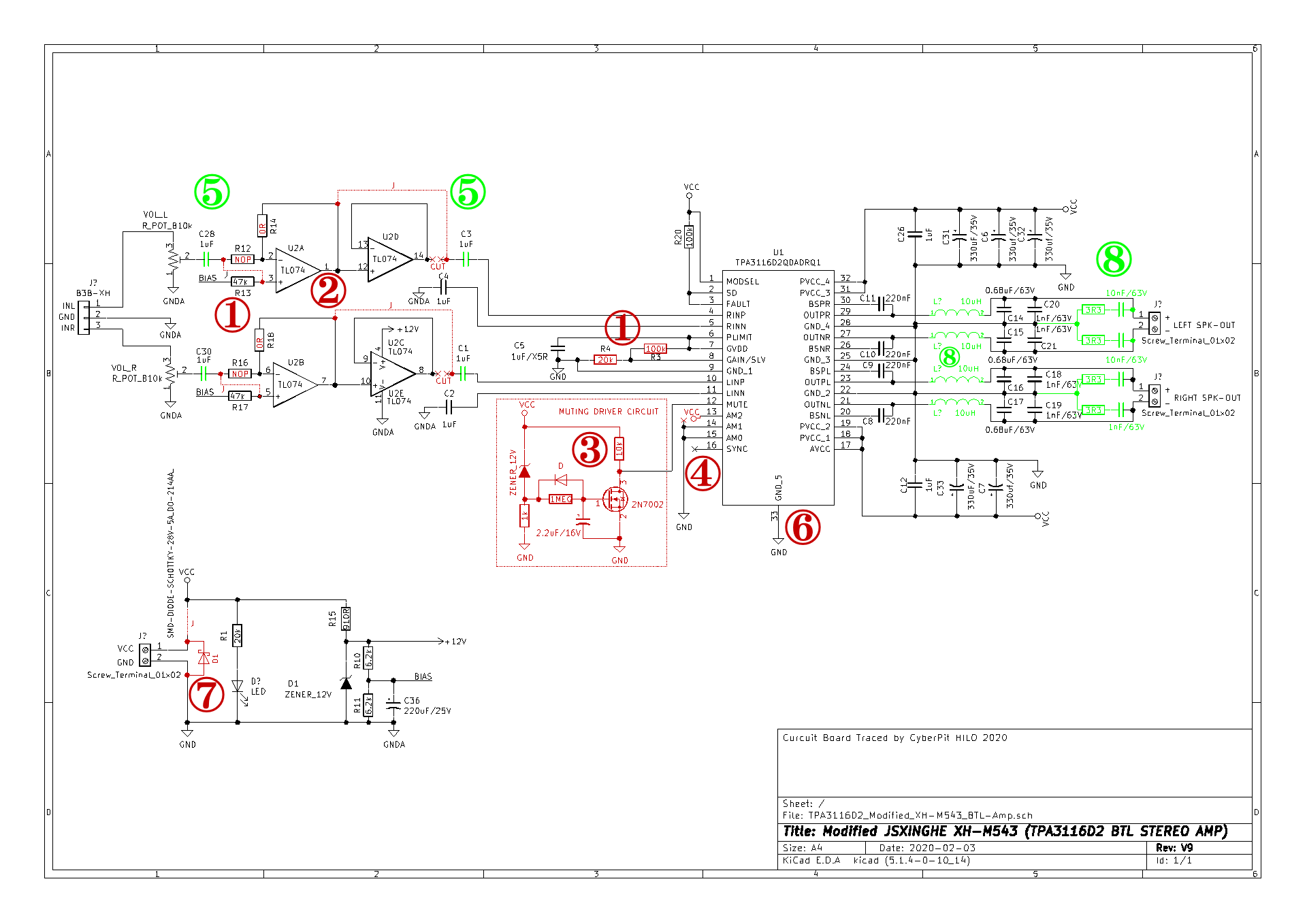

Hi Guys

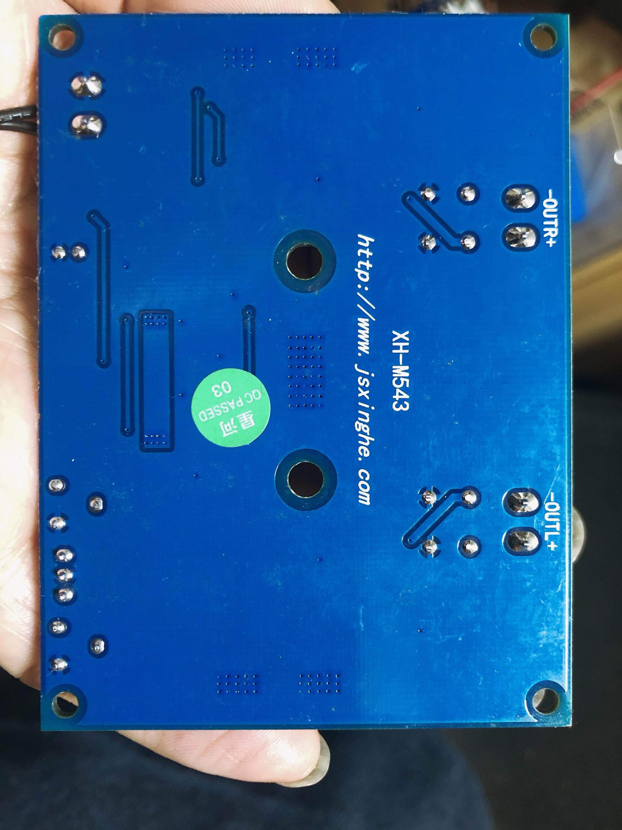

I had traced XH-M543 V9 (Single Chip BTL 2ch) board.
I 'm going to modify following pints.
Hi Guys
- Reduce the gain (Input sens. 20mV --> 1V)
- Switching frequency change (400kHz --> 1.2MHz)
- Muting Driver Circuit Modification (1Cap to Active Circuit)
- MLCC to anther type (Audio Signal Coupling Caps)
- Paste Silicone Grease on thermal PAD

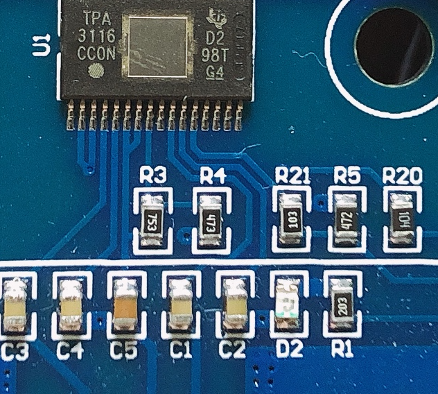

If I compare the schematic with the PCB I miss the C34 330uF used for muting during power up. I had the previous version with only a resister from mute to ground and that was giving a loud plop during power off. I wonder if this has been improved with this version.

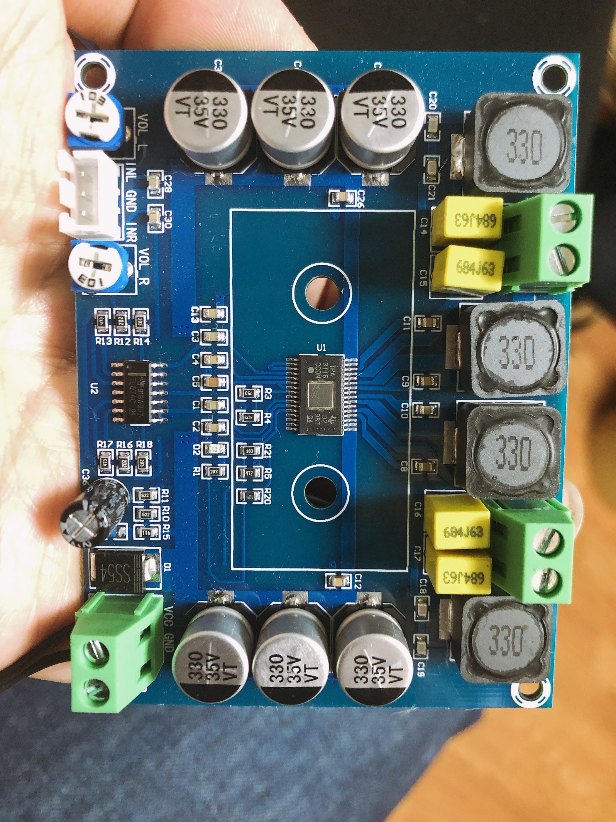

HX-M543 Modification
I'm modifying Single TPA3116D2 Board XH-M543.
Modification details will be described in following page...

Was it original in slave mode? (Gain: 47k and 47K)
Oh~!, Thank you for your advice.
It was just Copy, Paste and My mistake ....
Updated!
Was the heatsink removable by removing only screws?

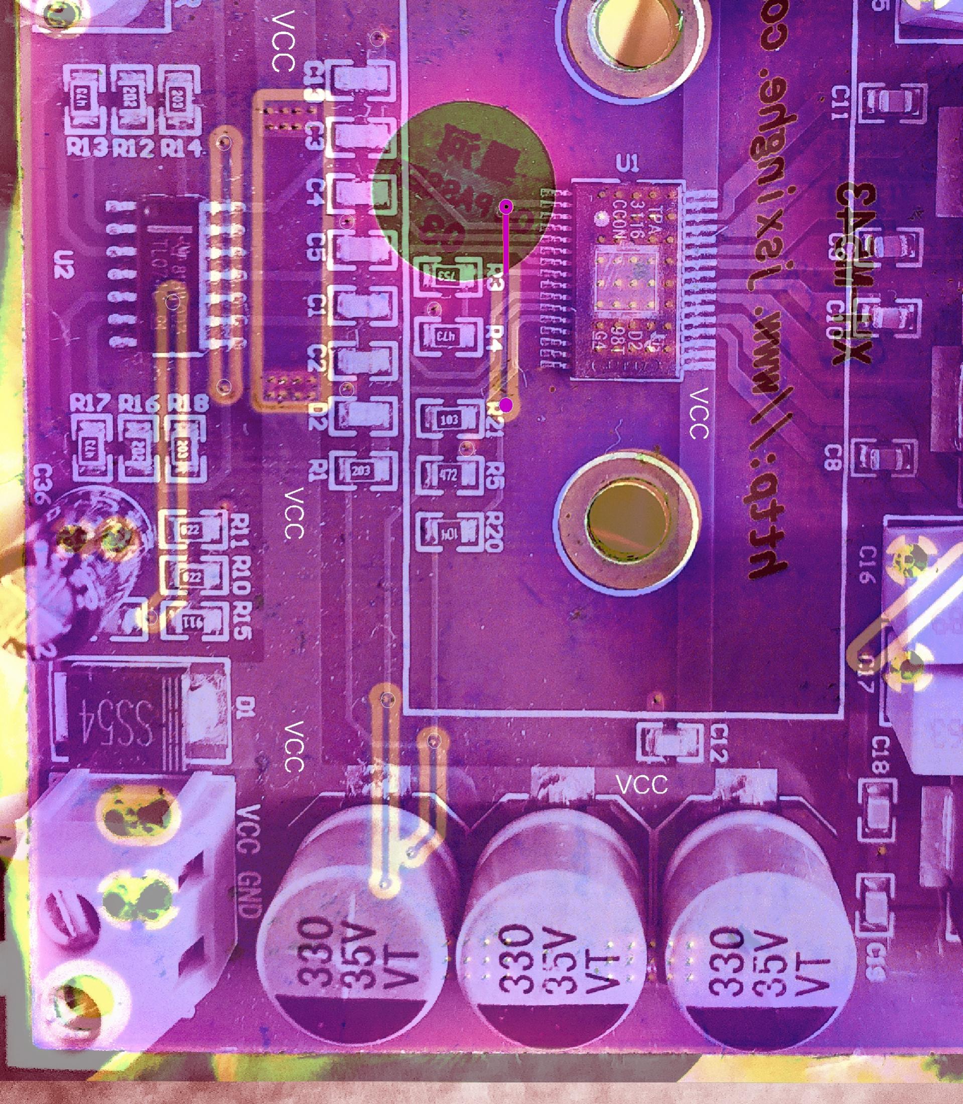

I have found C34! Its one of the 3 capacitors near the connector for the power.
If I look to the PCB, it looks as if R21 was not between R5 and C34, but between R5 and the Mute pin (pin 12 of the TPA3118) It looks as if R21 is used to limit the current to the mute pin.
And are you sure R1 (near the power LED) and R20 is connected to VCC? Because on the PCB it goes down with a via, just before the big VCC track. Wasn't it connected to C34?

I made a X-Ray Like View. It shows R21 is connected in series to the MUTE pin. R20 and R1 are tied to VCC..(May be I need some fix on my schematic ...)
