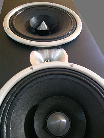

Here's a fine example:
Zu Definition
2*10" + super tweeter (+4*10" bass drivers)
http://www.zucable.com/definition/index.html

Hmm, impressive. I'd like to know how they've succeeded in eliminating the lobing problems inevitable with running 2, 10" full-range units, full-range. Line arrays need their mids and tweeters packed tightly together for just this reason. That could be a trick worth knowing.

Those Zu260 drivers look like just what I've been looking for. Assuming one could talk Zu into selling a pair raw, what do you think . . . $500 . . . $1000 a pair? I'm cheap though, so for those prices, I should get "wonderful" right out of the box, without having to make any sawdust.

They probably didn't.. instead just using them up to the point where the freq. response developed a severe notch with the supertweeter and horn loading exteding from there..
some people are extremely sensetive to this, others are not. I personally couldn't stand listening to Dunlavy's speakers because of this - but it wasn't a freq. response artifact I was having problems with, rather it was "enhanced" (and artificial) directivity in the vertical response.

Kensai said:Those Zu260 drivers look like just what I've been looking for. Assuming one could talk Zu into selling a pair raw, what do you think . . . $500 . . . $1000 a pair? I'm cheap though, so for those prices, I should get "wonderful" right out of the box, without having to make any sawdust.
Kensai
This is just a modified Eminence Legend B102.
Druid sounds phenomenal. It's not a perfect speaker but it plays music better than any other speaker I have heard (including Jordan TL and MLTL, Fostex, Visaton, Tangband, Phy-Hp). On the other hand some people don't like it at all...
One thing which is awesome about this whizzer cone driver is that it really doesn't sound like a whizzer cone driver like other whizzer cone drivers do. The Zu phase plug must be the reason for this?

Kensai said:Also, is the key to mechanically extending the upper end all in the phase plug Zu is using? Is that something I could mimic on my own? Is the phase plug riding the cone or is the cone sliding around the plug
The phase plug is certainly part of the equation*. They really seem to help whizzer cone drivers.
*(another part is that to add them you lose the dustcap -- the pp sits sationary on the pole-piece)
Here is a comment i just got from a fellow who just installed plugs on his 206s:
I received the phase plugs Monday evening and got them in after some very nervous cutting of the dust cap! I had hoped that I might hear some difference but was quite surprized to hear a much smoother sound through the high's and mid's! The harshness in the human voice range has smoothed out too. I cant believe fostex doesnt build the 206 with the phase plug already in it!
So far my experience is that this comment is applicable to way more than just the FE206. We did make some MONSTER plugs for some Emminence Beta 12LTA....
