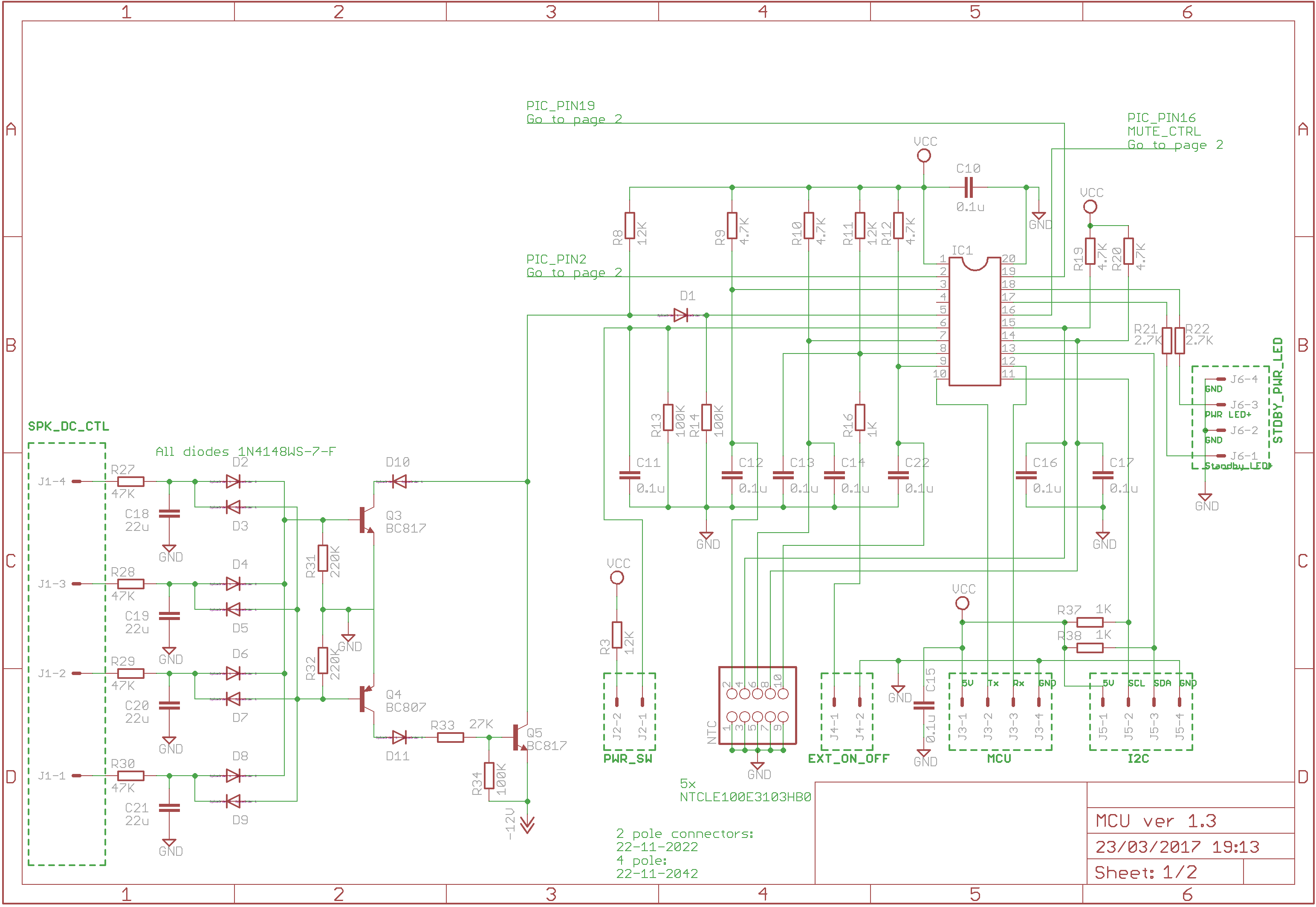

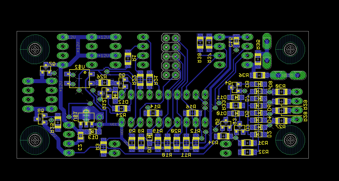

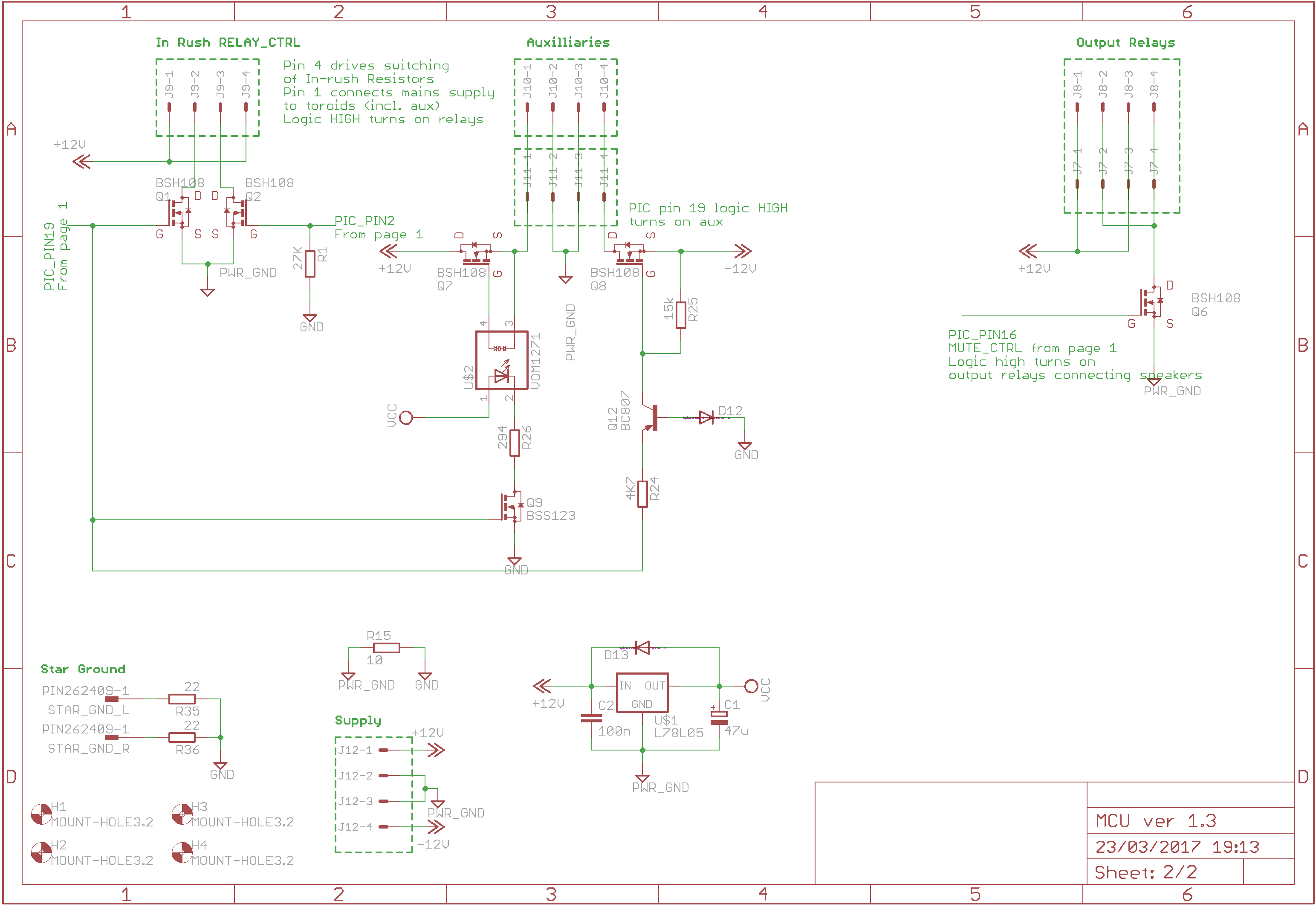

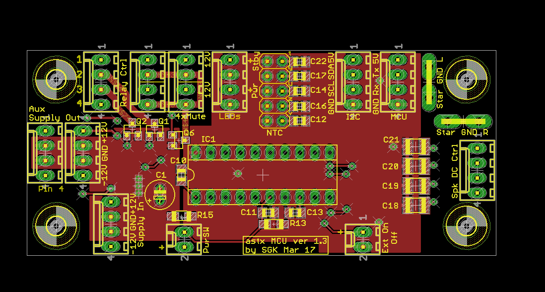

When I was implementing my SMD version of Toni's Main Control Unit (MCU) we found that his auto detection software could not correctly identify the board configuration if the gate of Q2 had a residual charge. A 27k resistor (R1) to ground from the gate of Q2 fixed the issue. I have revised the board layout to accommodate the extra resistor and also made some changes to the silk to better identify a number of the connector pins. I have attached Gerber files for a 2xboard panel of the revised layout. Also attached are images of the single board configuration and schematic. Note I have not sent this to fabrication and have not tested the new board layout. The changes to the board layout were, however, rather minor. I have plenty of spare boards from the previous version if anyone is interested. I just soldered required R1 on the underside of the board.
Note that my pin order for the 2 and 4-pin connectors is reversed from that which Toni uses on his other boards - a key reason why I have endeavoured to make the silk on this board very clear.

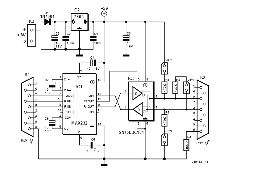

Thx! Study finished - all parts identified? BTW: for MCU configuration you need a TTL2RS232 adapter...
BR, Toni

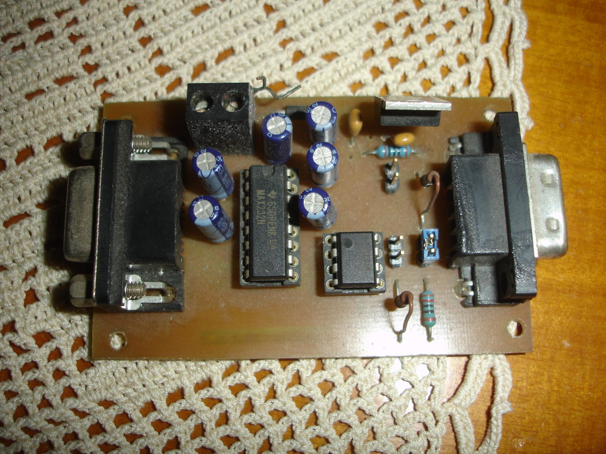

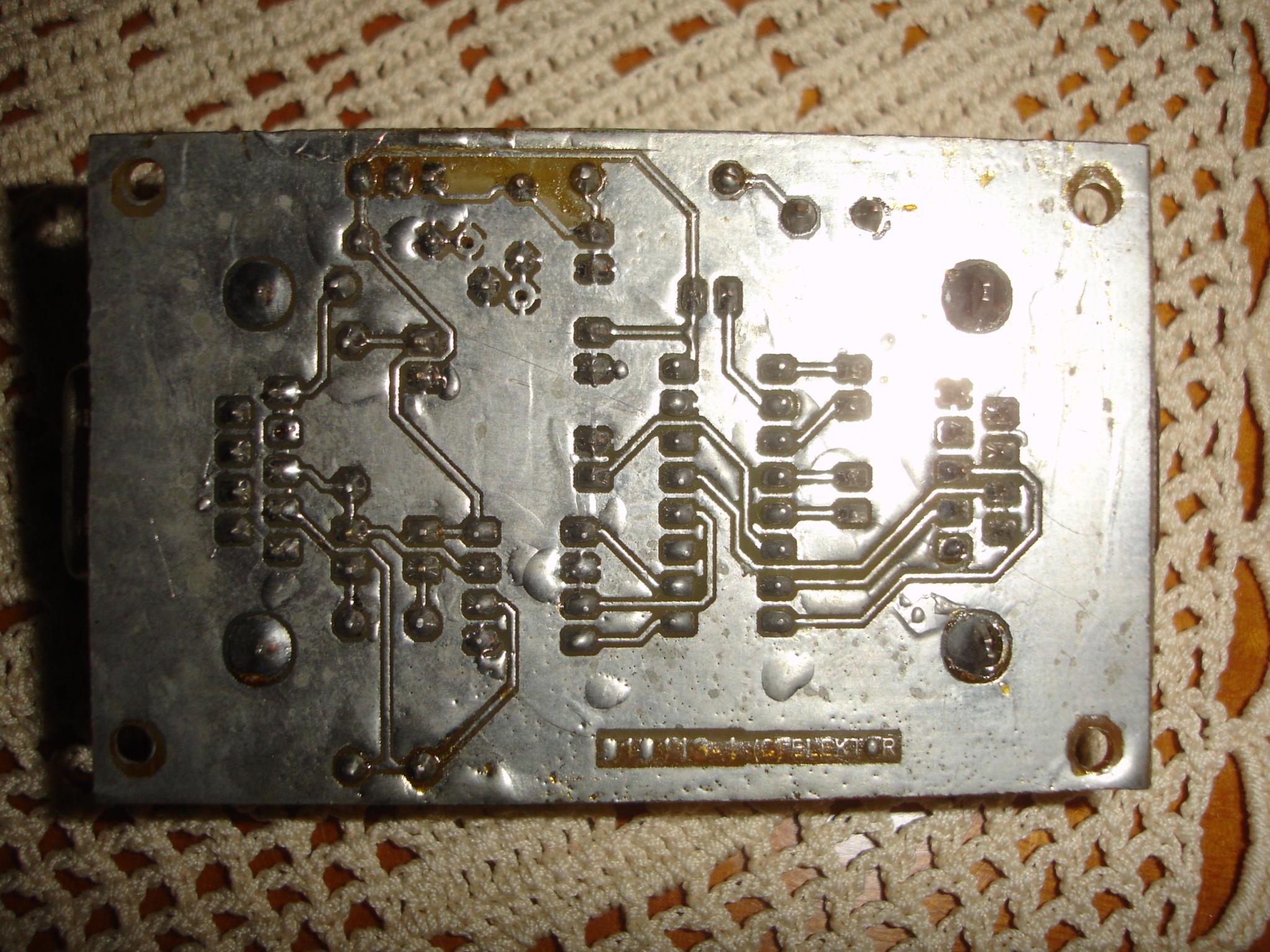

Is this the story?
The communication between P.C and MCU require a RS232to TTL converter.
Using a terminal program like, windows terminal,you send some values like start delay,temperature alarm e.t.c?
I found this circuit .It is a RS232 to RS458 converter. First stage basically is a max232.Is the output of max232(RX,TX) suitable for the communication?
Is it as alternative methode a usb to serial converter?
Where i can find some guides about MCU configuration?
