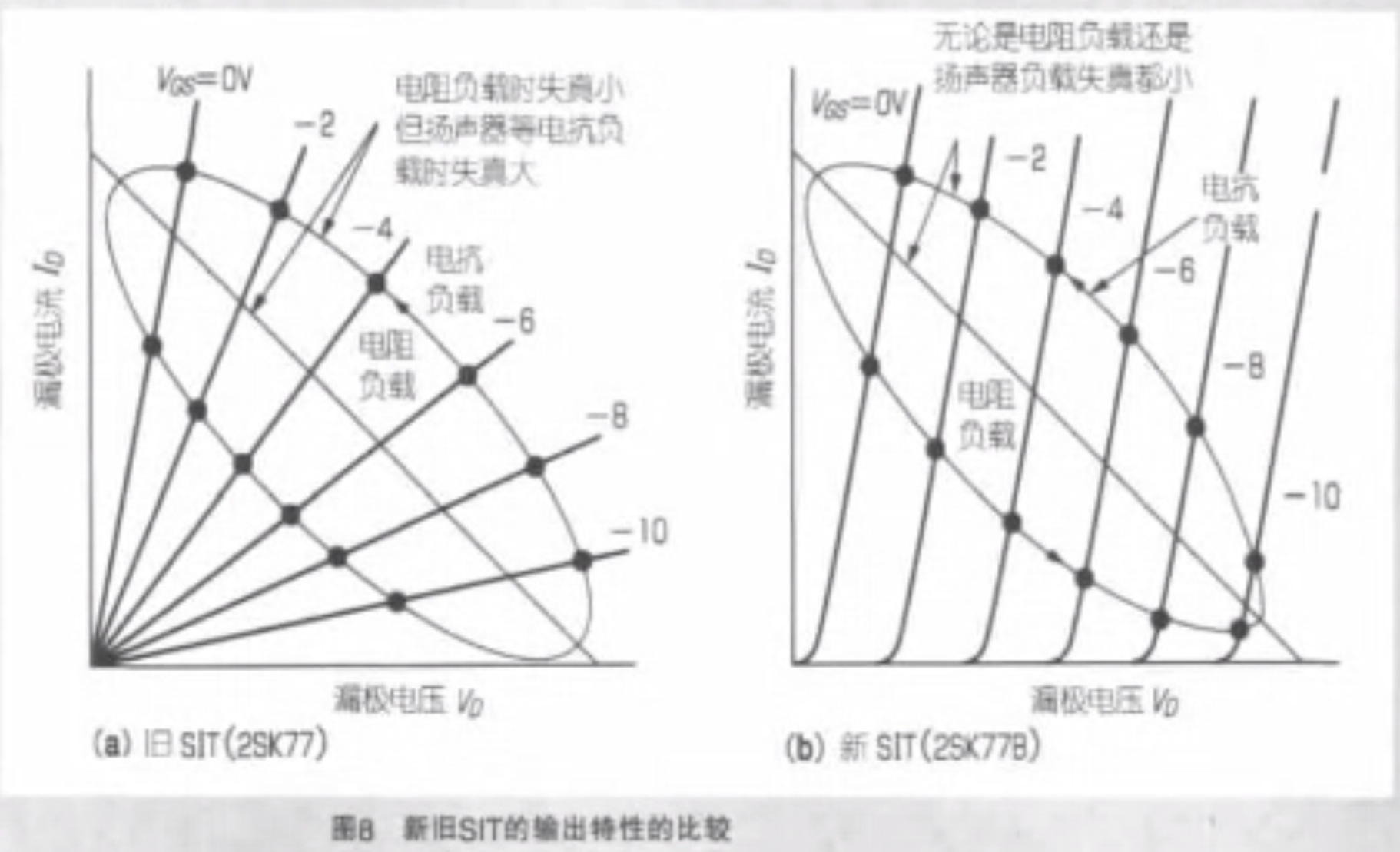

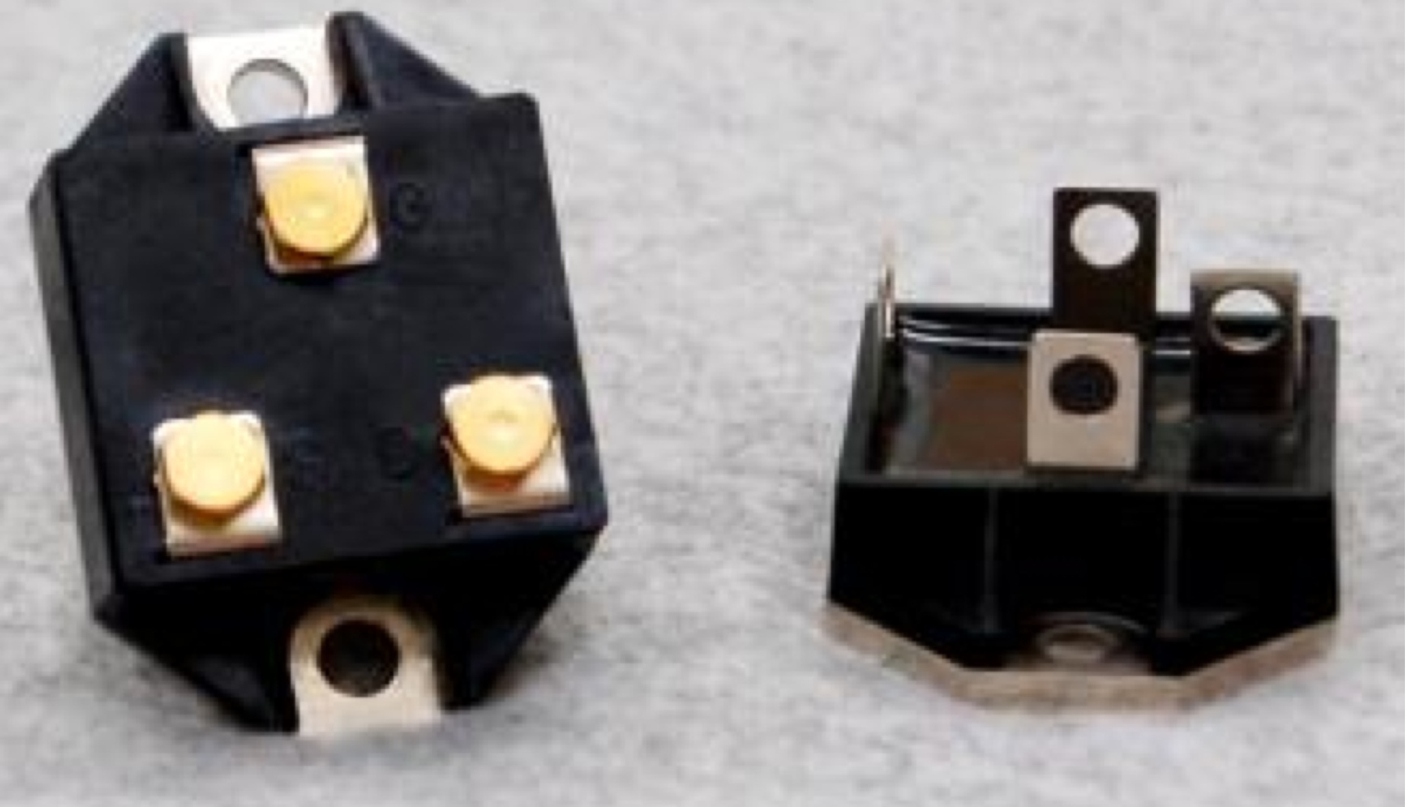

2SK77B and 2SK180 need low input impedance source.
Step by step i build hockey puck Schade Feedback triode simulation amp
who have the same 20 dB of gain and need low 25 Ohm input impedance as well.

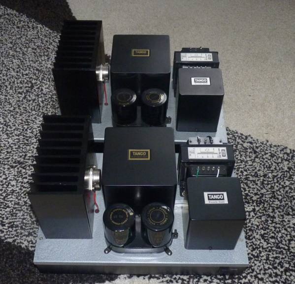

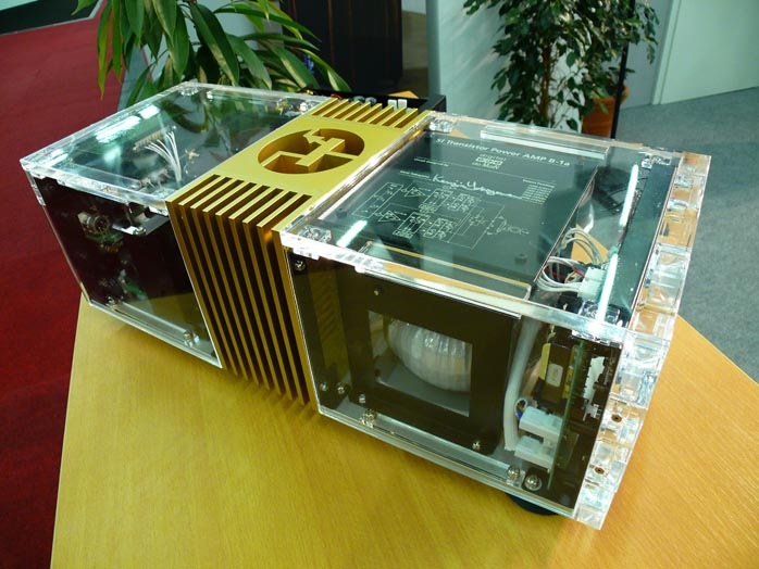

B1 Triode are for High-Fidelity application and potentialy i guess is excellent candidate for duo with 2SK77B and 2SK180 amplifiers ??

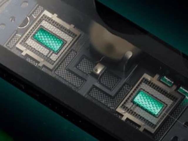

Mr Pass B1 Triode is made with Nutube from Korg and Noritake itron company's.
