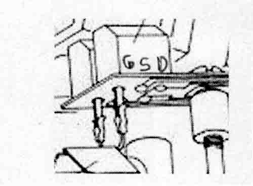

It's SGD, viewed from fet azz, trust me. (cross my heart and hope to die)
Hi Jacco
I zoomed your cartridge internal picture to see how the wires were connected.
I can clearly see that the fet are connected as source followers.
The pinout is GSD. Left pins of the fet goes to the electret needle

That would the first, even the oldest Toshiba JFETs in a metal can (e.g. SK11/2SK12) have the Gate inbetween the Drain and Source.
Other Japanese N-channels, K68, K150, K163, even uPA68h : DGS or SGD.
GSD is a common lead sequence for Japanese MOSFETs, e.g. K213-K216, K2013.
(an artist impression doesn't make it right)
Toshiba Gate diode for Mooly :clown: =>

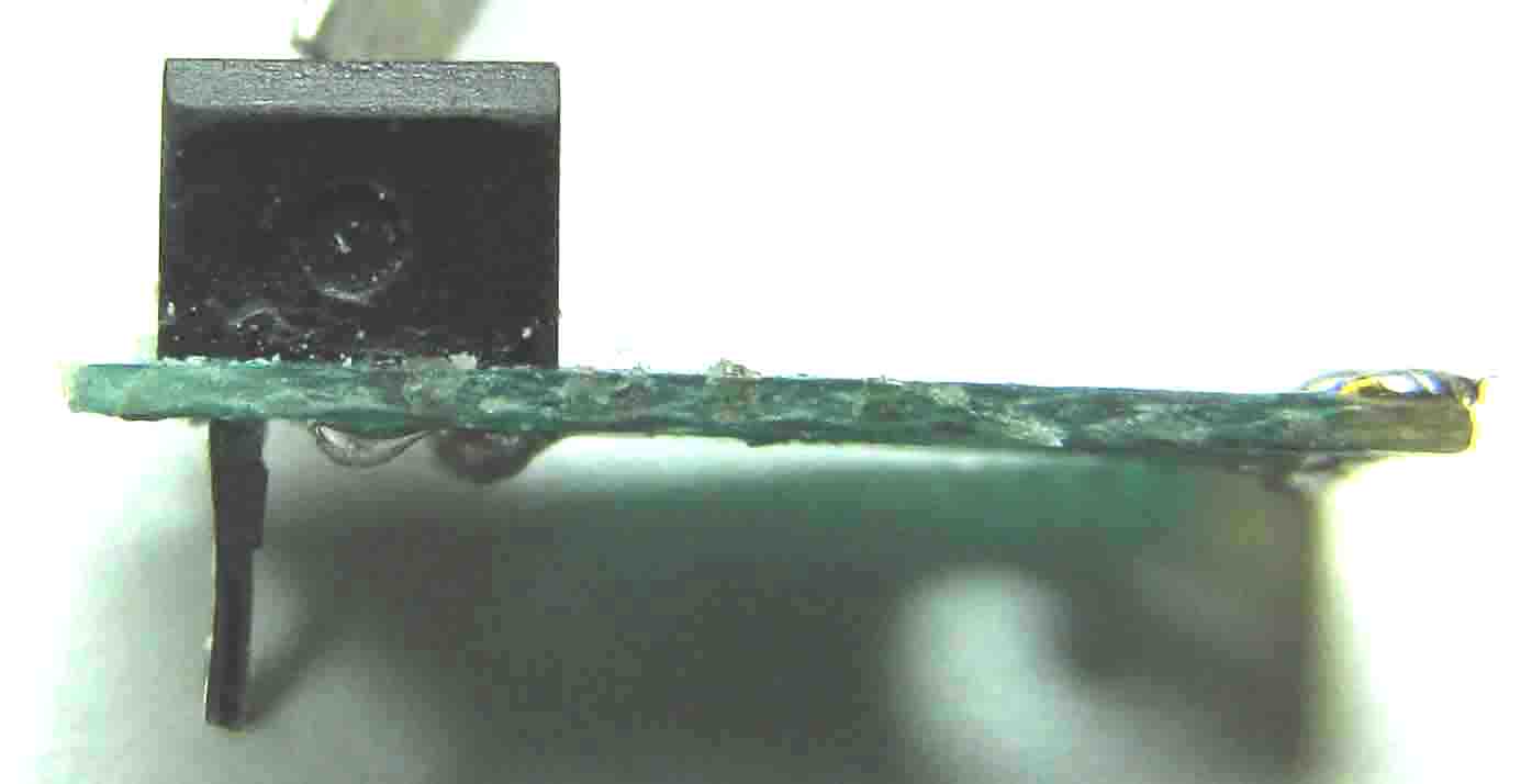

As I received my K118 today I looked at the CP-Y internals
I think I have a big problem, If I try to look at the resistance of the Needle (electret) R and L to the needle casing, One side (signal) R or L of the electret to the needle casing don't show any resistance. The other side is showing 6 ohms

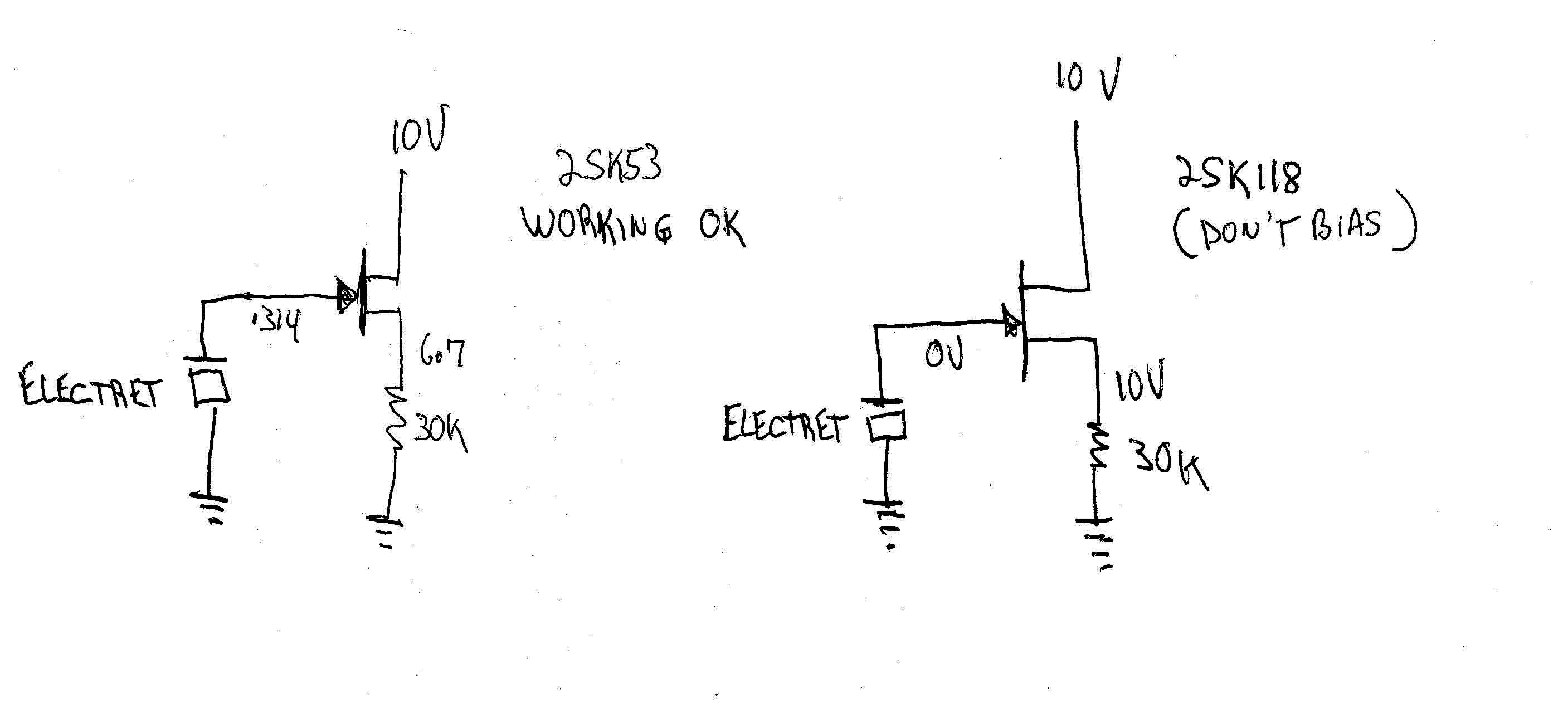

Before receiving me new stylus, I want to make the cartridge alive again so I made tests to find a 2SK53 fet replacement for the bad one.
Here is what I got with values reading with the 2SK53 FET
I tried the 2SK118 and it didn't work at all. It didn't bias.
1- Do I have to choose another FET than the K118 ? If yes, what could I use?
2- Changing the source resistor with a lower one ?
3- Biasing the K118 with a resistor from S to G ?
4- Make the K118 in amplification mode instead of source follower ?
Any recommendation is welcome
Thanks a lot

I have some trepepidation about making suggestions without being able to physically see what's up. I have problems with the numbers on that picture, where does the voltage come from on the gate and since this is an ultrahigh impedance circuit how is it measured. The source to gate voltage in both cases is more than enough to pinch off either FET yet the 2SK118 is a short (?).
I think your meter is causing false readings. First try a 2.2k on the 2SK118 rather than 30K, I still can't find any info on the 2SK53 and it might have been an ultra low Idss FET (6.7V/30k =~ 225uA). This would be way down on the tail of the 2SK118's distribution. The source follower should bias up at ~Idss in this configuration. If this works you would need to replace both sides.

I'll try 2.2K at the source instead of the 30K
In many K118 circuits, I see a 1G resistor from S to G to bias the K118

It should work without the 1G resistor, the 2SK53 does. You will have to buy chip versions to fit them in. The cheap Chinese mics use 0805's where someone soldered little leads on them and dipped them in epoxy. I have no source for the tiny 1/8W ones that you get when opening vintage Nakamichi mics. Most leaded ones available are huge.
