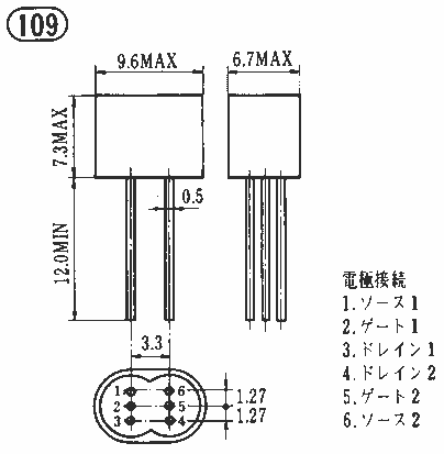

can you describe the package more?
are these two seperate plastic to-92 package (or maybe a little bit taller than t0-92 package) devices wrapped togther in a piece of tin?
if so they might be same pinout as 2sk146/2sj73.

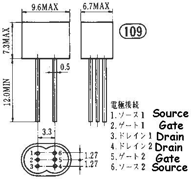

actually the answer is in your picture. it's been so long i forgot the japanese symbols for gate, drain and source. just find a japanese version of a known jfet datasheet and match the symbols

The 2sk129 Nchan JFET used to be rather common although nowadays it can not be found unless on E-bay...I believe the pinout is DGS, although it could be SGD...(D and S are interchangeable) most audio equip. of that age switched to upa68h instead of 2 2sk129s the pinout of that SIP is...D G S nc S G D...
hope that helps,

my 1997 toshiba fet book (which does list other mfg numbers, but not NEC or hitachi) skips from 2SK125 to 2SK133. 2SK109 however shows as:
50V 10mA .15W/ch gm=10mS
pinout:
1 drain1
2 gate1
3 source1
4 nc
5 source2
6 gate2
7 drain2
the same pinout seems to apply to all dual fets in the SIP package
(it's difficult to be absolutely sure of this, since i don't read japanese, but the japanese lettering is in the same order on all the SIP drawings in this book, and i verified the lettering against a drawing of a to-3p fet with japanese and english lettering together)
