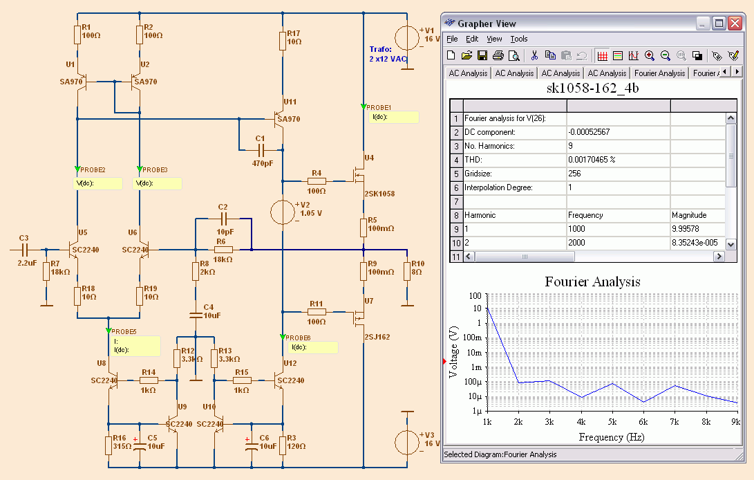

... wth 100pF compensation

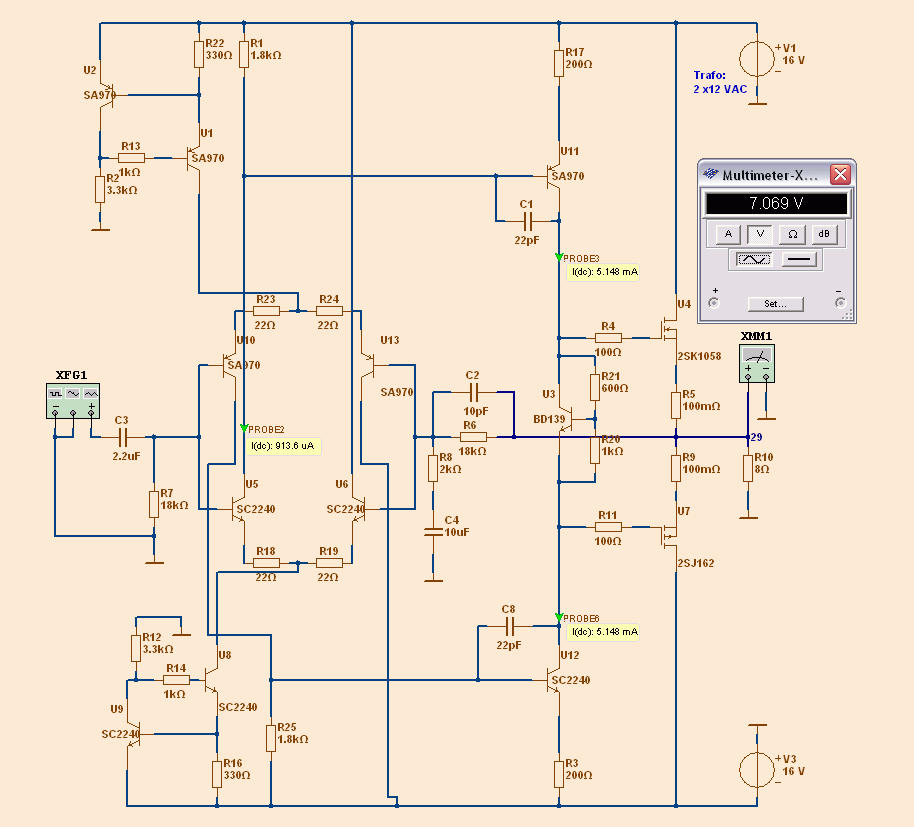

Very good 2SK1058/2SJ162
this is
- 2x12 vac transformer
- 2SK1058 complementary 2SJ162
- Symmetrical in, vas and output
- 8-10Watt MOSFET output
low distorttion, 100pF compensation
modrerate heatsnk requering
image shows currents and output at 8 WAtt (2x11.3 Vpeak)
I guess you know howto make two CCS (see prev images)
You wont be Sorry
Enjoy!
