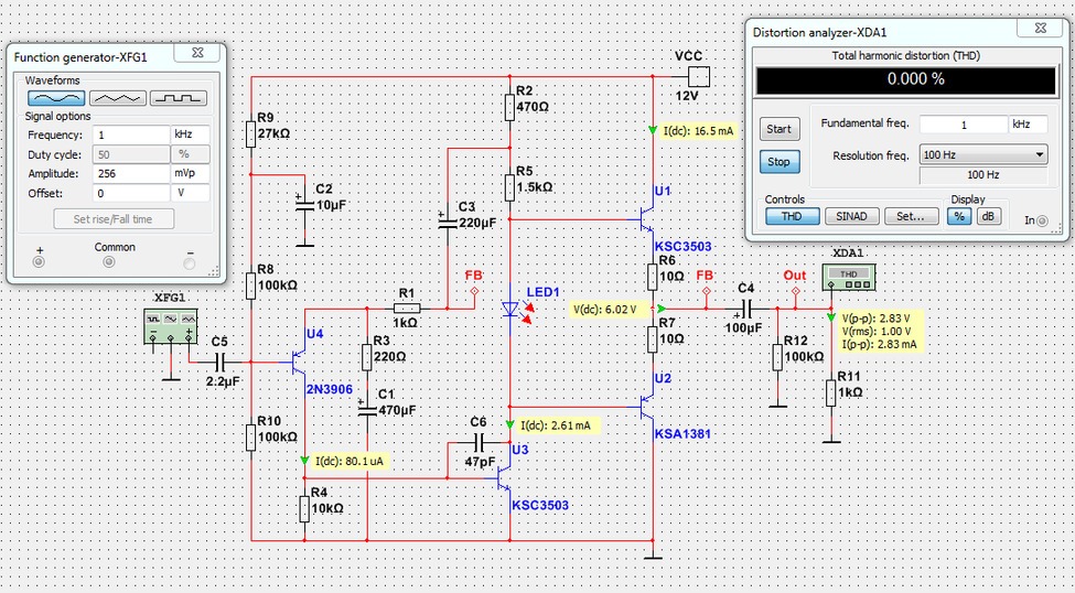

2N3906 Line Preamp. Gain=5.5. Simple but Low Dist.
Bandwidth: >1 MHz
VGain: 5.5
Can drive 1 kOhm.
Enjoy building this little amplifier!
You will not be disappointed.
If somebody would improve this amp, you are welcome :)
