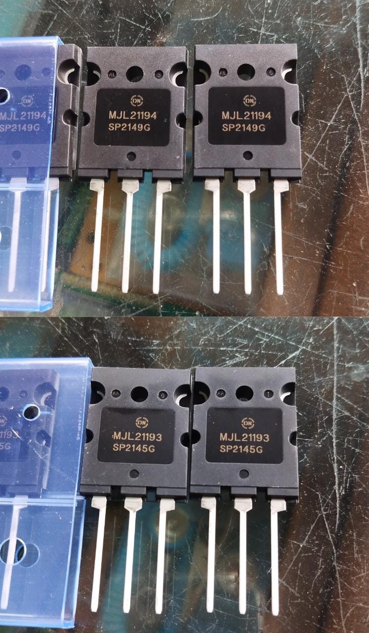

Mouser is fine, they are an authorized distributor.

Well, you need the metal tab to collect and transfer the heat from the die into whatever heat radiating system they come up with. For higher power, you absolutely do need that metal tab. The case is composite and they have the metal down to a minimum. I guess they'll have to come up with another way of transferring heat from the die to the air before they can lose the metal part.

About NTE. You never knew what the real part was as they used a few numbers for each of their numbers. Forget matching them as well. ECG was worse, but they used the same (book of lies) cross reference manual labelled NTE. Complete with intentional errors ECG put in theirs. From measurements, I can tell you these were not first rate parts as the parameters were all over the place. The old RCA parts were good, but again you never knew what the source part actually was. All of this was aimed at the TV repair industry, not the audio market. TV repair folks were typically poorly educated in parts, and things like matching and even bias current! A very lax industry was TV repair in general. I will have to say I knew some excellent, well educated TV repair professionals.
Anyway, NTE / ECG parts are not reliable on average compared to the real parts. The only worse ones are re-marks, now found on Ebay mostly. Ali sells a lot of "new manufacture", but those are fakes by definition. One thing for certain, you cannot trust any part unless it comes direct from an authorized distributor.
My name goes on everything I design, certify, test or repair. I will not risk my name on parts aI can't be sure are the real thing. It's bad enough that real parts occasionally fail, and the design you're working on may not be done well. Why ask for trouble?
